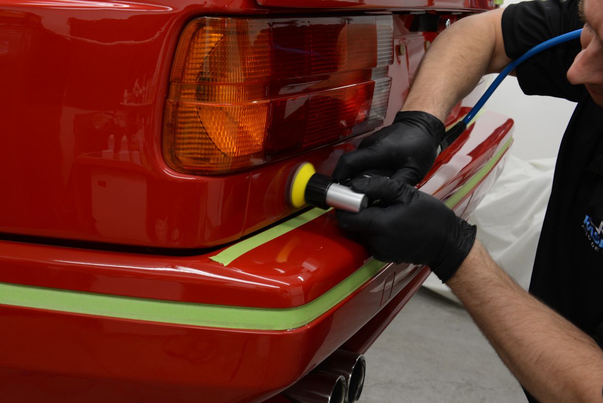

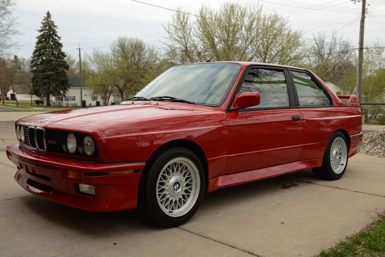

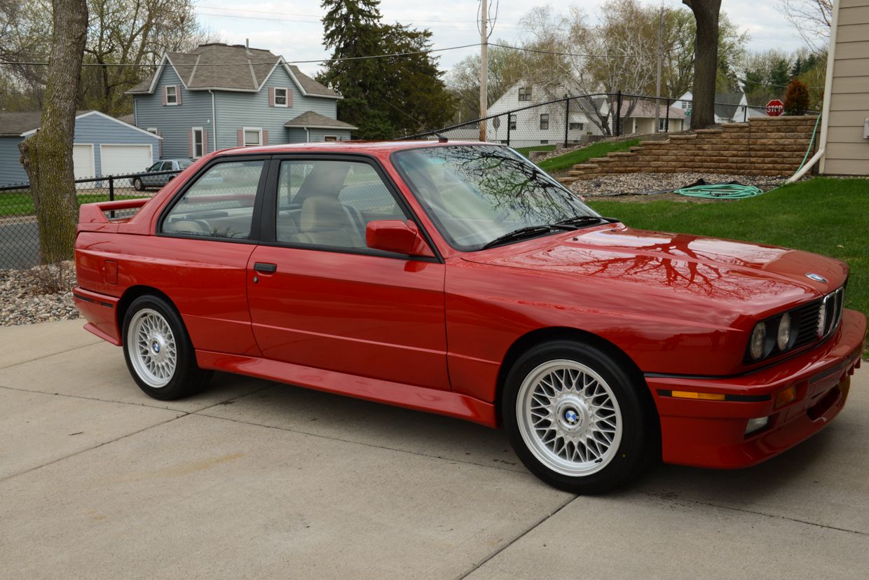

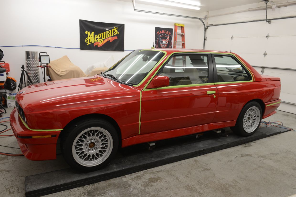

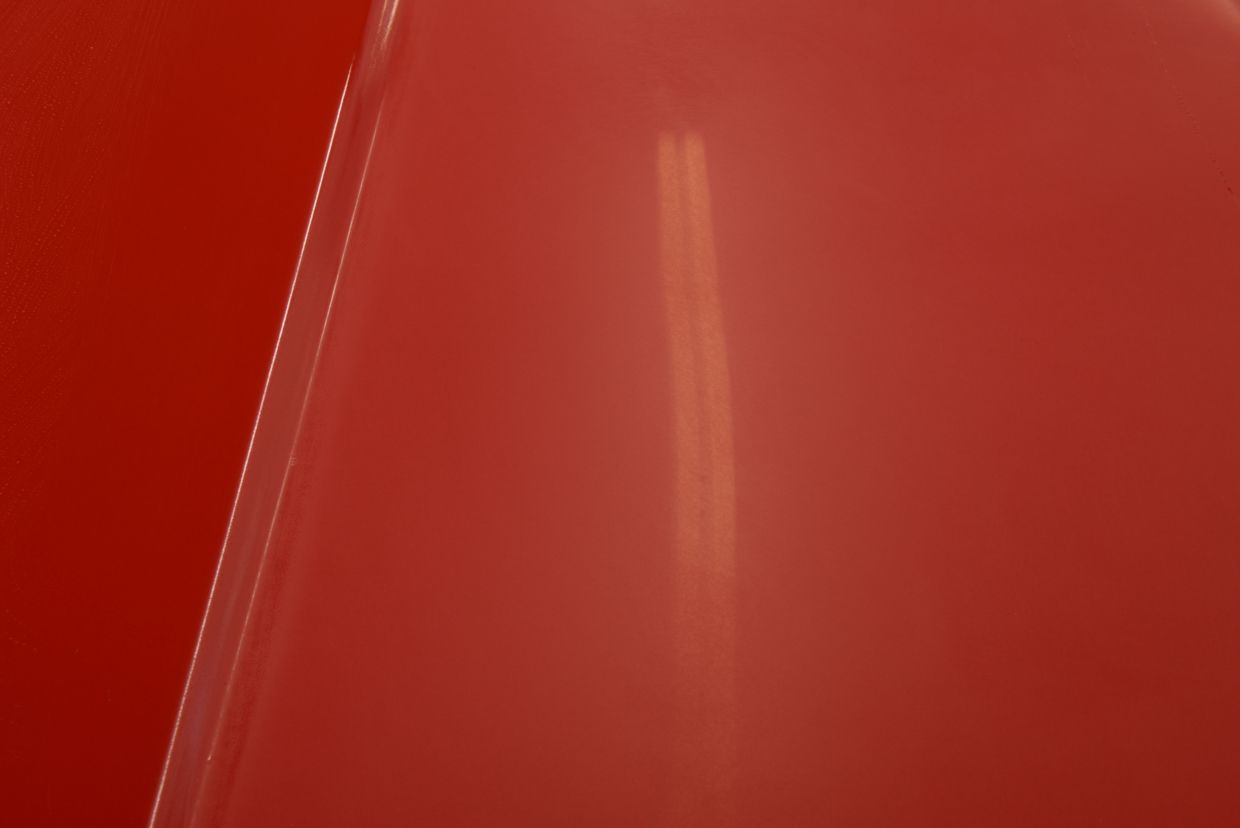

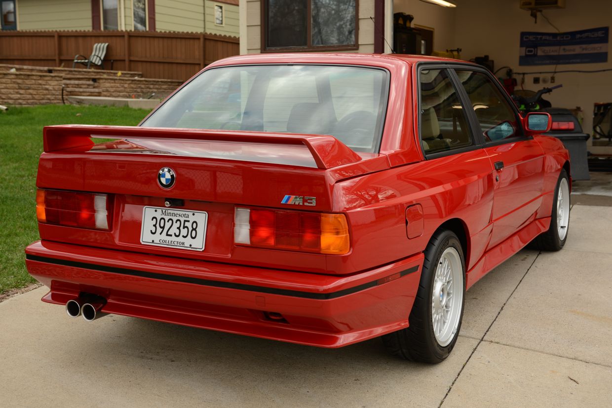

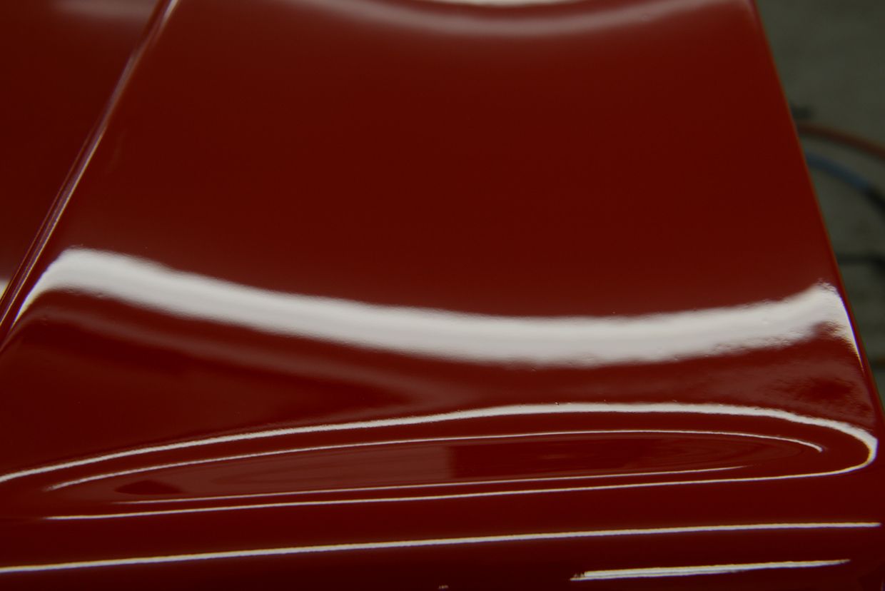

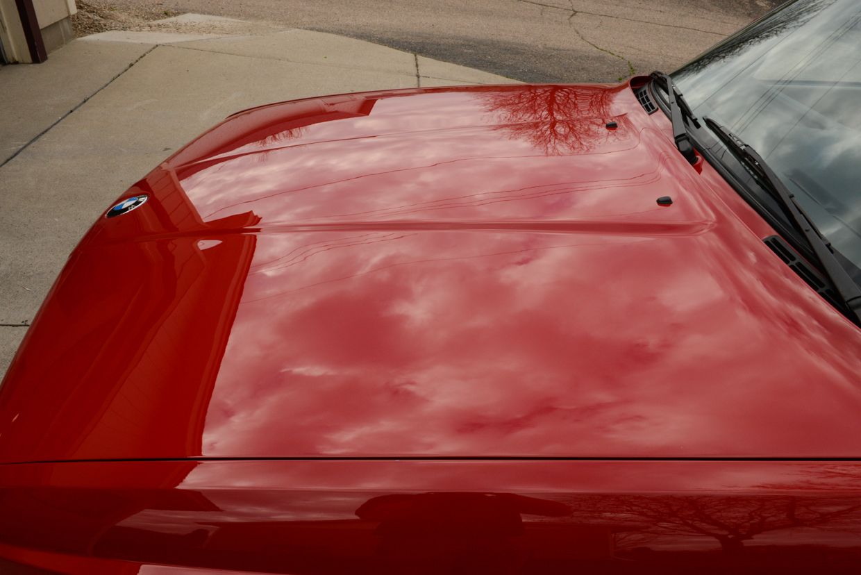

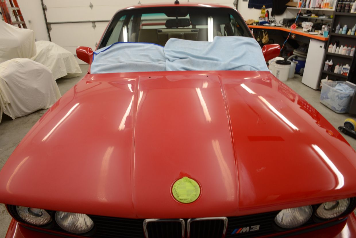

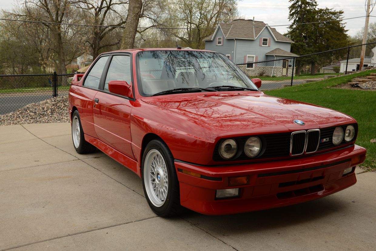

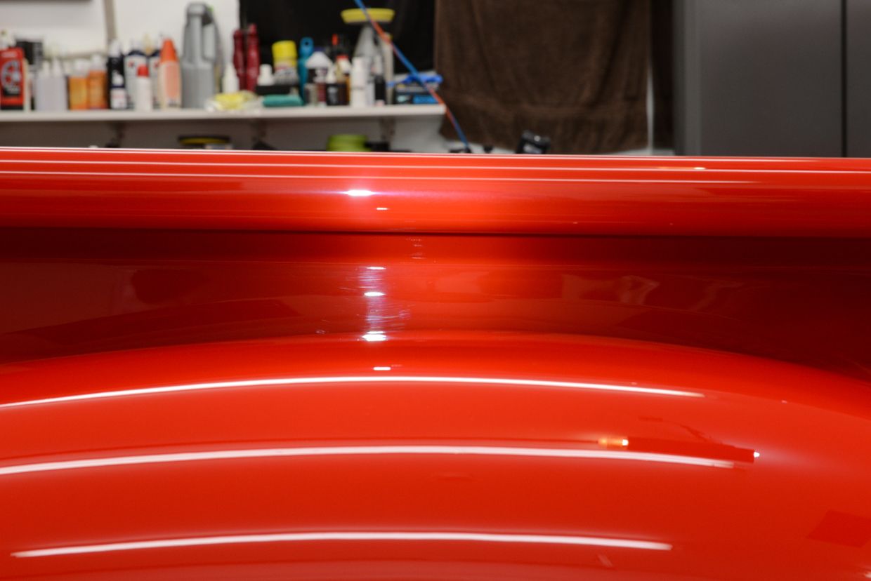

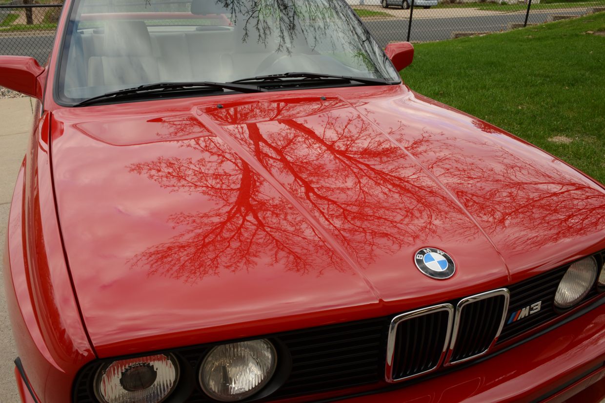

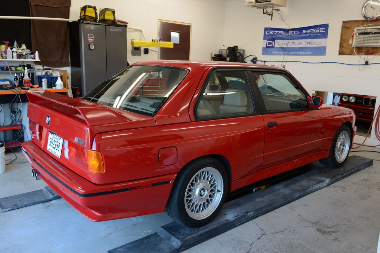

E30 M3, Multi-Step Correction and Partial Wet Sanding
The owner of this fine example of German Engineering recently purchased the car and wanted me to do what I could to get the paint looking its best within his budget. Upon inspection it was evident that it had been repainted some time ago and that there was some excessive shrink on the top panels and a few other paint issues that needed to be addressed.

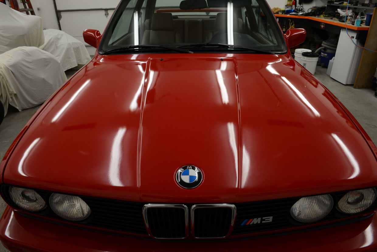

Car as it arrived (nice and clean) :)

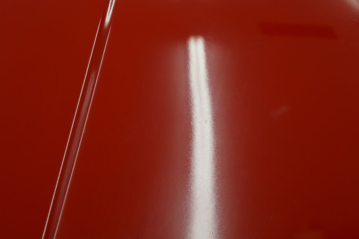

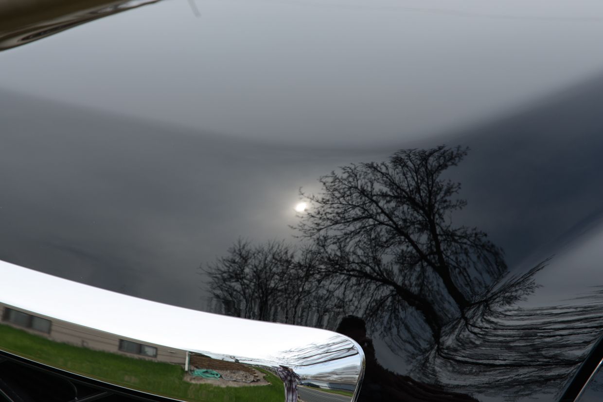

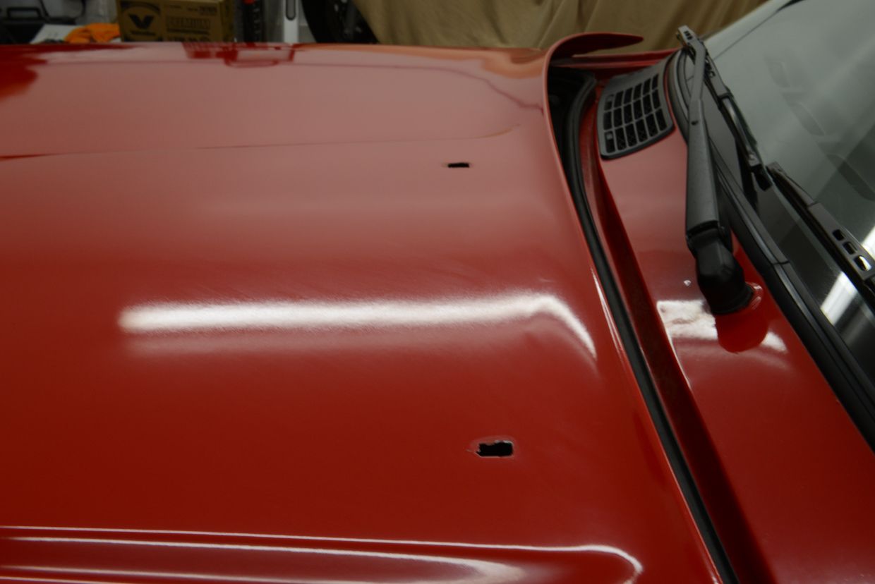

Shrink on the hood can be seen from the lack of gloss and distorted reflection
Washer nozzles removed for sanding and polishing
Close up of shrink
Sanded with 1500/3000 grit Meguiar’s sanding discs (hand and DA)
After compounding with the Rupes LHR21 and KBM205 method

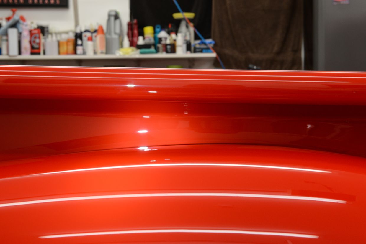

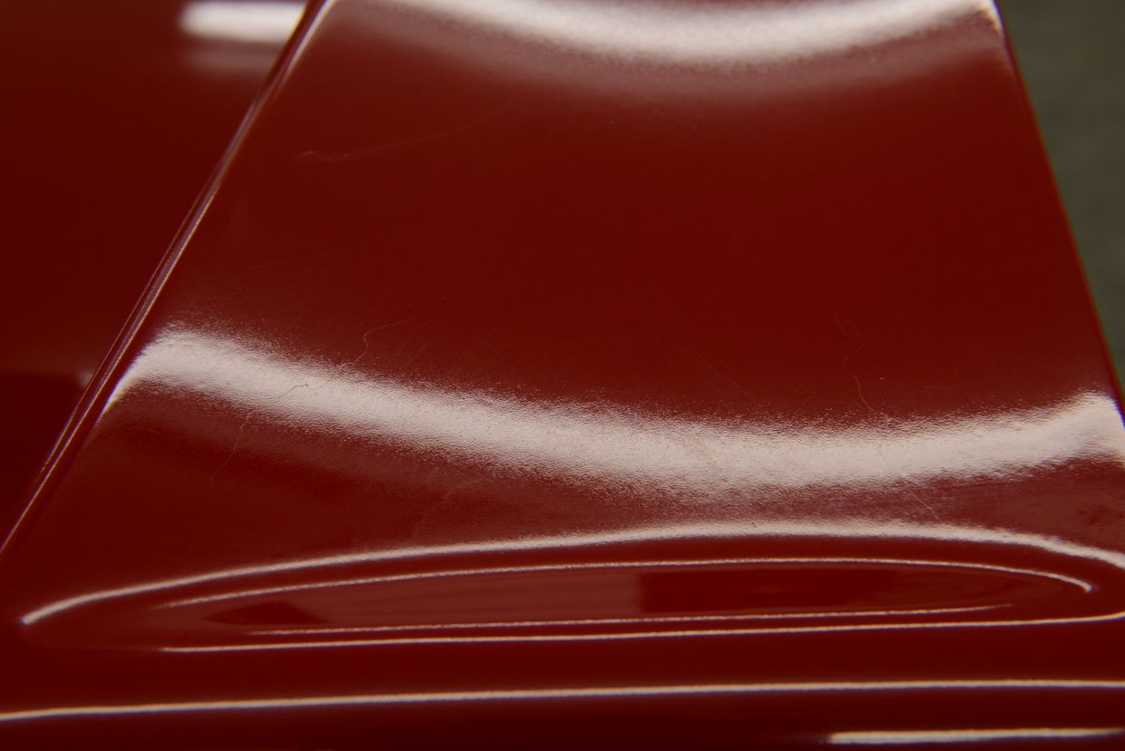

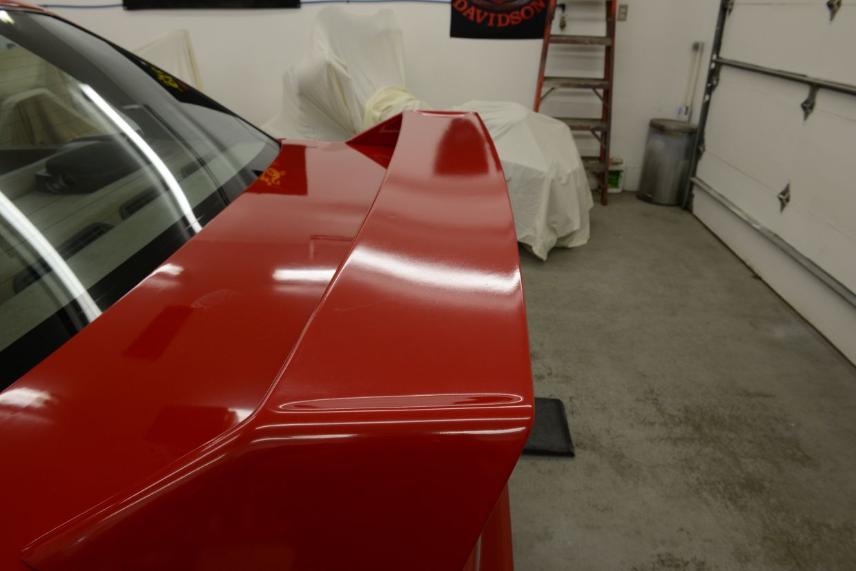

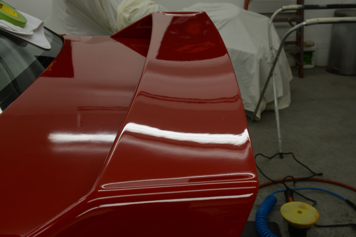

Close up of shrink on the spoiler
At a distance

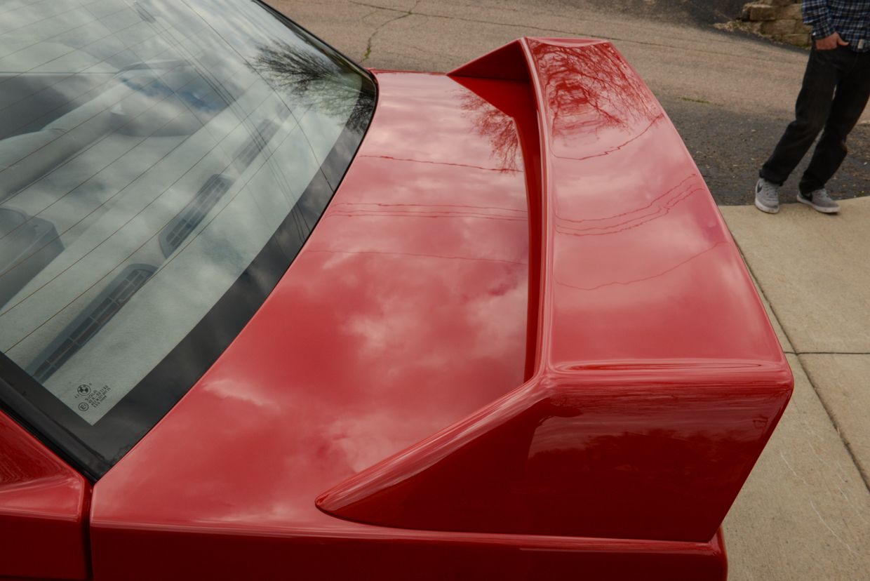

Close up of spoiler after sanding and compounding

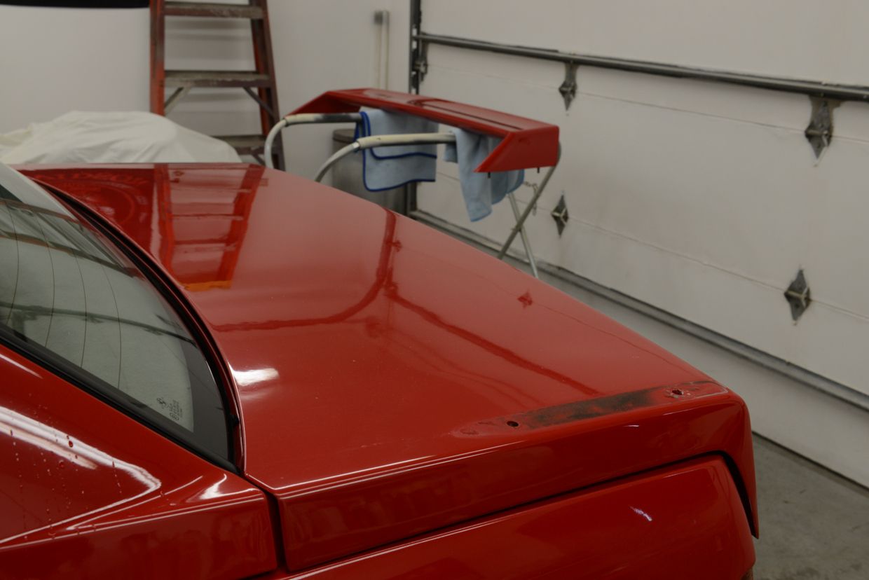

At a distance…notice the difference between the spoiler and the trunk
Spoiler removed

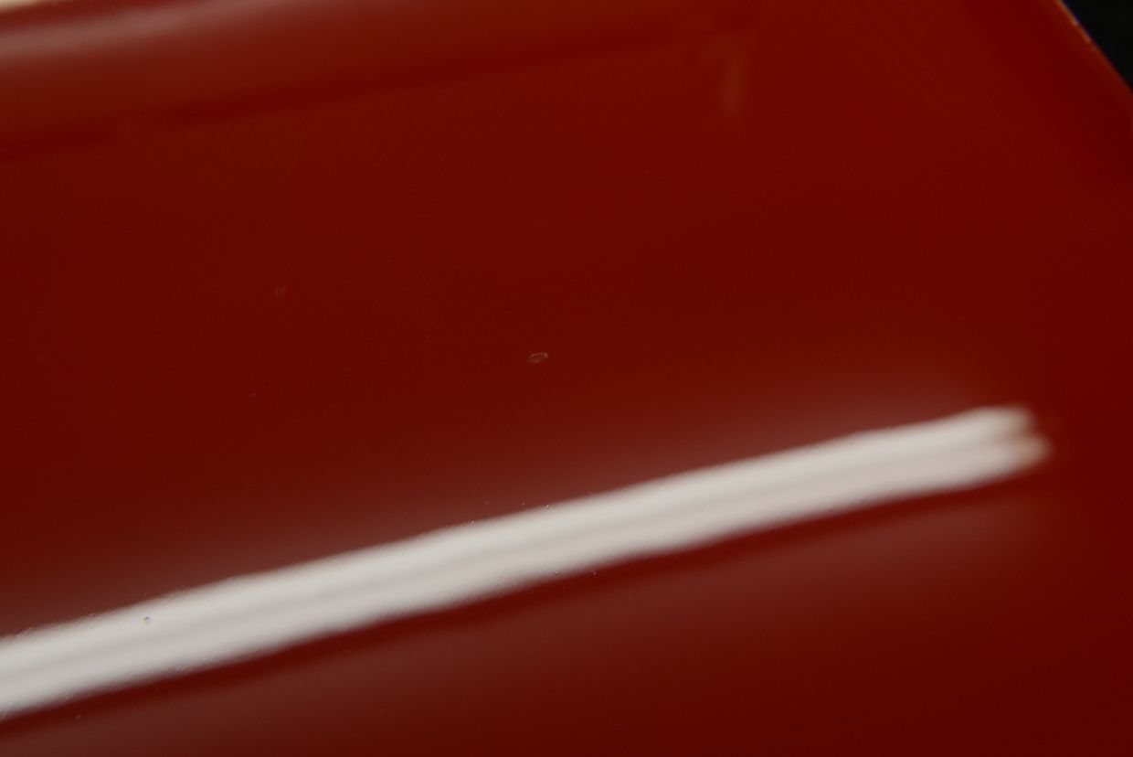

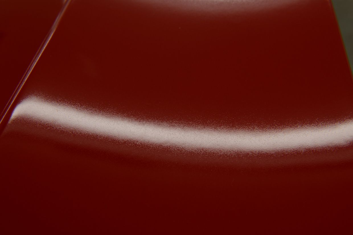

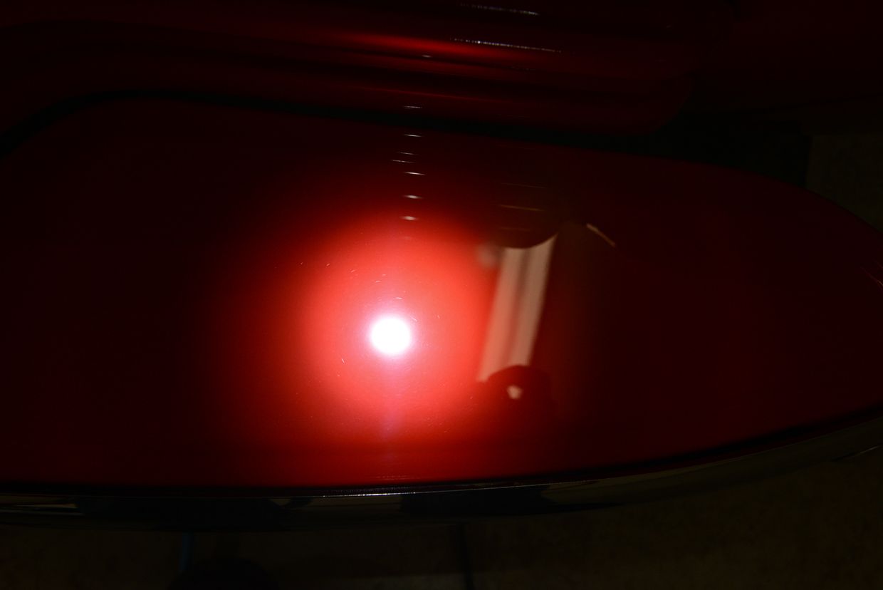

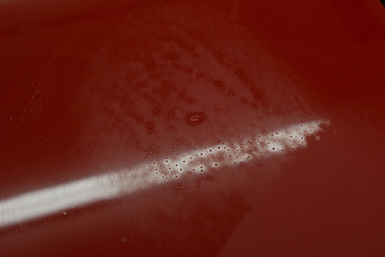

A few areas on the car had these “goose bump” protruding from the paint. I’m not 100% certain what causes this but I’ve seen it before on repaints. Its likely solvents or moisture trapped under the paint, possibly in the primer or base coat, which are trying to escape. I don’t suggesting trying to sand these defects out, for obvious reasons, but it looked bad and I decided to test out sanding in a discrete area, which turned out great. It’s not 100%, but a huge improvement. I lightly sanded them here so they were easier to see. The touched up chip can be used as a reference point.
After

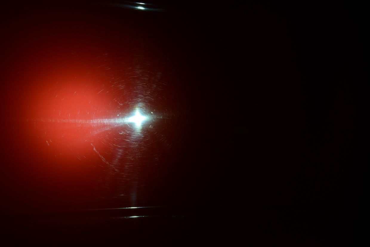

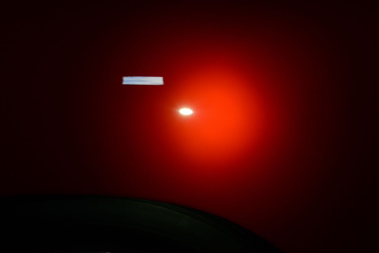

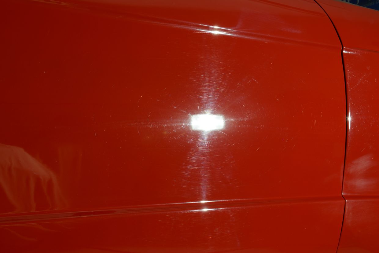

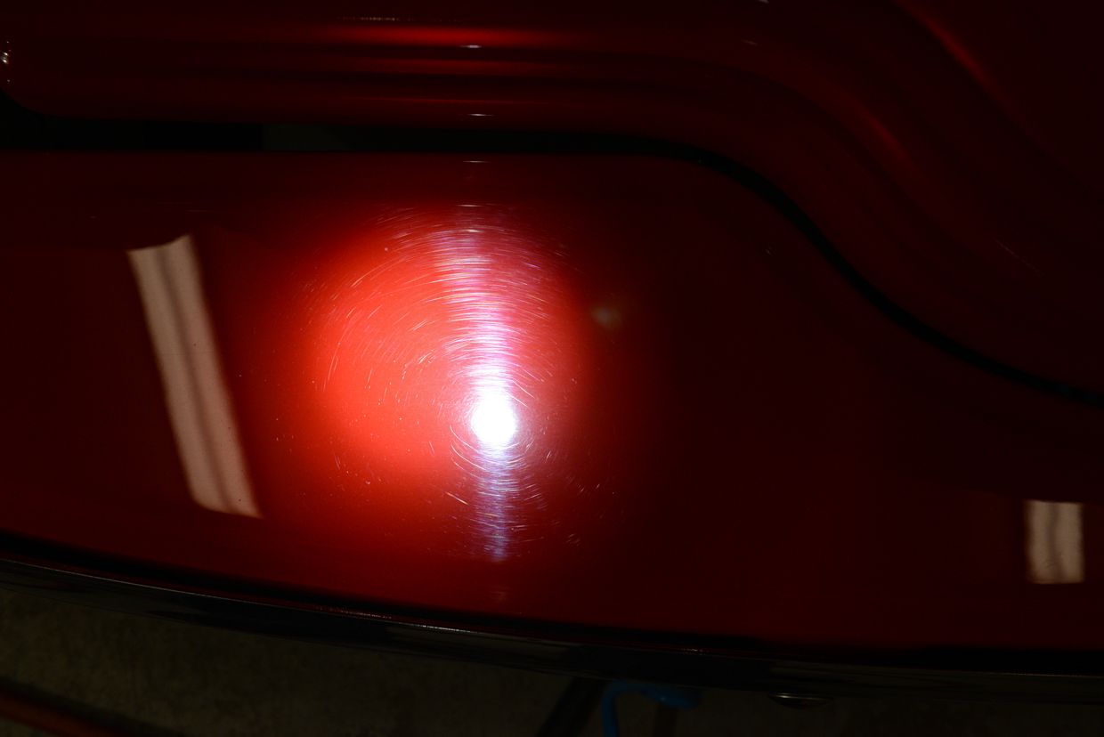

Swirls and RIDS throughout
50/50 shot
I spent about 10-12hrs carefully wet sanding and compounding….
An example of when the rotary is the better tool for the job.
Great example of where the Rupes TA50 and 2” pads shine

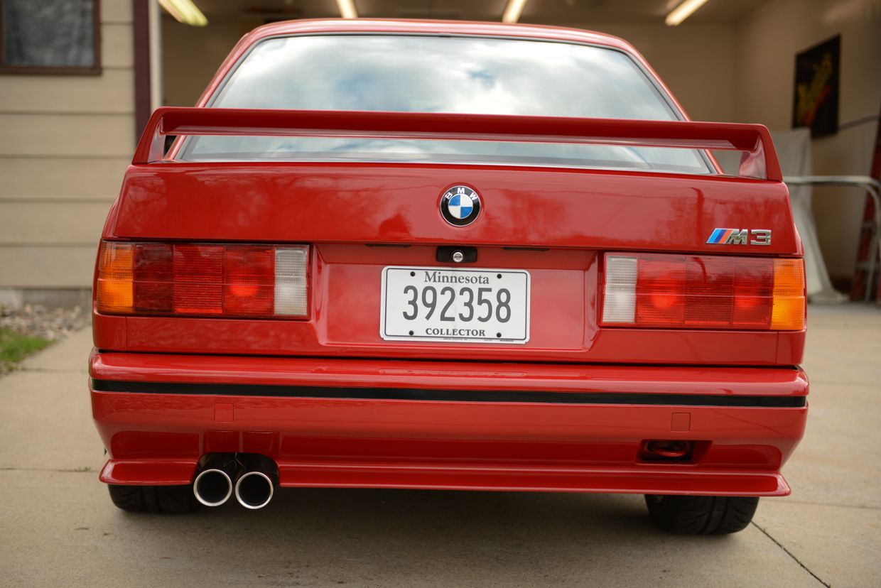

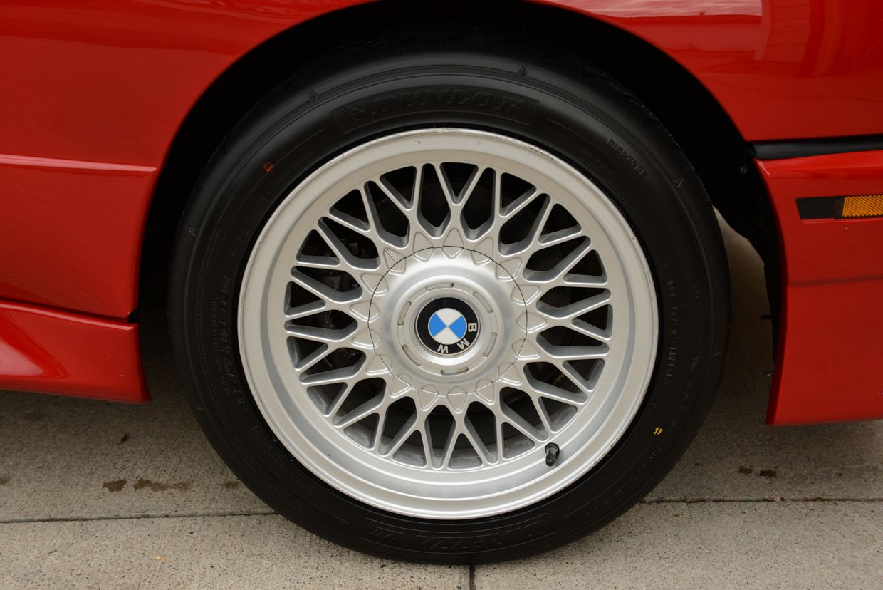

Finished shot prior to LSP….two different aperture settings
I like this one :)

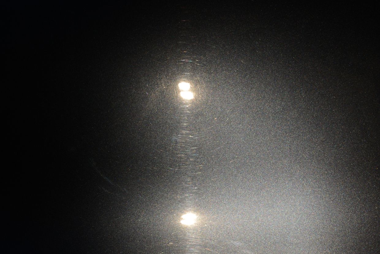

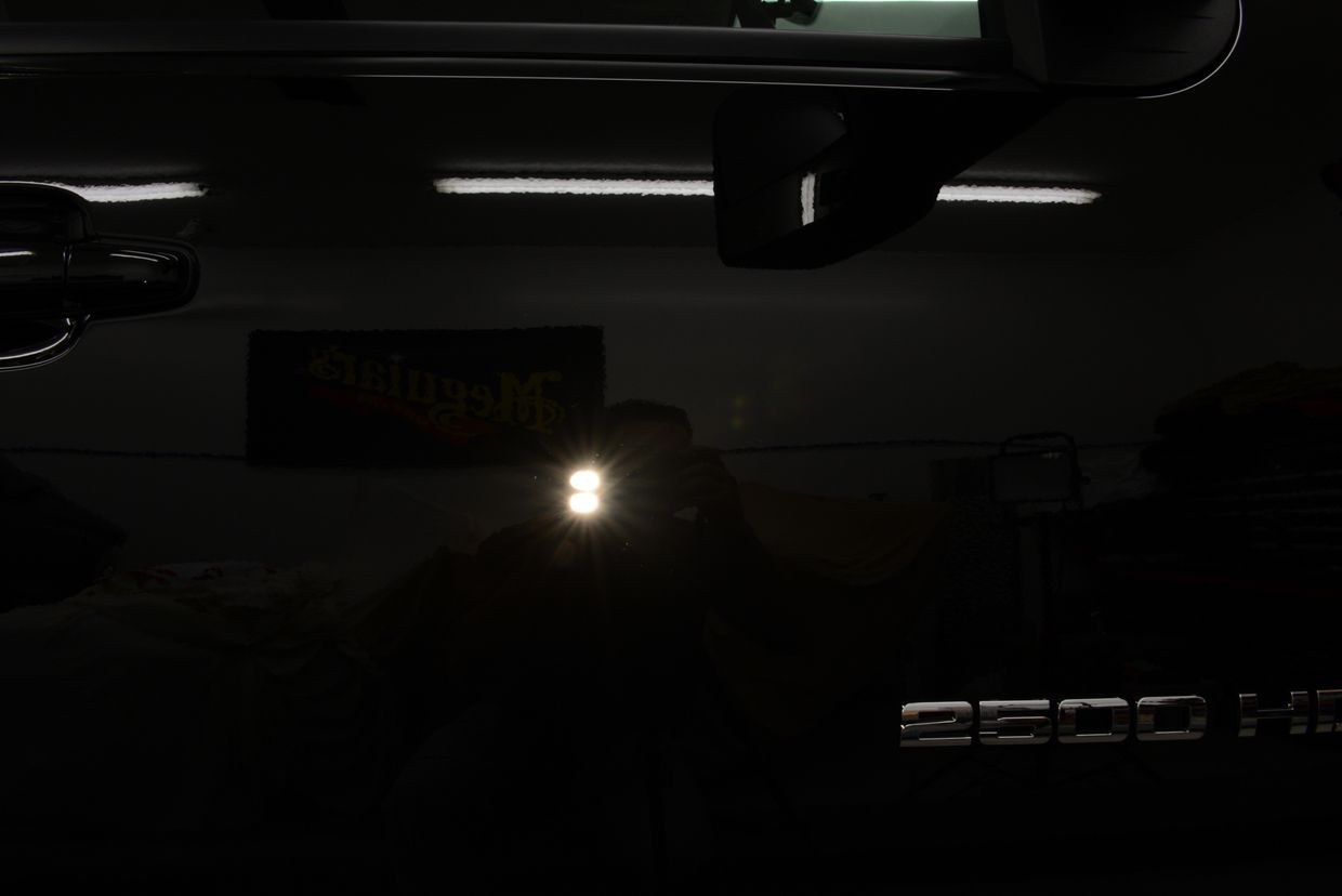

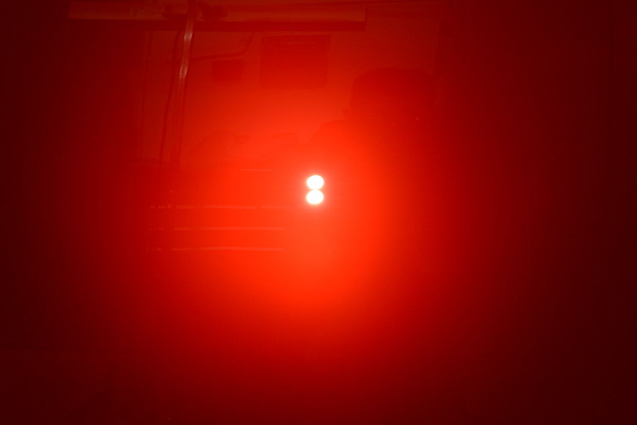

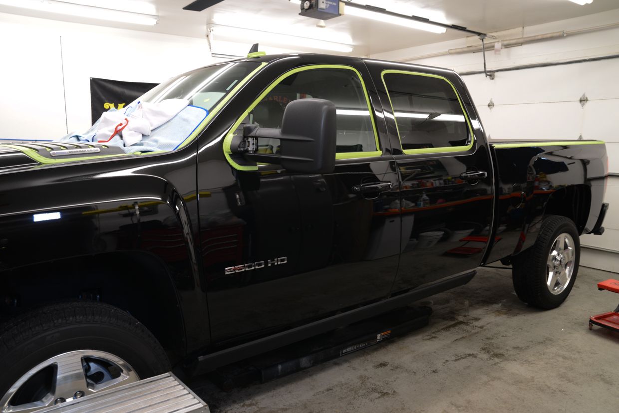

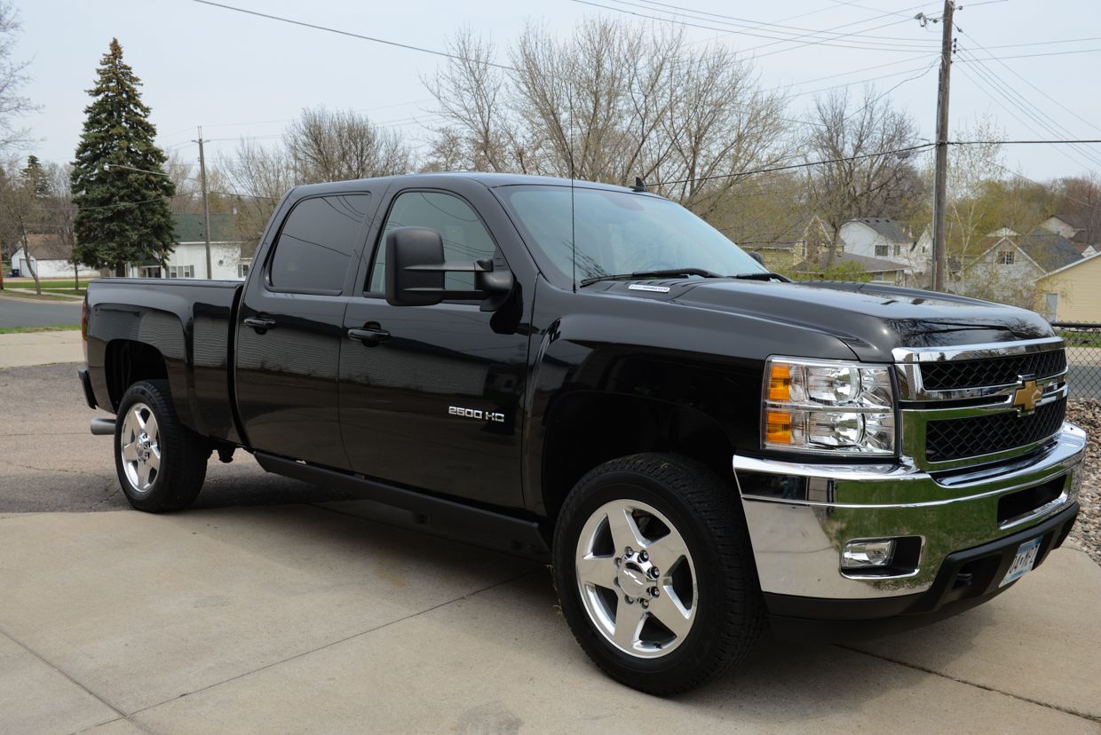

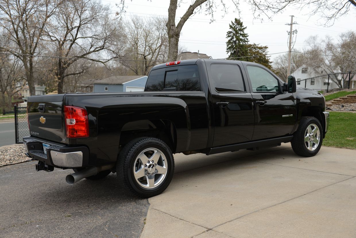

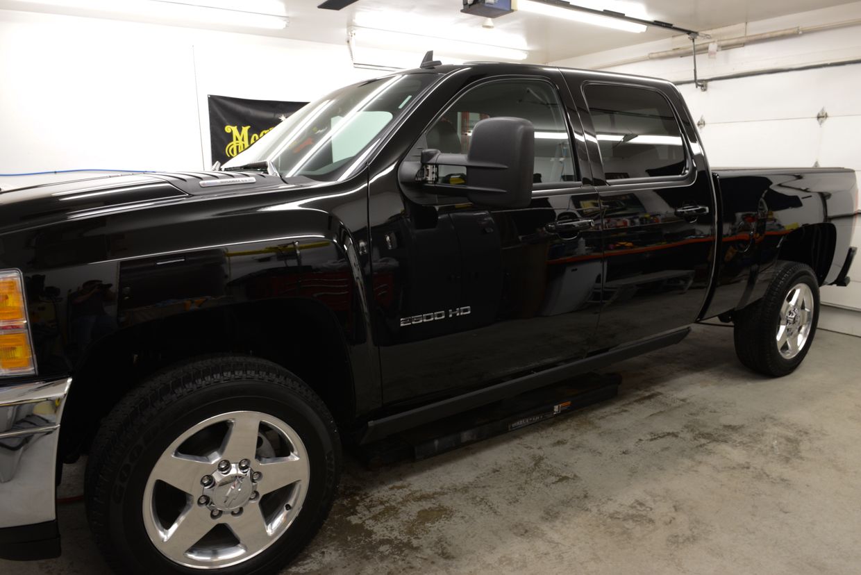

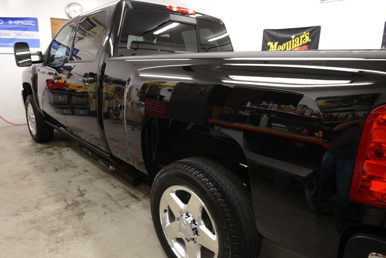

‘14 Chevy 2500 HD, Multi-Step Correction and Opti-Coat Pro application

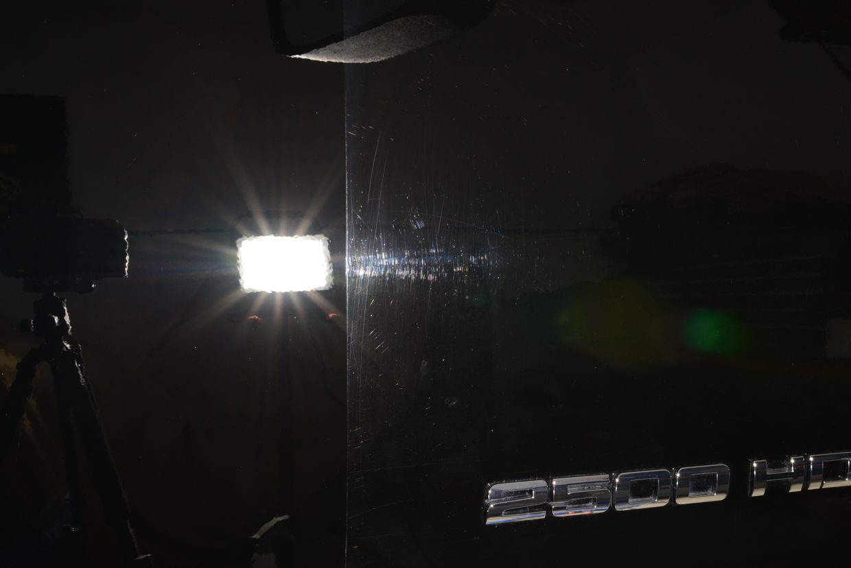

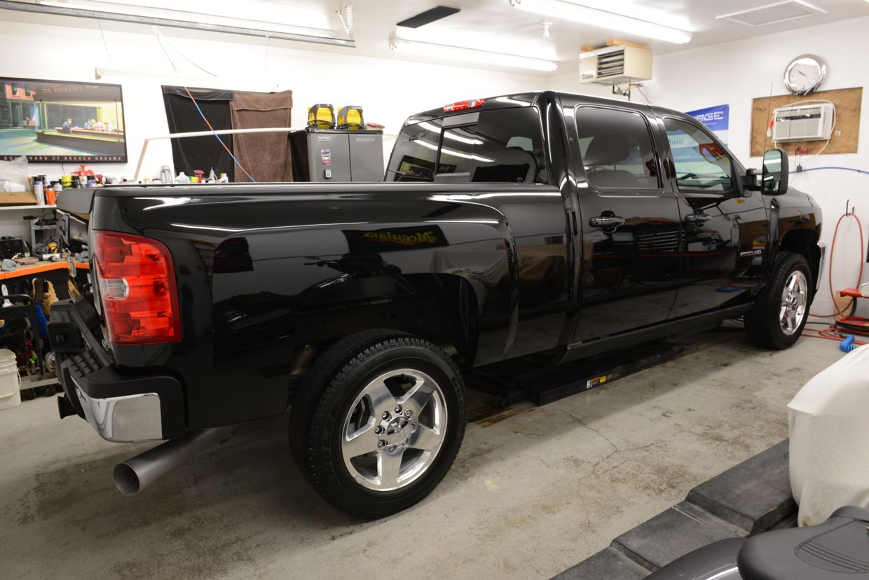

Good client of mine picked this up last winter to haul cars around and he wanted to get it looking right and have some long term protection applied. This was a LOT of surface area to cover and a reminder of why I dislike doing trucks, especially black ones with finicky paint!

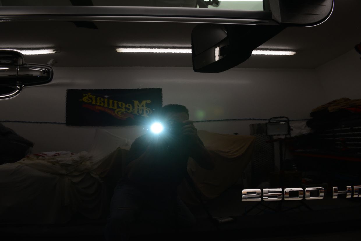

Before condition

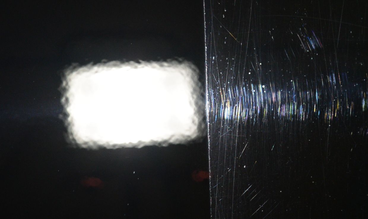

Left over DA sanding marks and pig tails from a hood repaint…typical body shop.

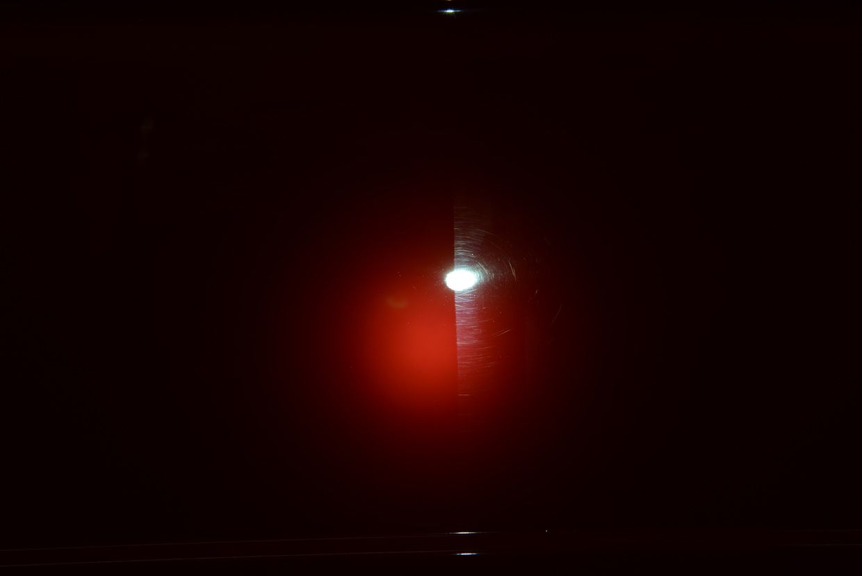

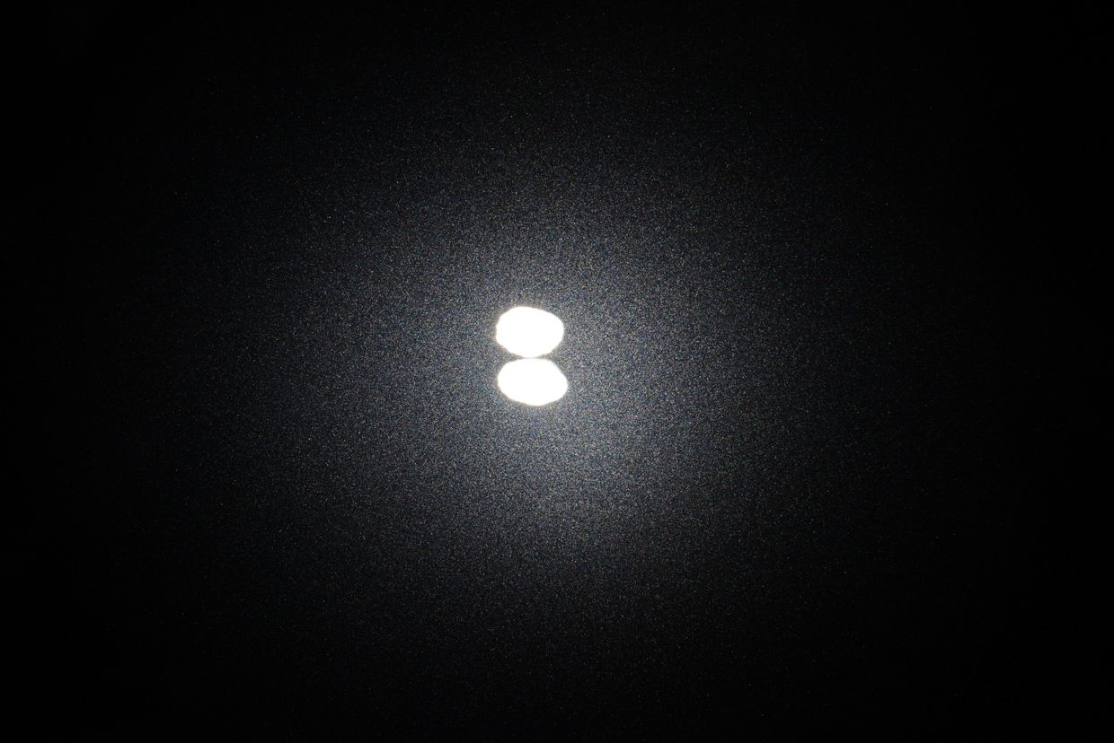

50/50 LED
Brinkmann

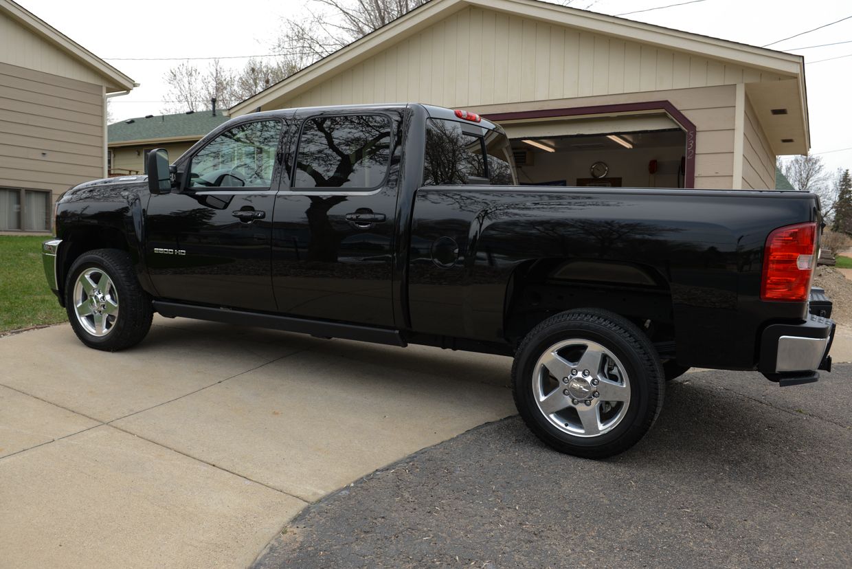

All done

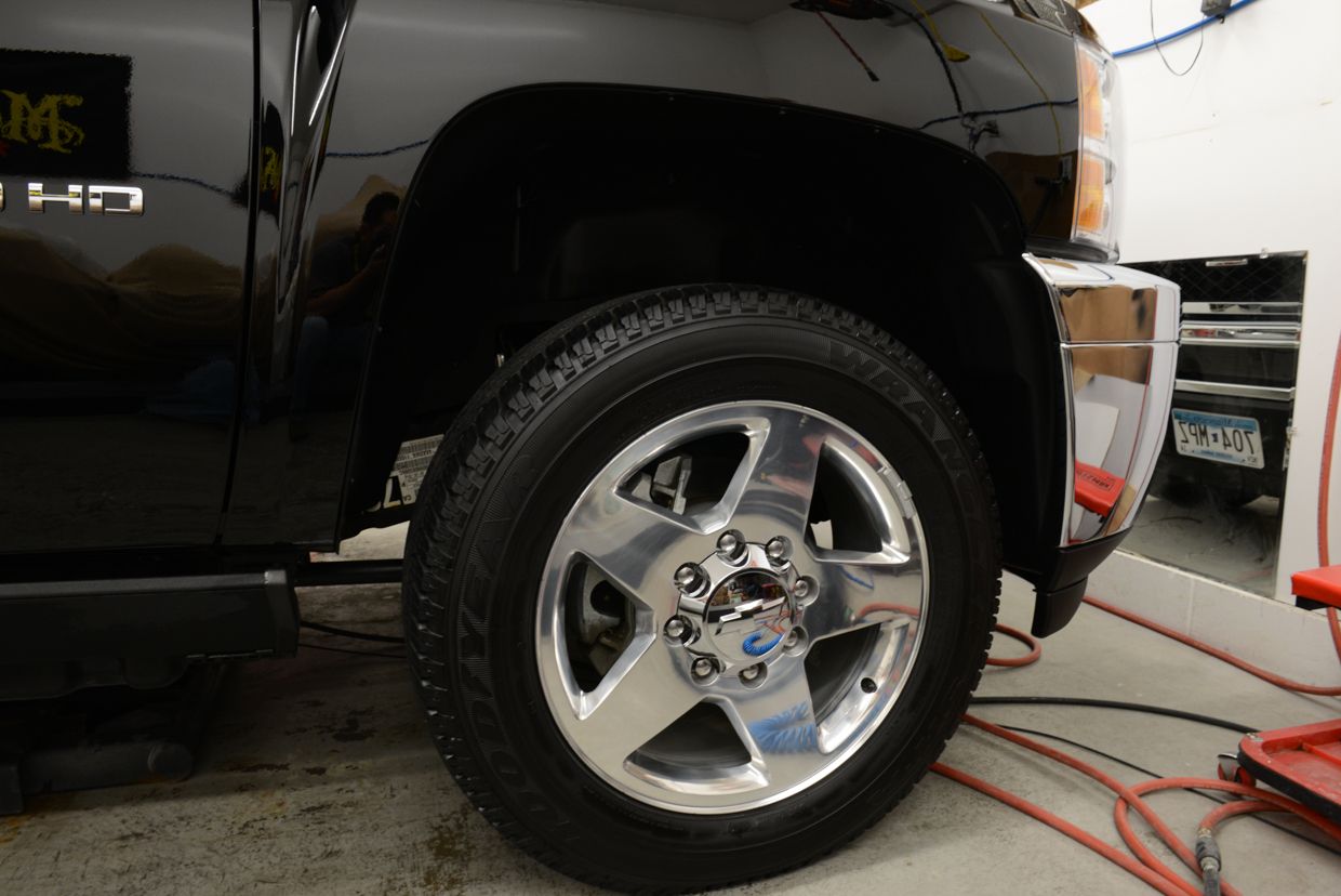

Wheels were polished with Opt Primer Polish and then coated with OCP
We’ve had a terrible spring so far and I was really hoping for sun on this one, but it was too cloudy yet again. :(
Trying to pop through the clouds…
Thanks for looking,
Rasky

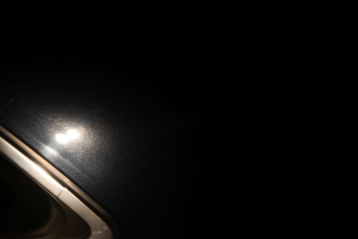

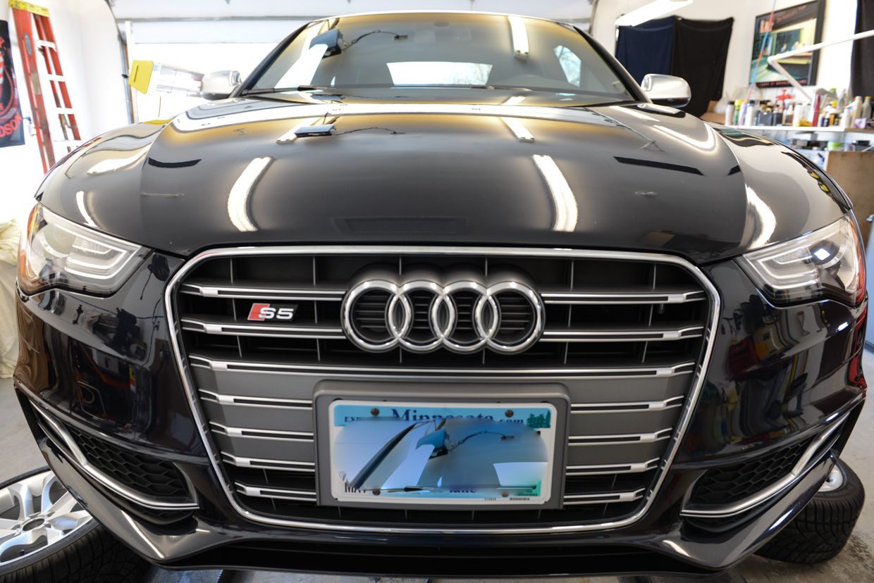

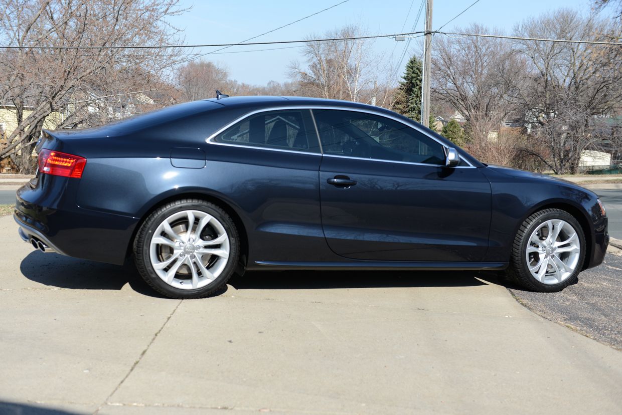

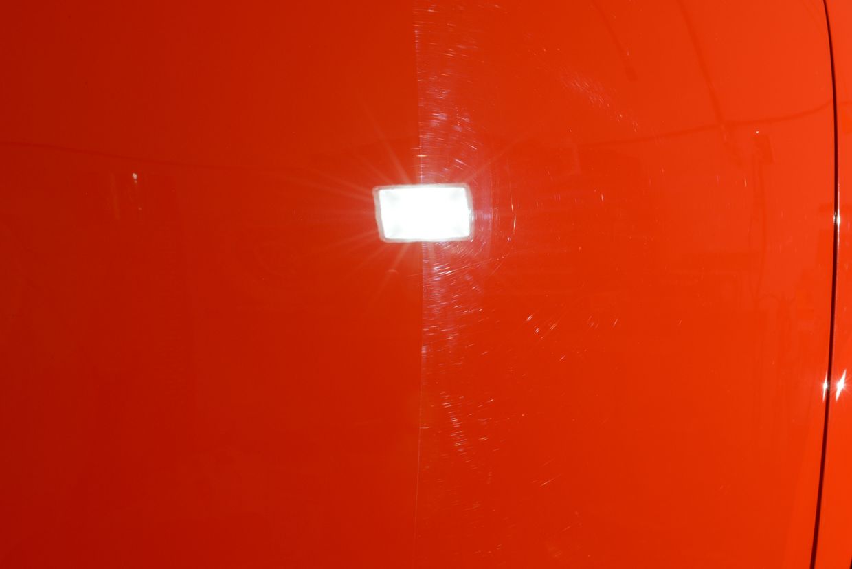

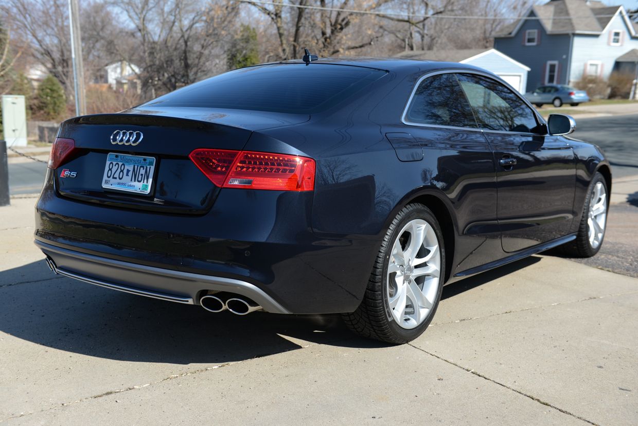

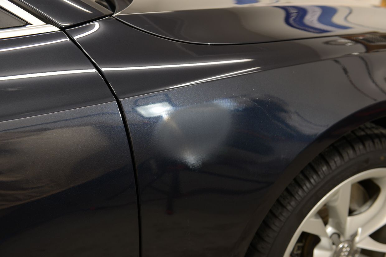

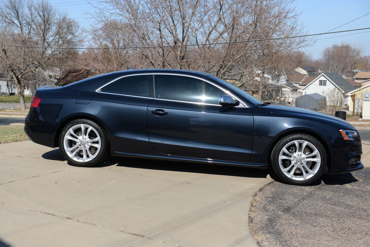

2013 S5, Paint correction and CQuartz Finest Application
This car was a recent CPO purchase by a very good client of mine and they wanted to get it all cleaned up and protected. His previous vehicle had all been Opti-Coated but he had been seeing my post and CQF and wanted to give that I try this time around. ;)
Before

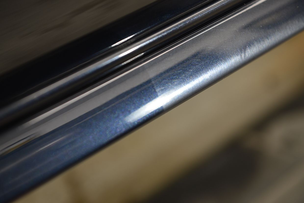

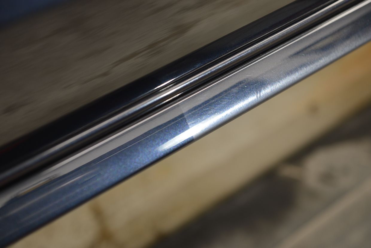

Removed ugly V6T badges from fenders….impressions in paint required a light wet sanding to remove.

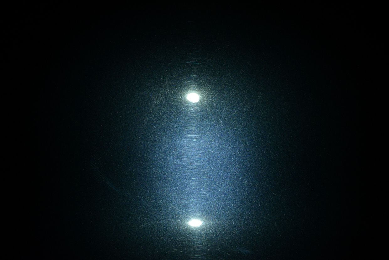

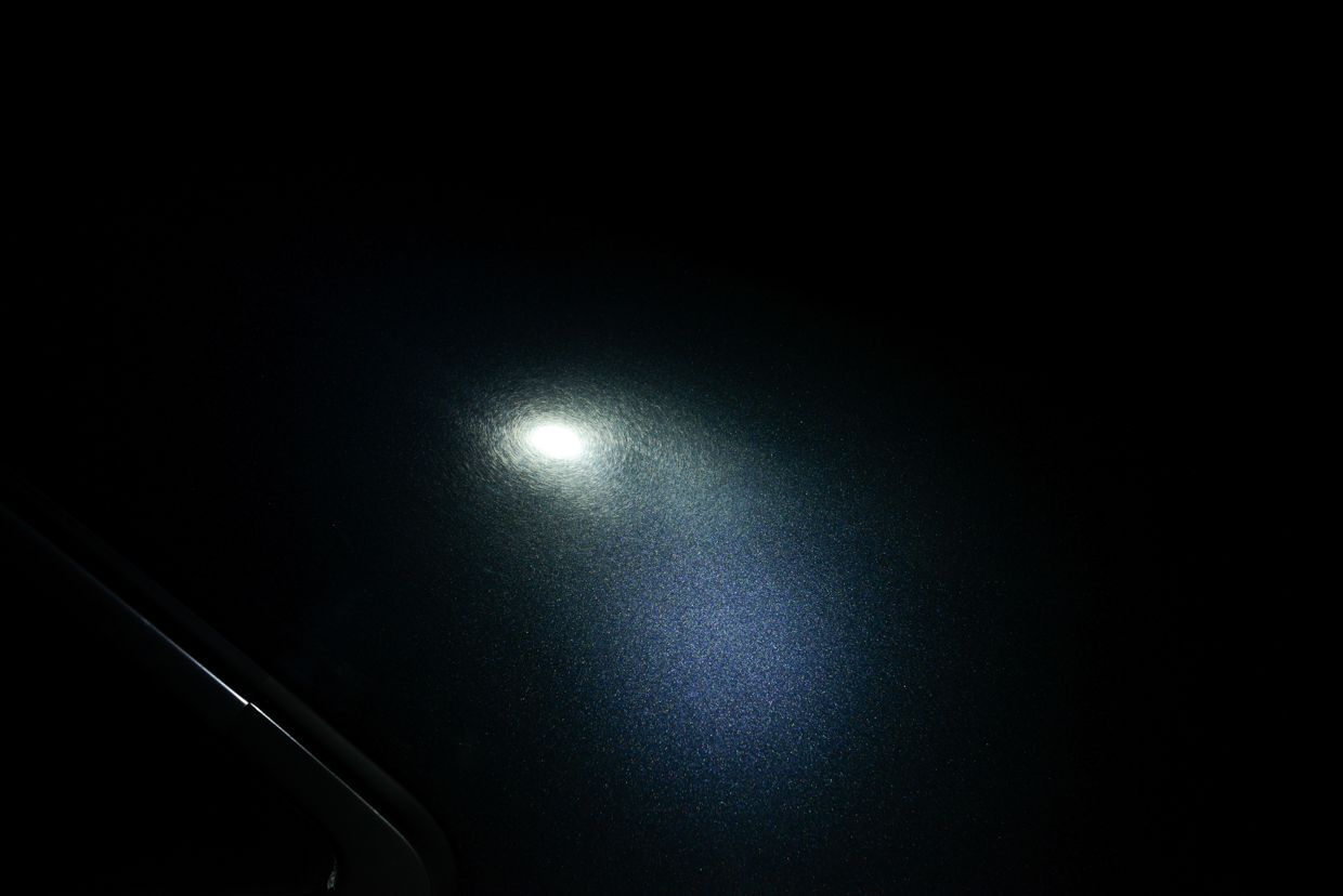

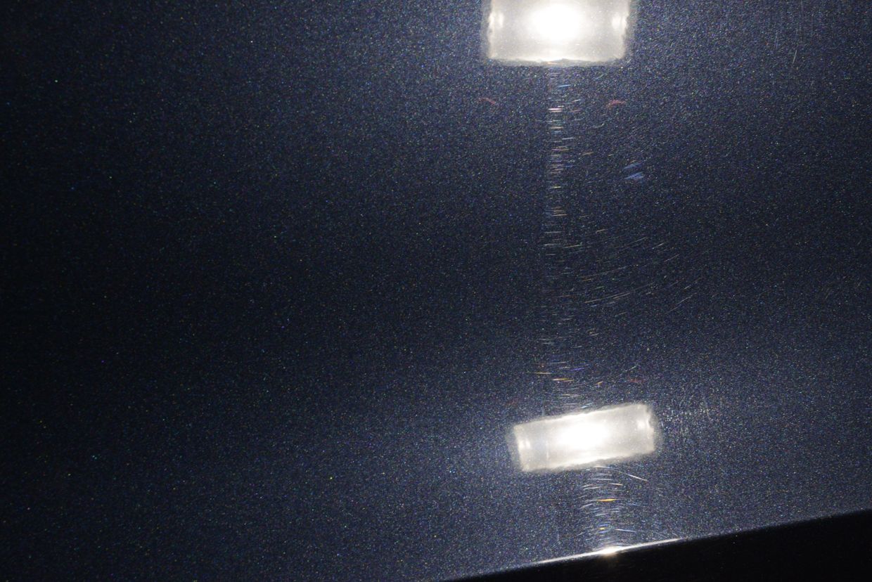

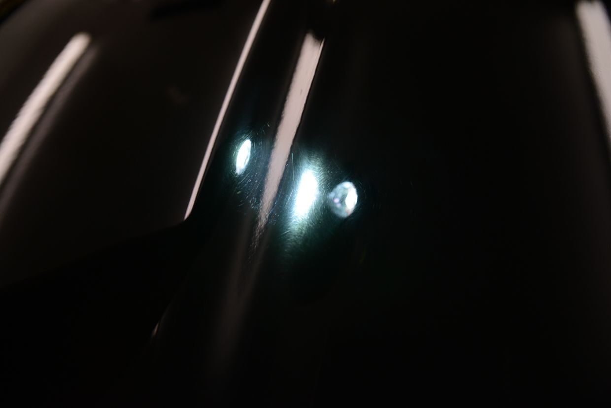

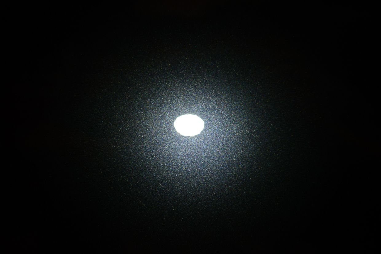

Swirls (Brinkmann)
Swirls (Fenix LED)
Lower rocker molding was very swirled up from automatic car washes and shoe scuffs.
50/50

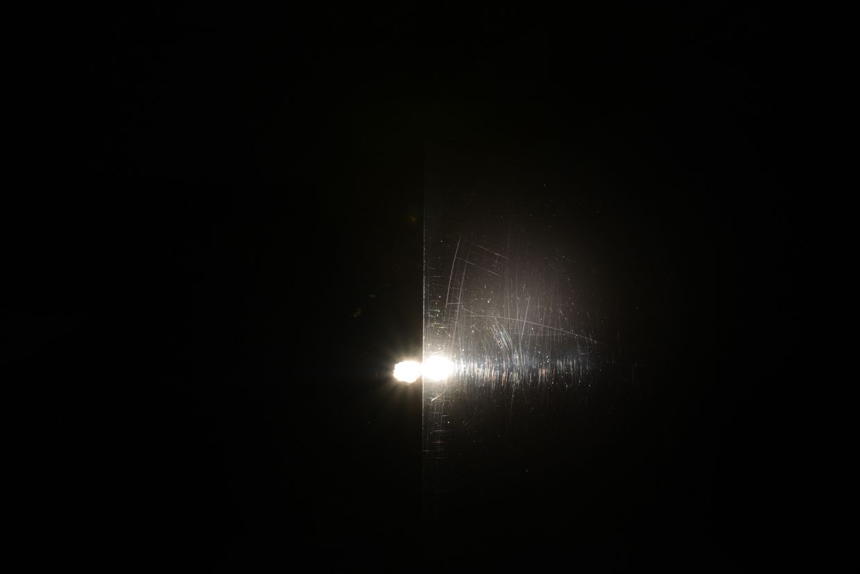

C pillar had left over DA sanding marks by someone attempting to remove a scratch
50/50 of door
After pics
Brinkmann
Fenix LED
Finally some sun for after shots!!!
Wheels removed, cleaned, and coated as well as calipers
Thanks for looking,
Rasky

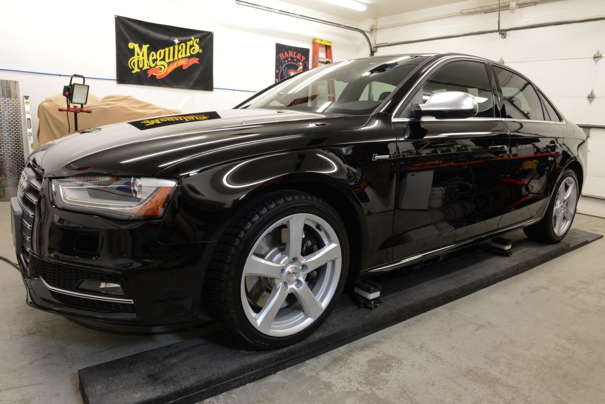

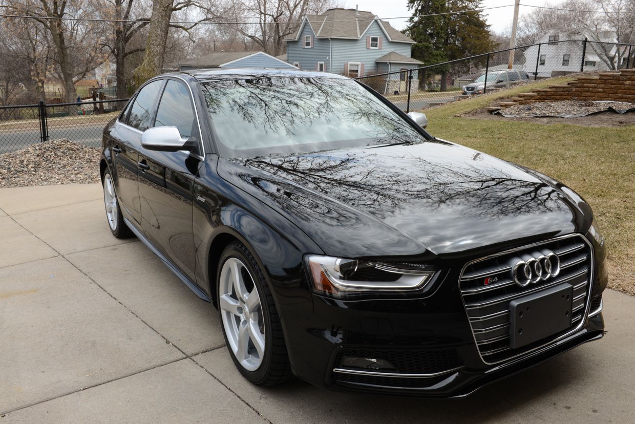

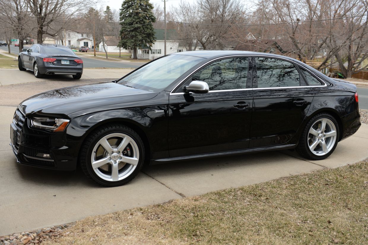

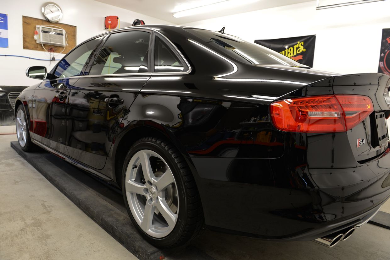

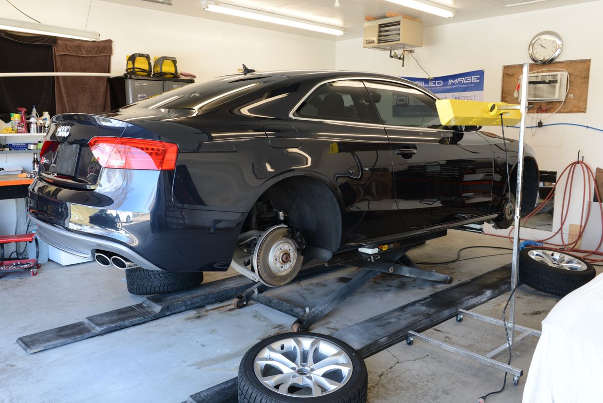

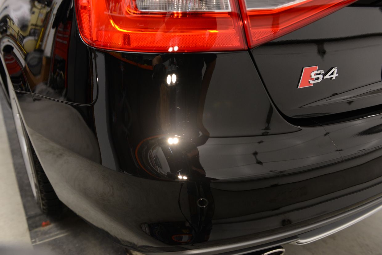

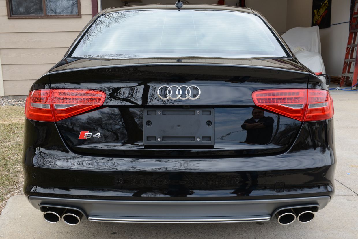

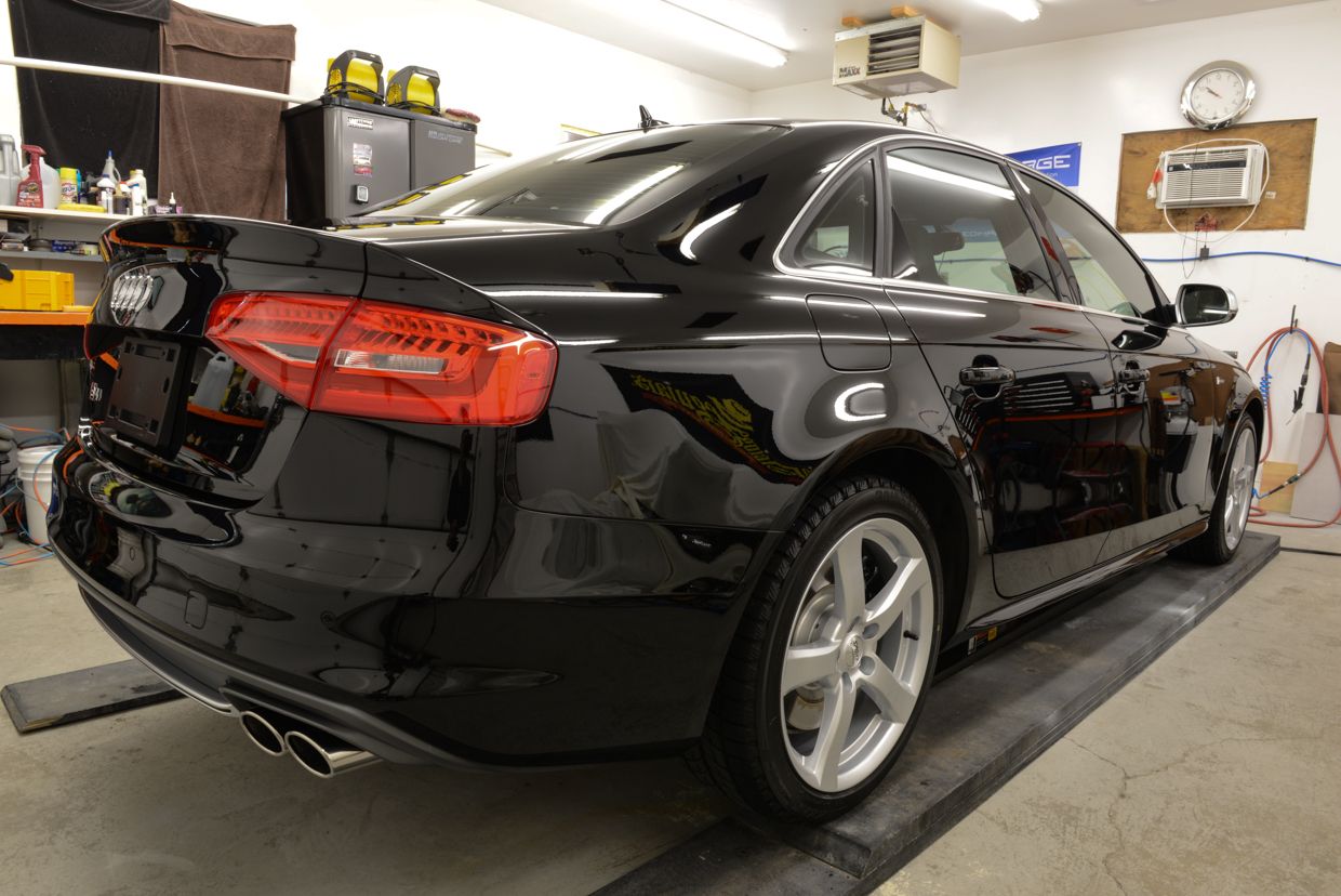

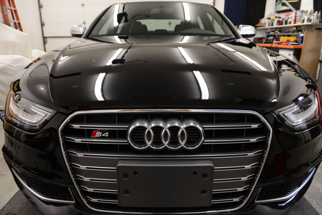

2013 S4, Paint Correction and Opti-Coat Pro Coating.

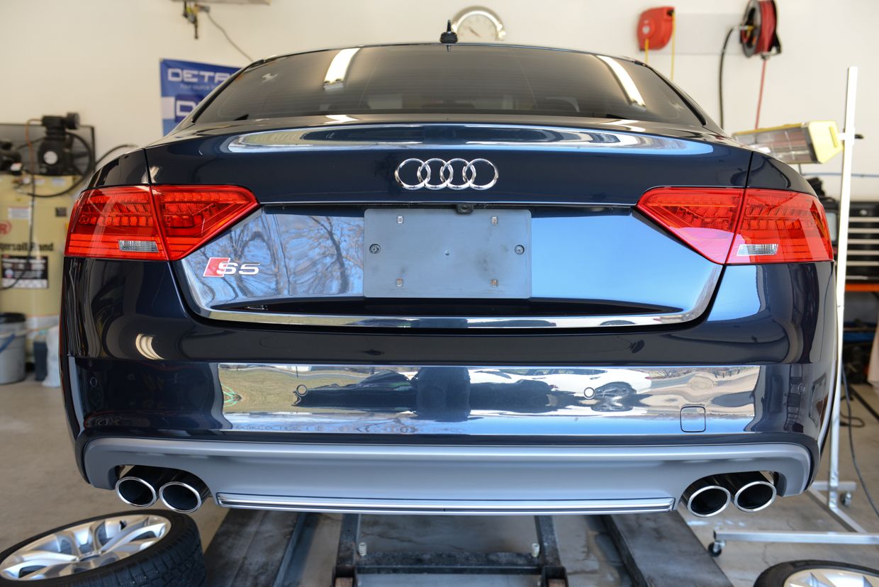

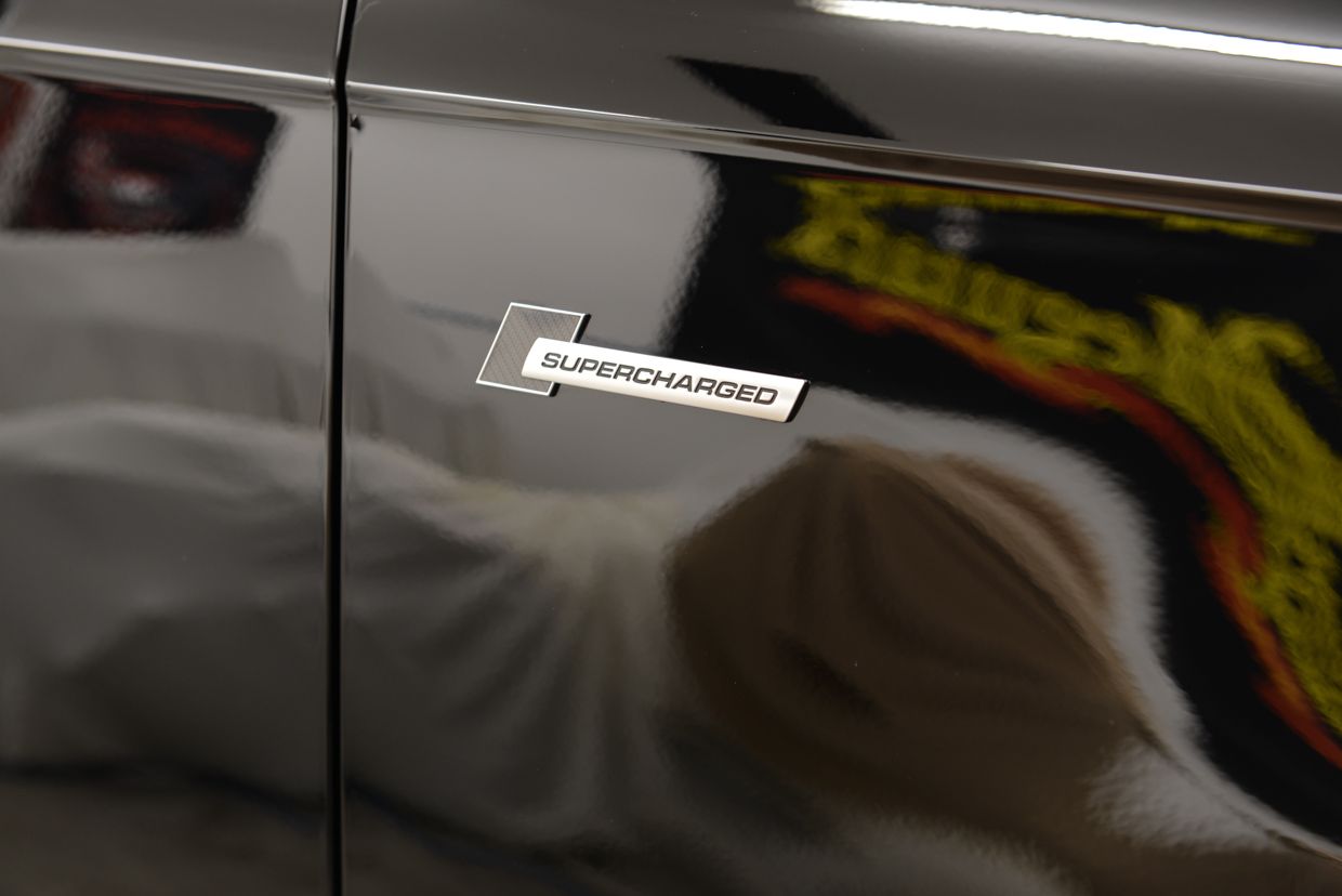

I actually performed the new car prep and applied OCP to this car 7 months ago. Over the last 7 months the owner had brought the vehicle into the tire shop to have the winter wheels put on and also to the dealership to have the ugly “V6T” badges removed and replaced with the nicer “Supercharged” ones….and that’s where things went terribly wrong!!!
All fingers point to the dealer as the guilty party for the damage done to this car, but either way it required extensive sanding and polishing to remove/improve the damage. I was told to “do what I could” on the rear bumper cover, which was the worst of the damage, and if the scratches couldn’t be improved to the point where it was hard to see, the owner would repaint the bumper cover.
Video walk around I had texted to the owner after I got the car all washed up.
View: http://youtu.be/Uzgh5Rbf1dQ
Before pics….(iPhone as I didn’t have my DSLR)

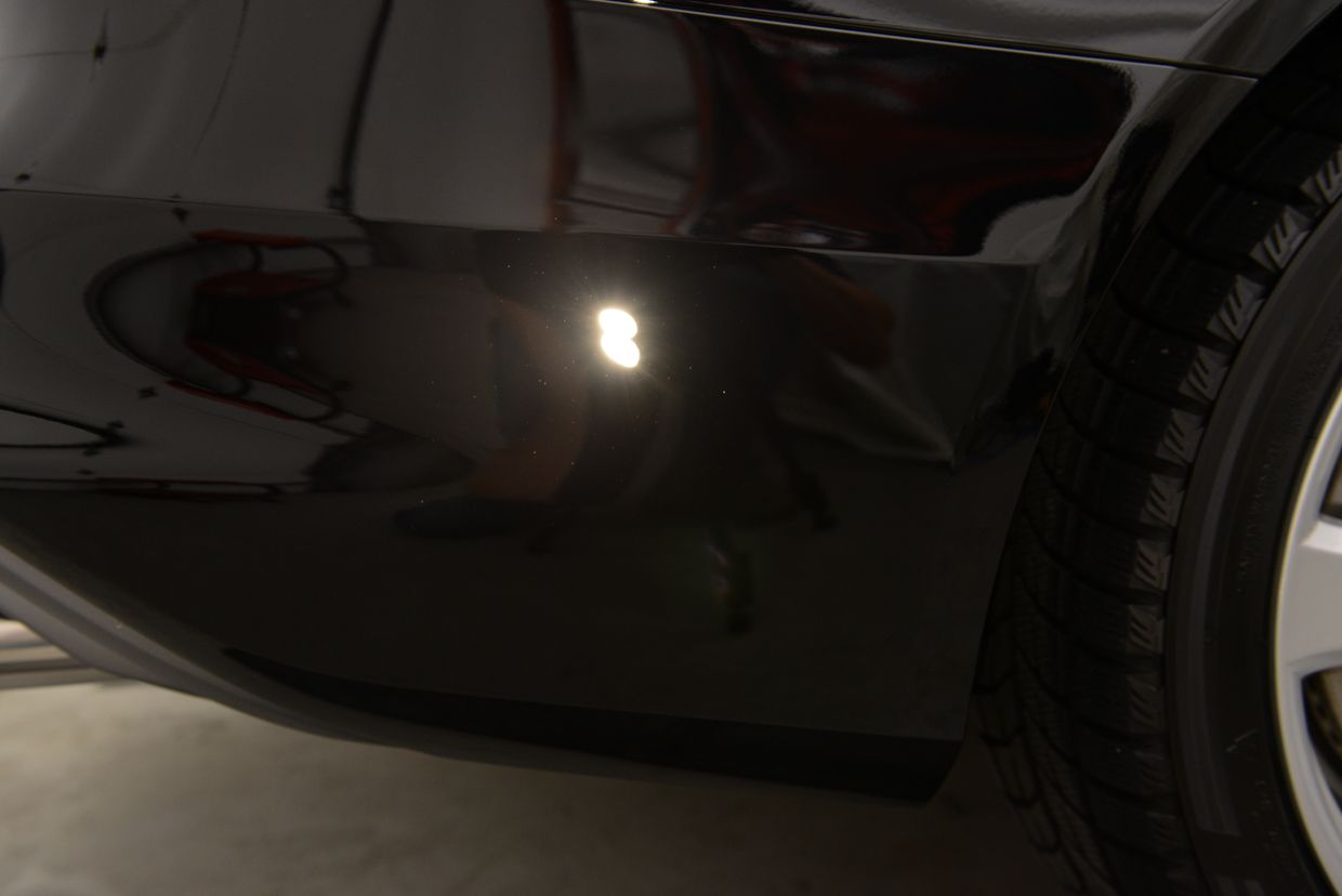

Deep scratches on the rear bumper
More deep “circular” scratches on both sides of bumper covers/wheel well openings…these could have been from an automatic car wash, “Hub Scrub” or possibly a snow removal sweeper.
Passenger front door
Initial wet sanding, 1500/3000
After

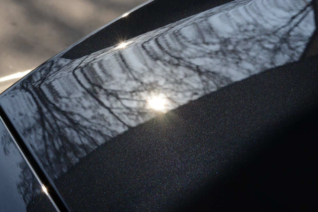

Did the owner ever talk to the dealer about the major marks on that audi? What's the cause of the "shrink" as you call it on the repaint? You mention that the top panels were the worst. Is it something to do with sun exposure or?
I doubt it. He said he knew the service manager very well at the Audi dealer and he couldn't imagine they did it and he was leaning toward the tire shop. I said well, I don't think most tire shops have a rotary buffer and clearly whoever did the damage knew about it, because they tried to polish the scratches out with a rotary and nasty wool pad. Considering they polished the fenders after removing the ugly badges, I'd say I'm 99% certain it was the dealer.
I've heard various reasons for the shrink but I think it's basically an improper curing thing, the top layer curing before the lower layers. I know my old man will let the primer cure for weeks and occasionally months before painting on the resto jobs. Another reputable source said it like this when I recently asked about it....."as the solvents in the paint bite they also soften layers under. This reaction can also cause movement under layers. It hides like stretching rubber over something then contracts showing defects as it expands later. Solvents bond and all hell brakes loose".
I guess it could be possible that expose to the sun heated up the top panels more resulting in faster curing of the top layer. Could happen when baking too though. There was a noticeable smell of solvent when I was sanding the tops. ;)

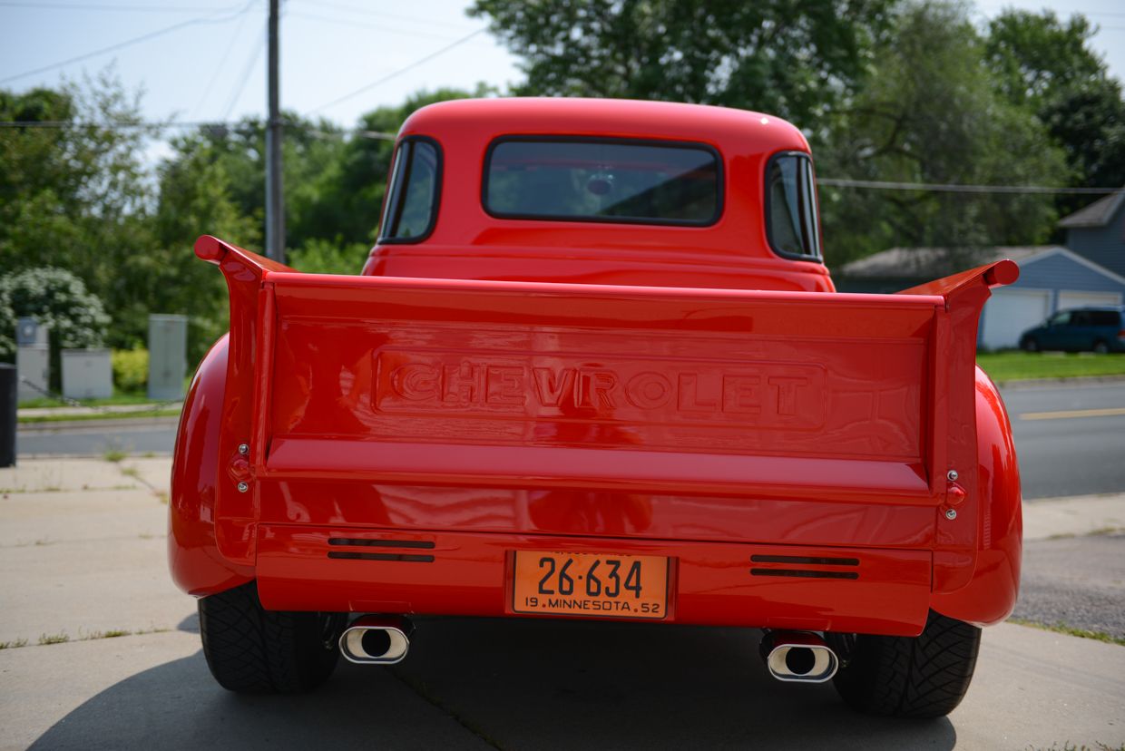

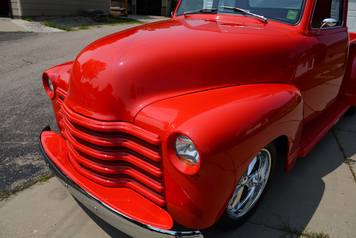

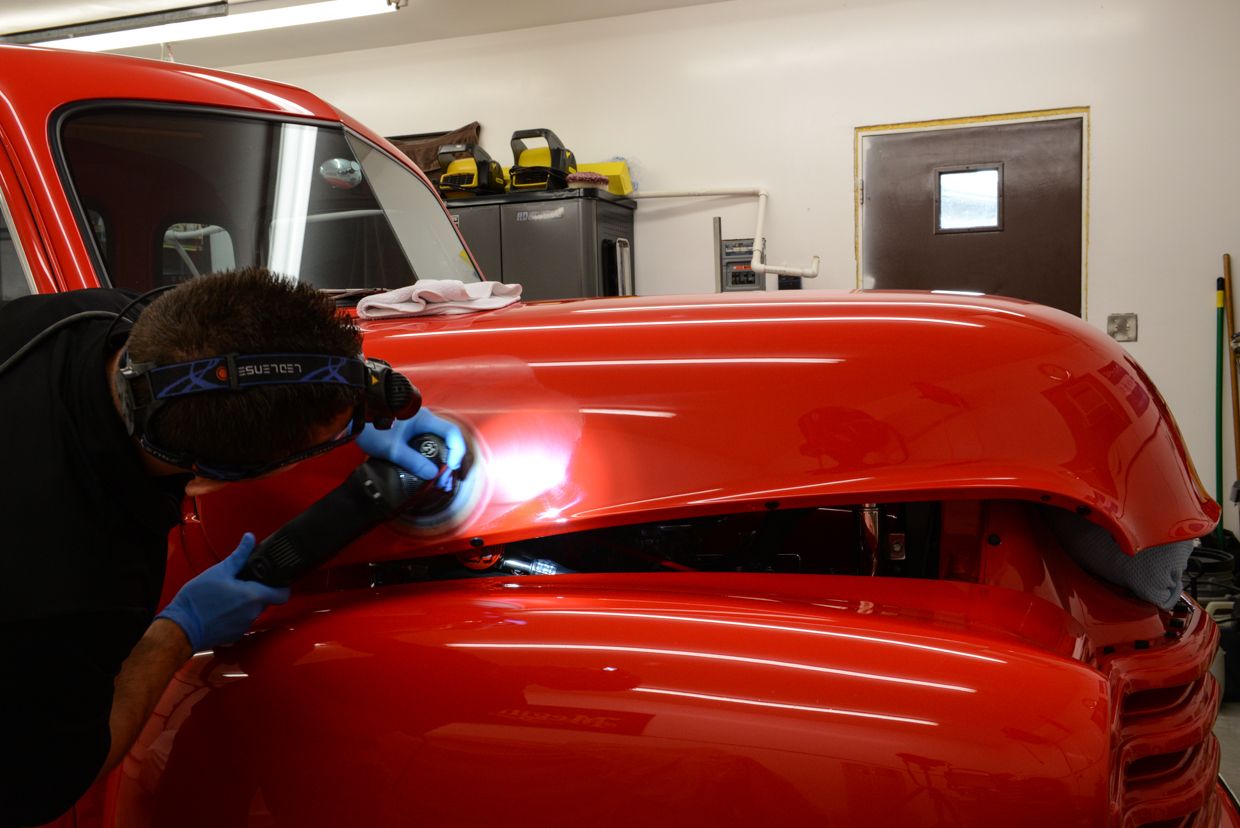

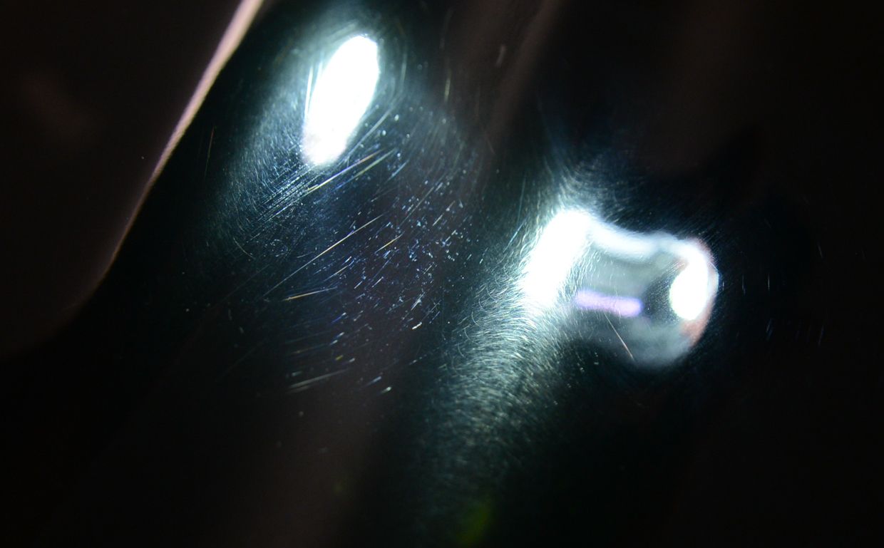

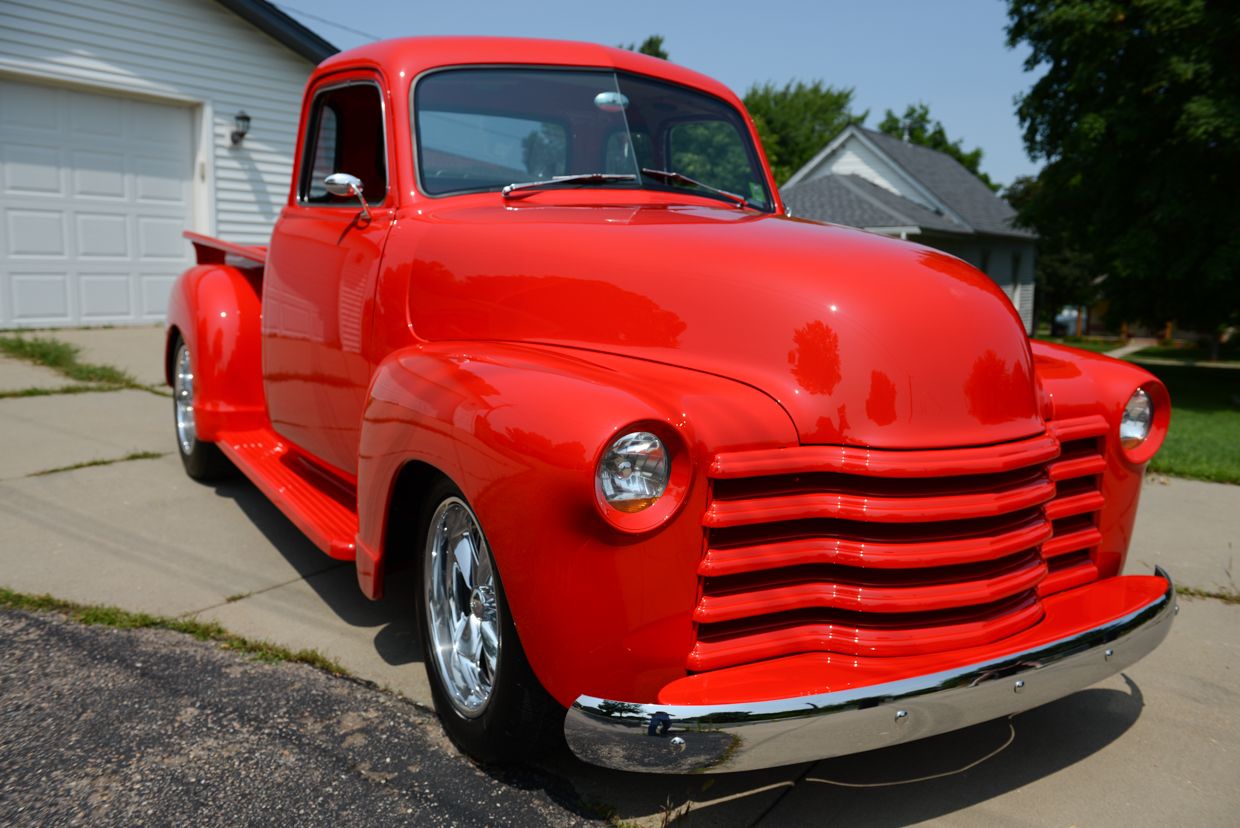

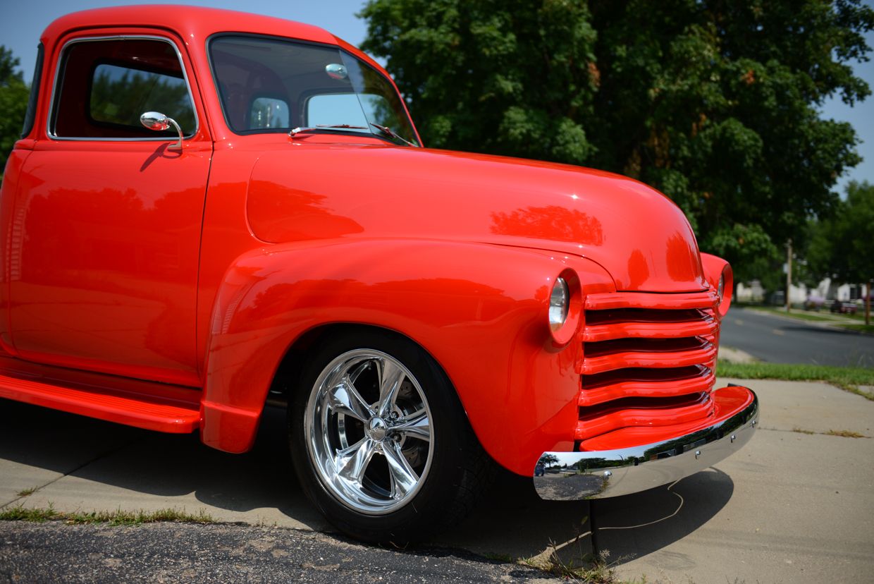

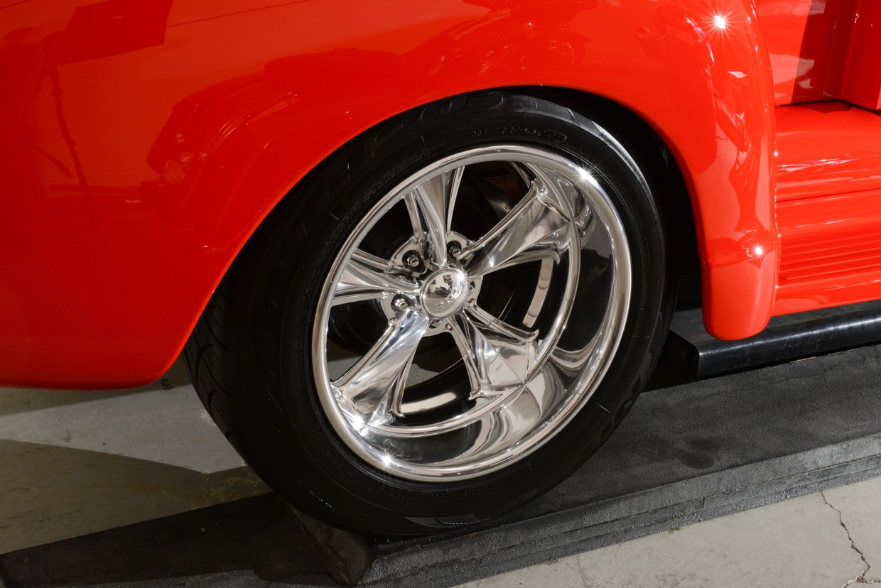

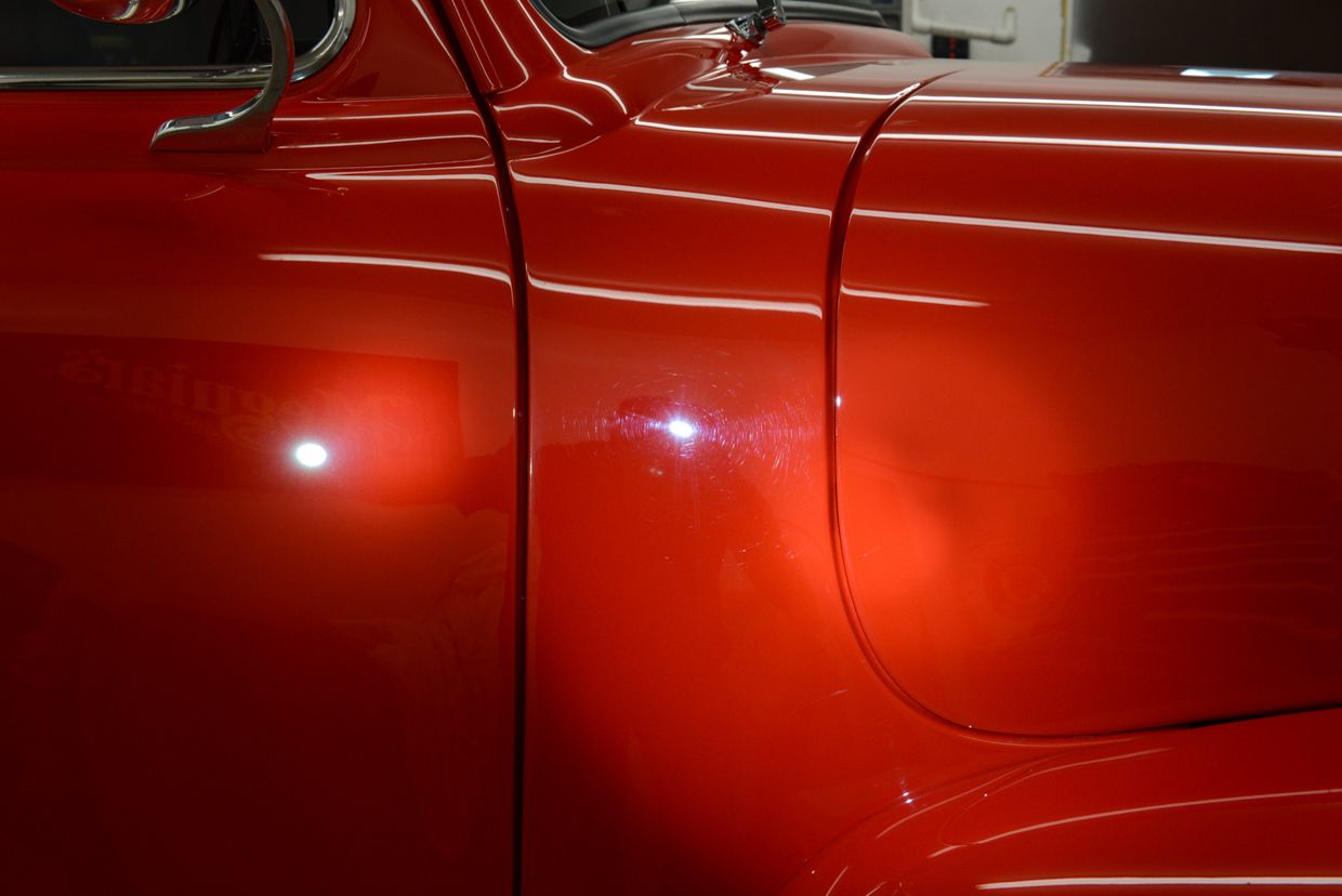

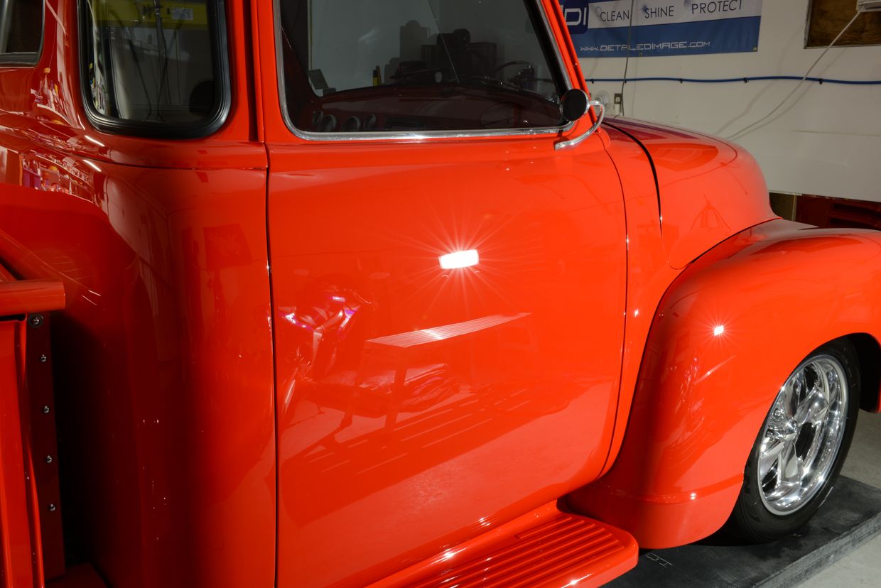

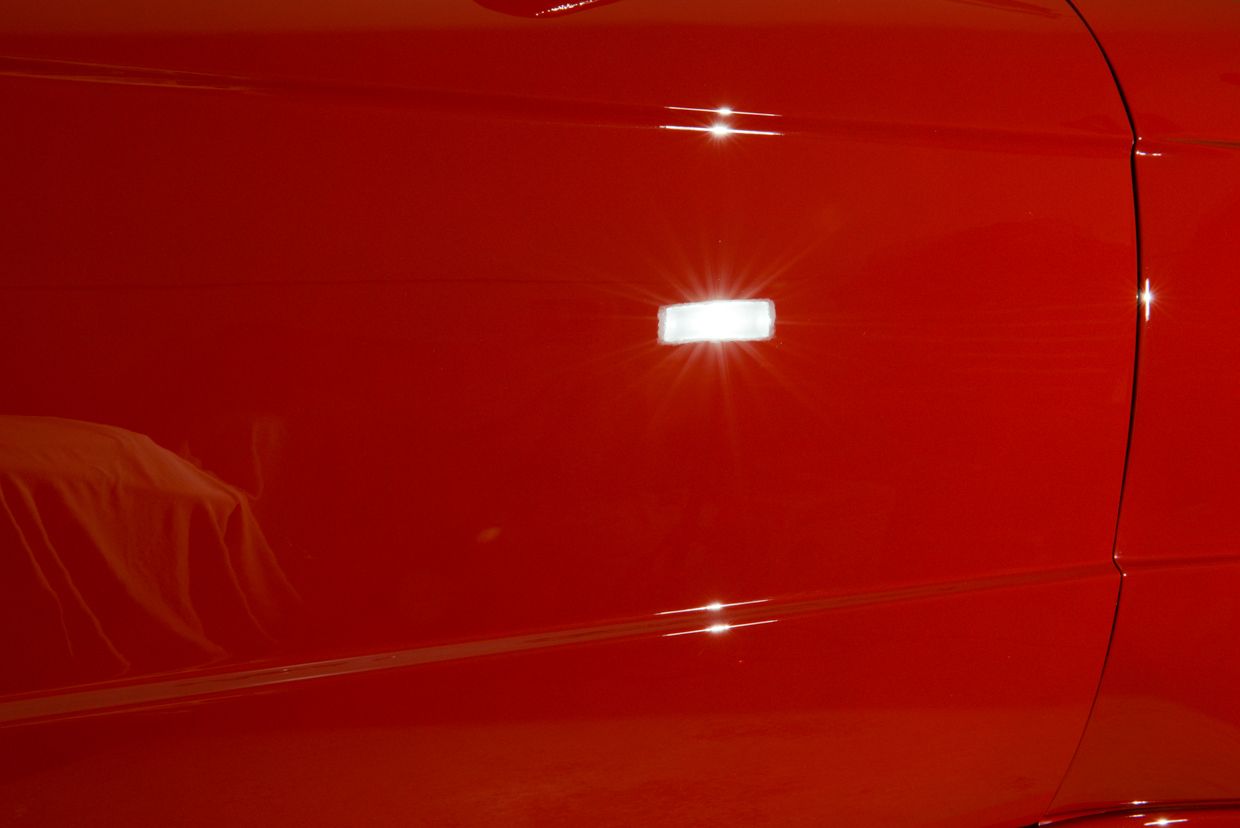

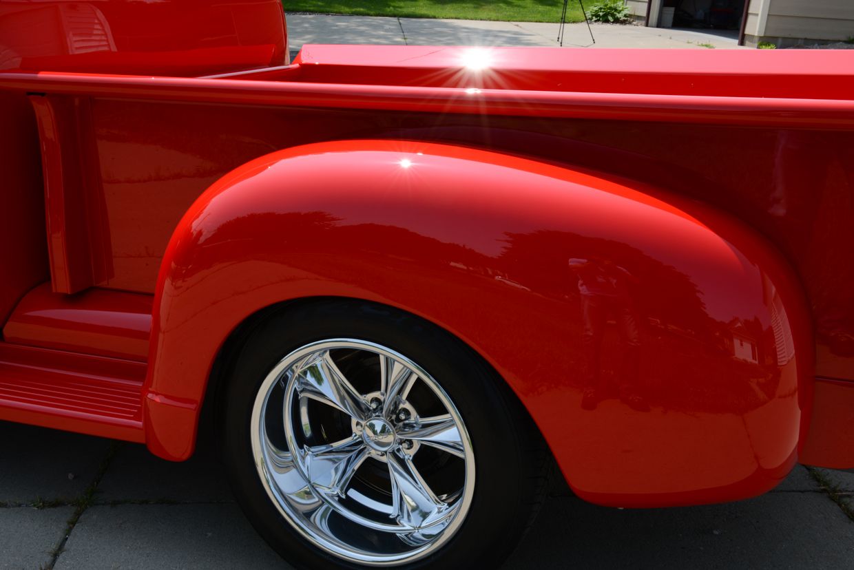

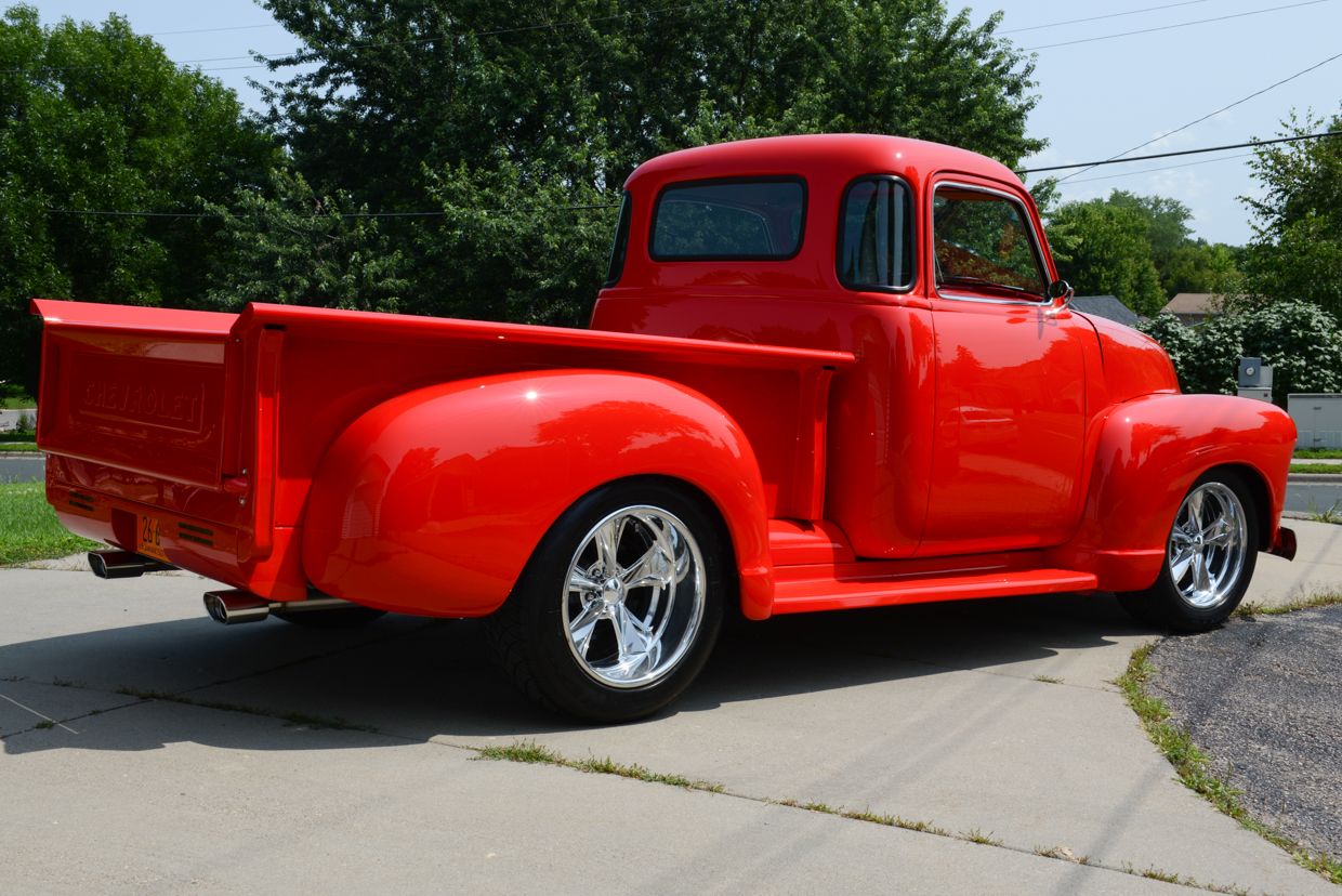

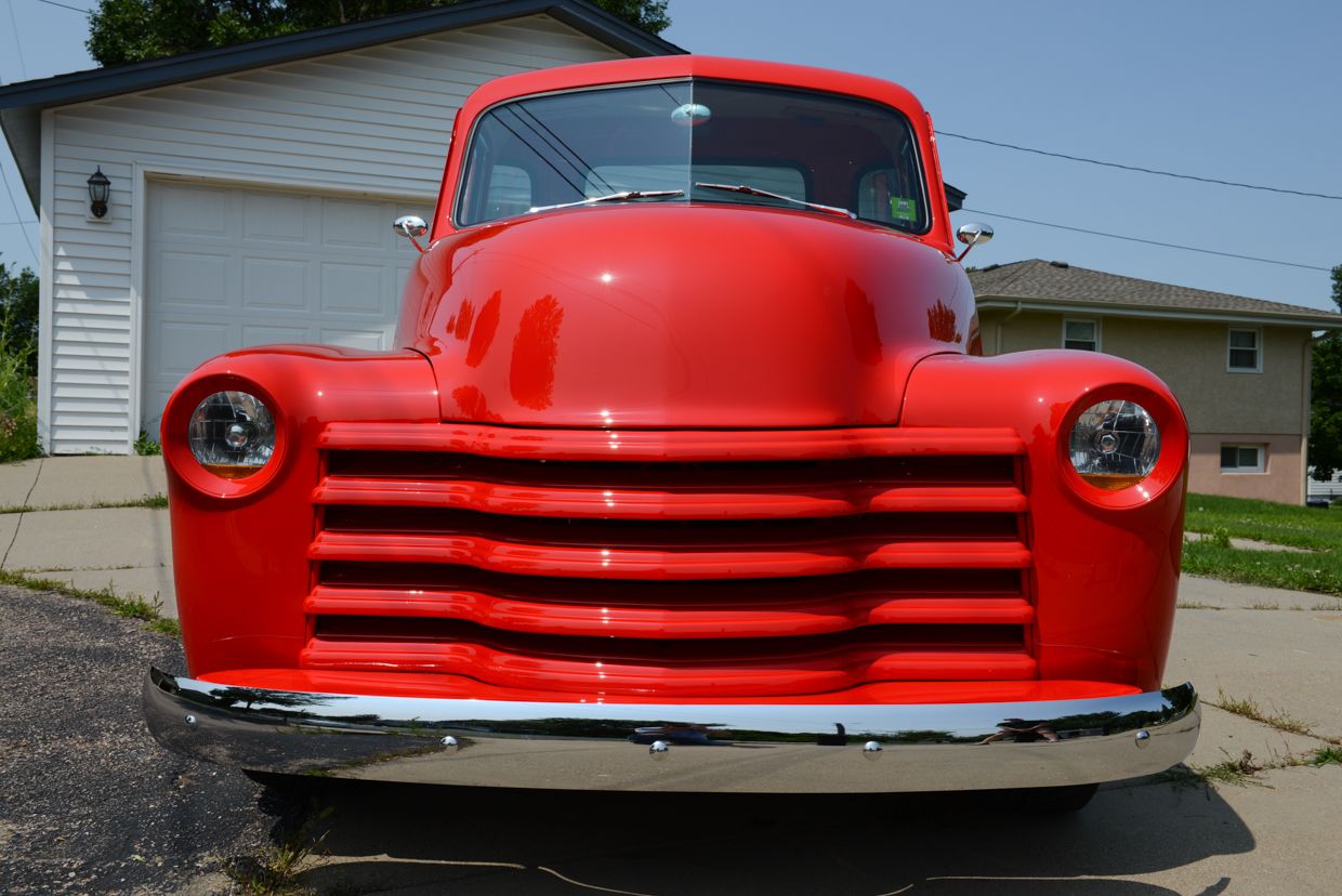

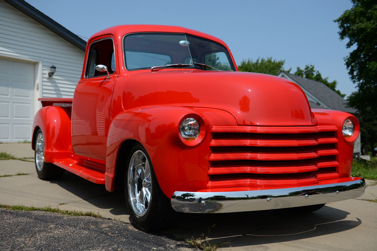

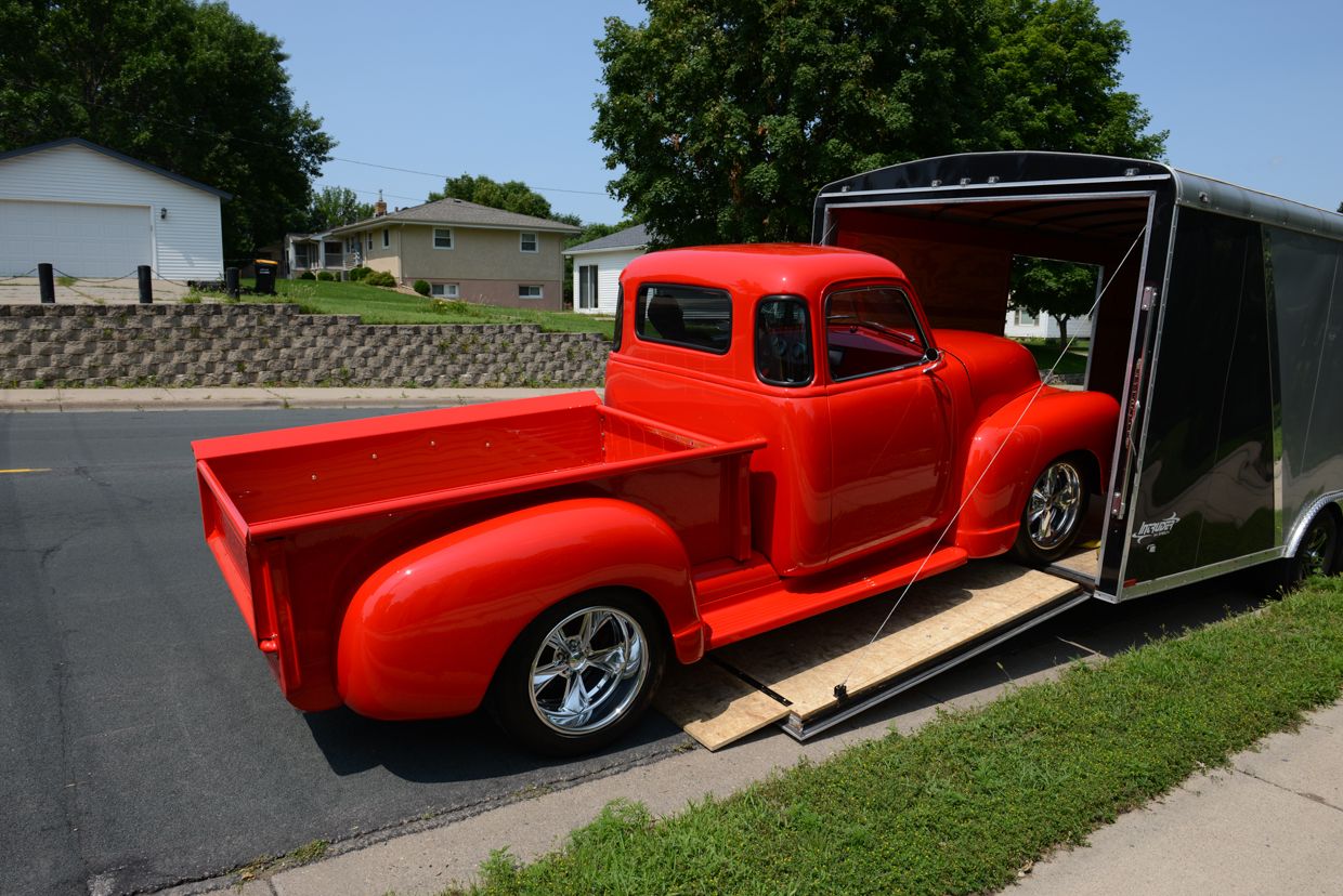

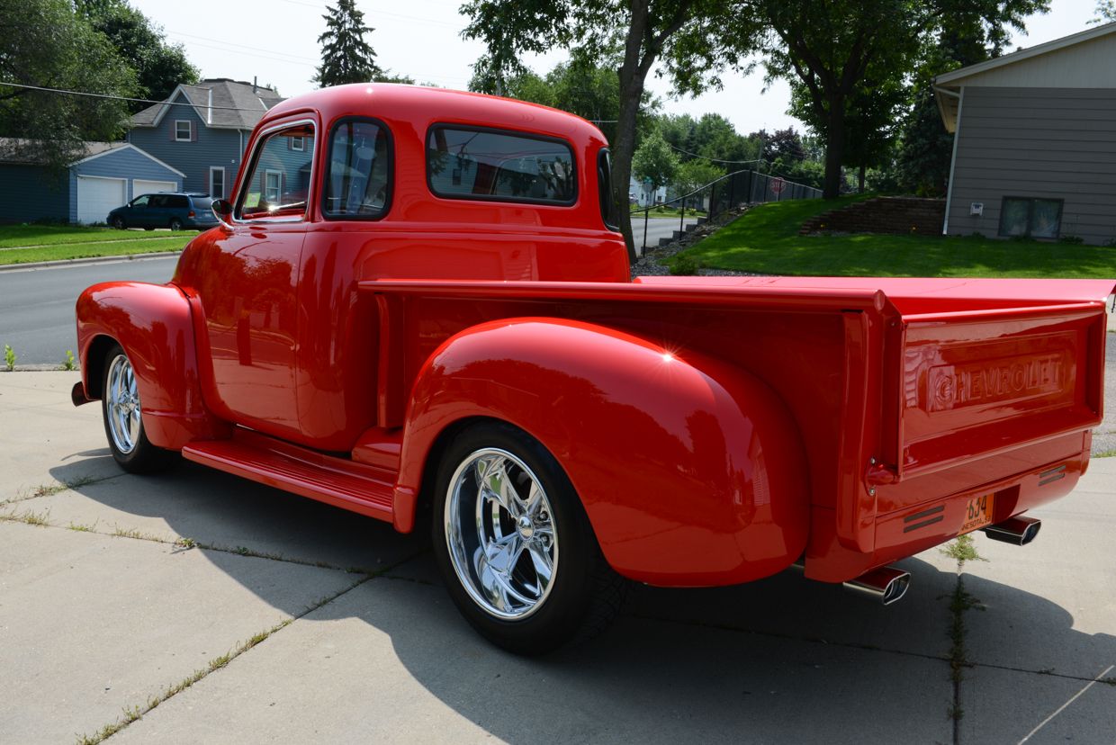

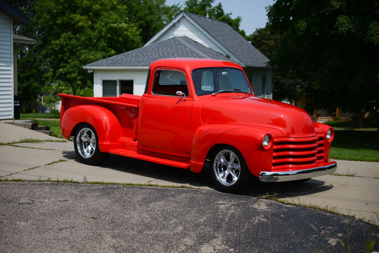

’52 Chevy Truck, Paint Correction and CQuartz Finest Application

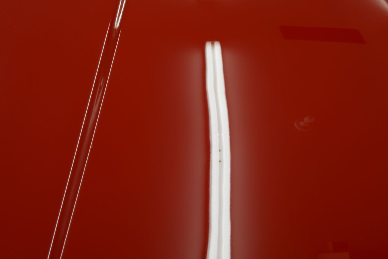

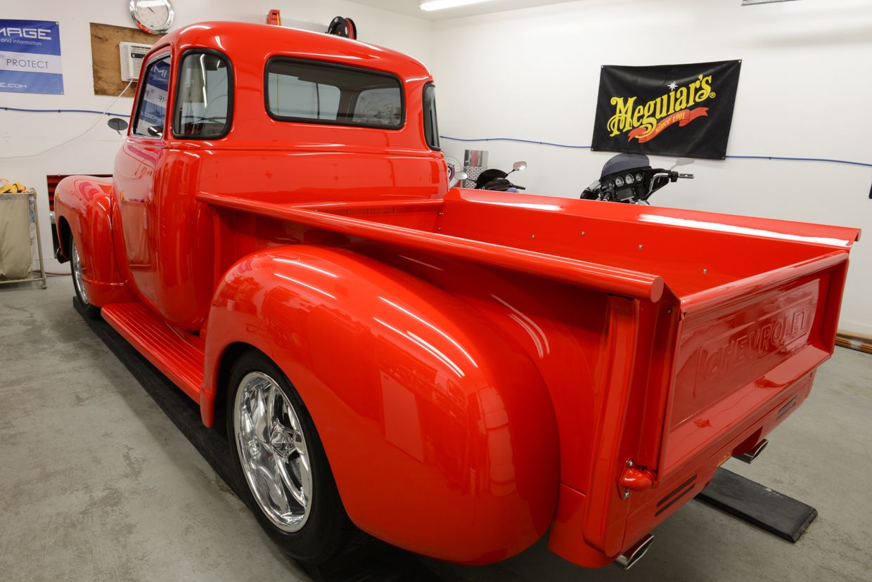

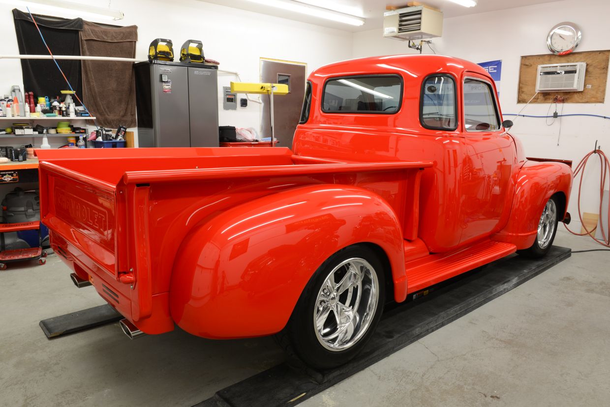

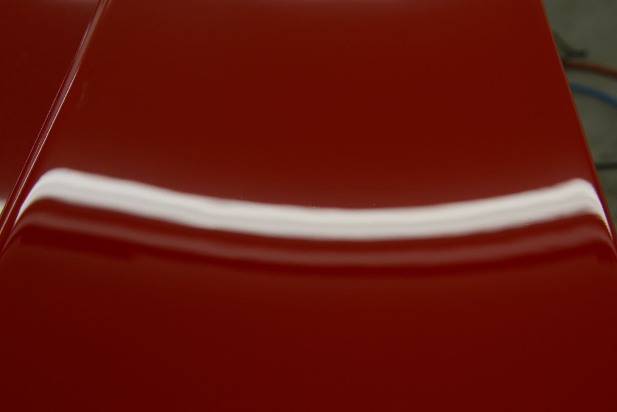

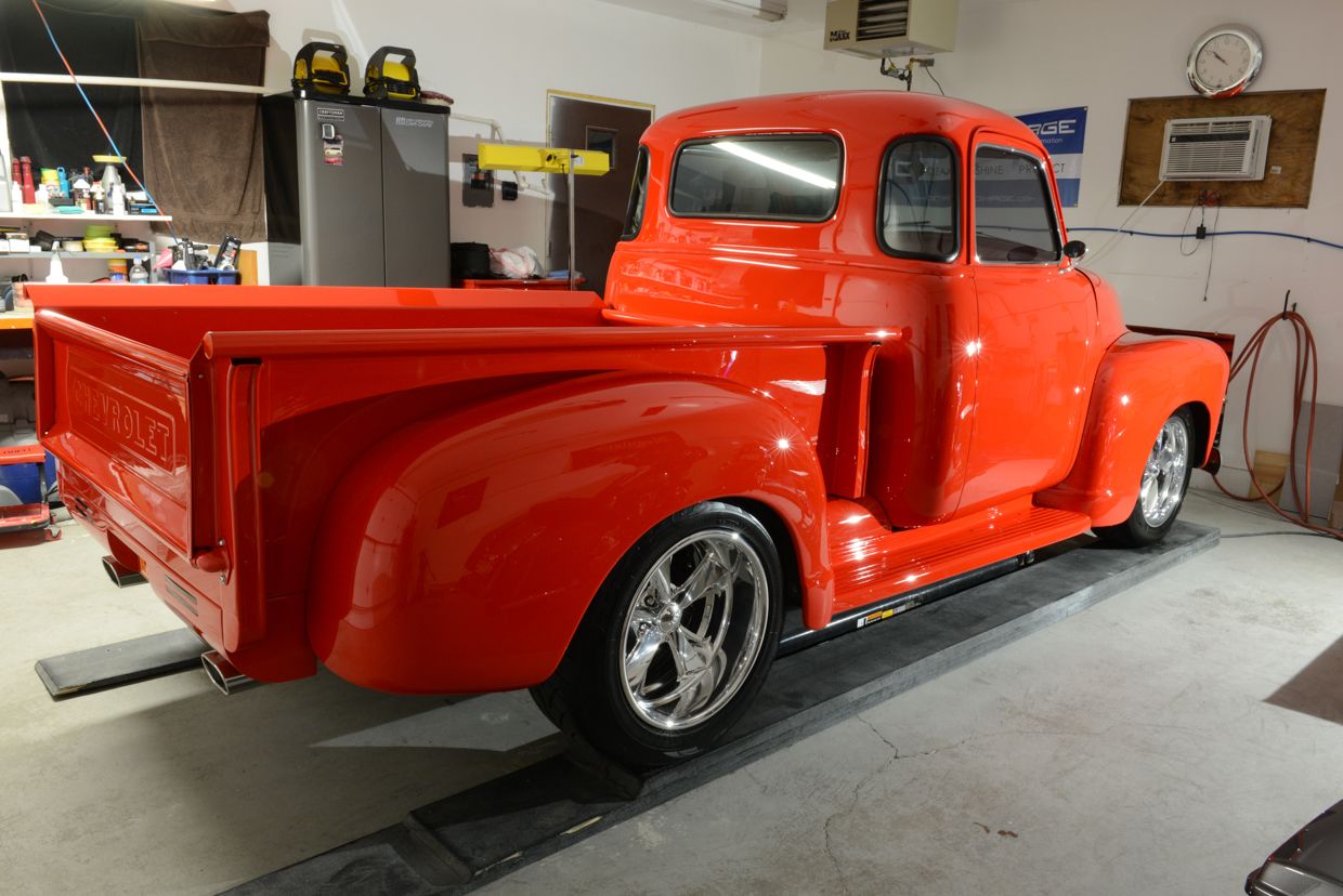

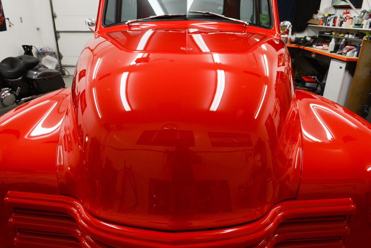

This truck belongs to a good client of mine who was looking to have Finest applied to it after having me do his new C7. The truck itself was absolutely beautiful, and you could really tell that the shop who built it had put a lot of time and pride into the restoration. However, it was finished back in 2009, so after 5 years there was a good amount of swirls that had accumulated as well as some deeper scratches too, many which required an additional pass or two to remove. It was originally scheduled for a 2-step correction, but I ended up doing a little more than that on most the truck and all the small intricate areas, not to mention the sheer amount of surface area, really added up on the clock. In total I had around 45hrs into this job and achieved about 95% correction.
Rather than hit it really hard, my go to for correction was HD Adapt on the Rupes 21 with Megs MF Finishing pads. While this combo cut a little slower and required an additional pass or two on the deeper scratches than a more aggressive process, it also produced little to no dust, finished down virtually LSP ready, and it made remaining defects very easy to see.

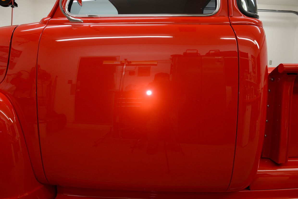

Some 50/50 shots after compounding, no fishing polish yet.

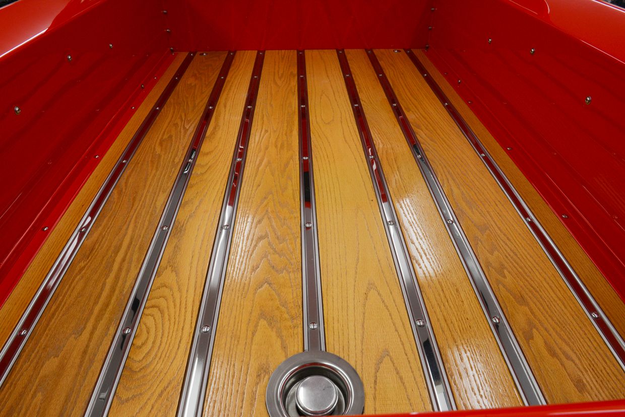

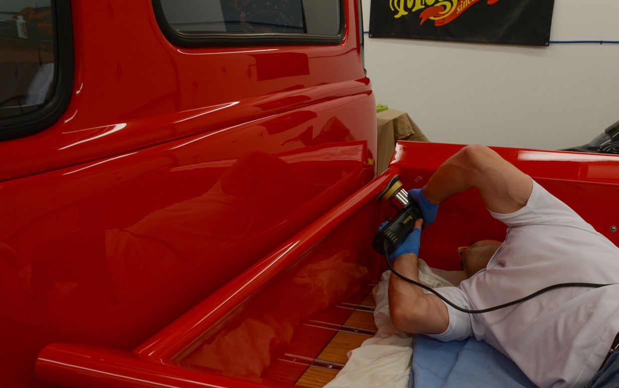

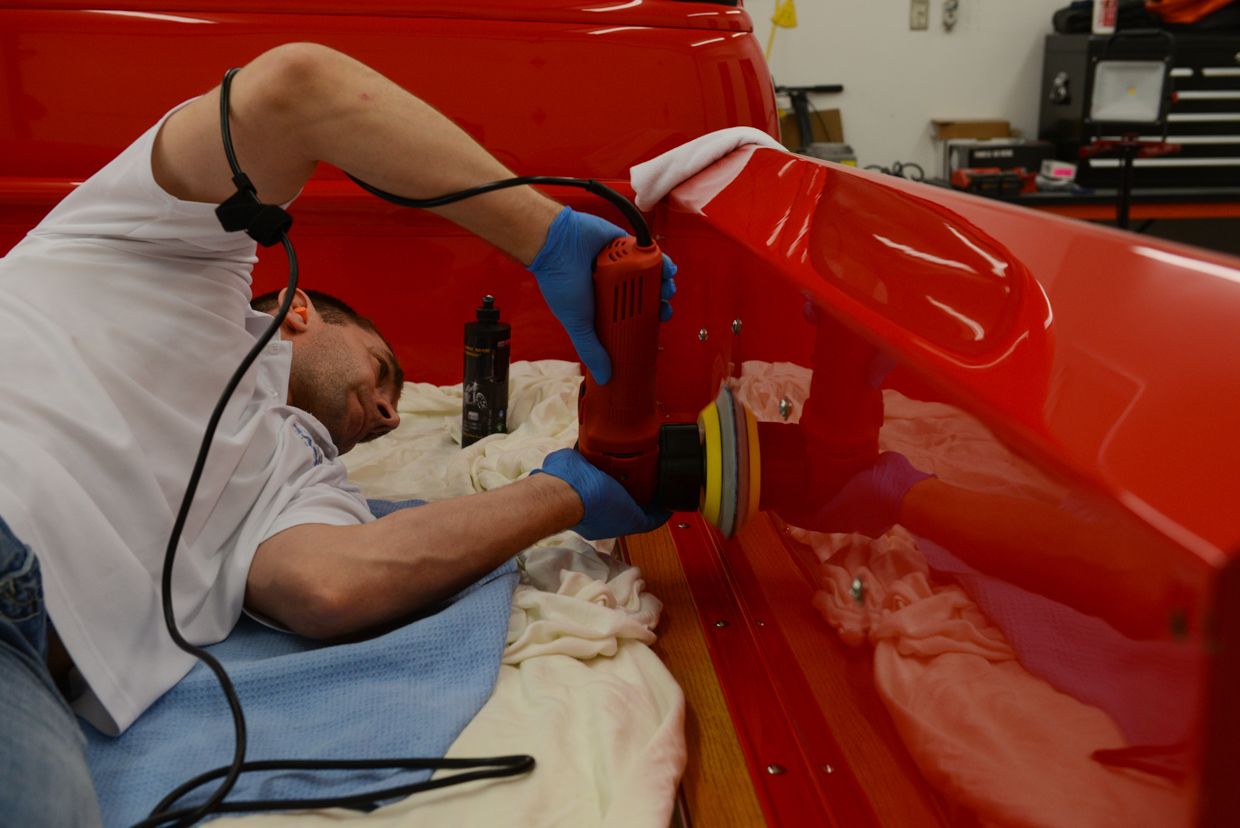

Inside of the bed was also polished. I chose to use small offset machines here.

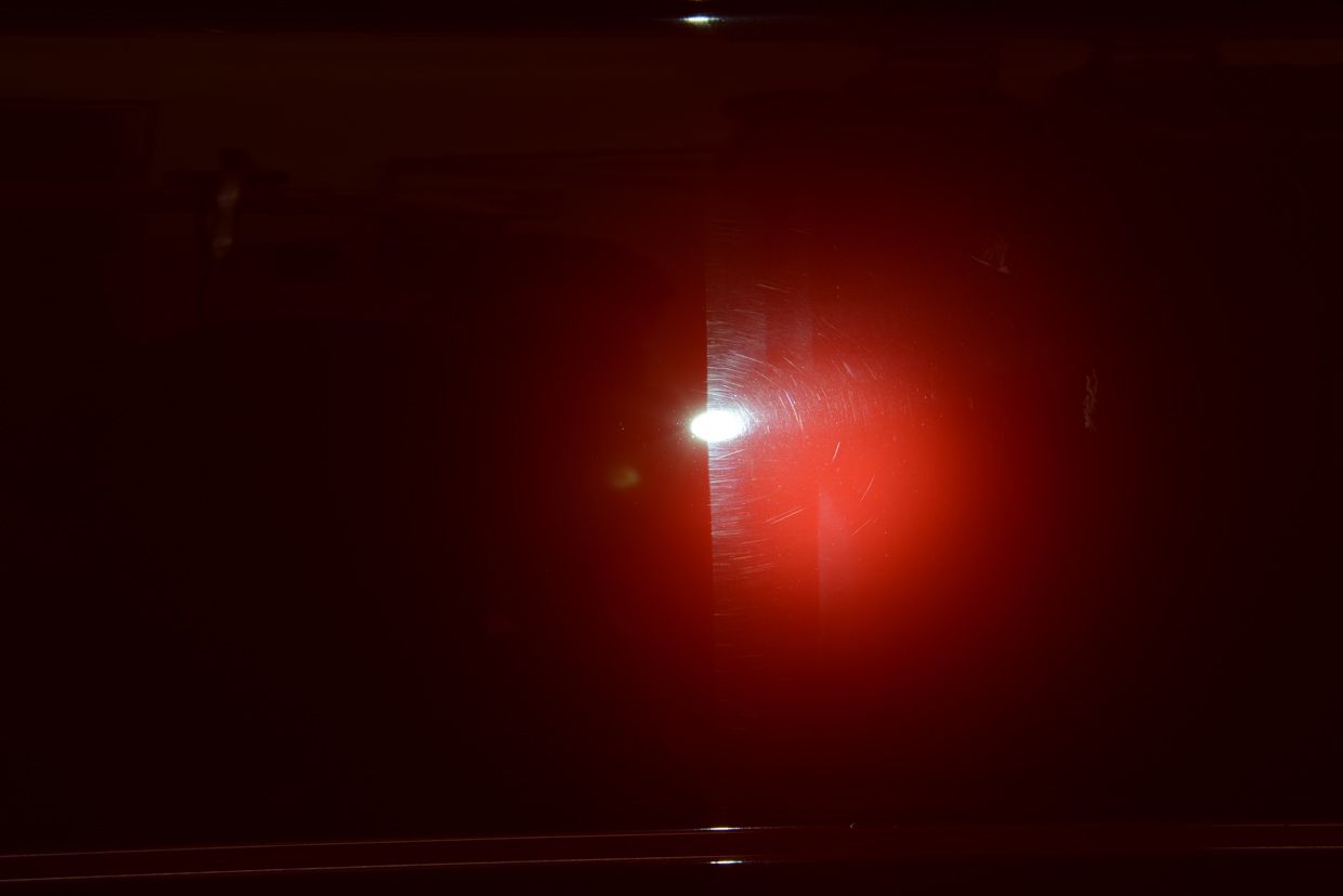

Swirls on the top of the front bumper panels.
After Adapt on the G110v2 with 3” MF Cutting pads. You can see this combo didn’t finish as well as the Rupes 21 and MFFP combo, but still an easy clean up with a finishing polish.
Door and hood compounded, cowl was done with the G110v2 and 3” MF cutting pads.

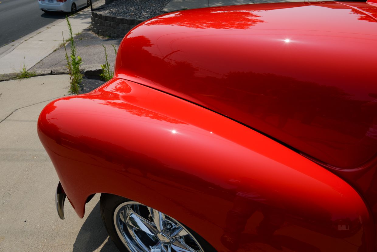

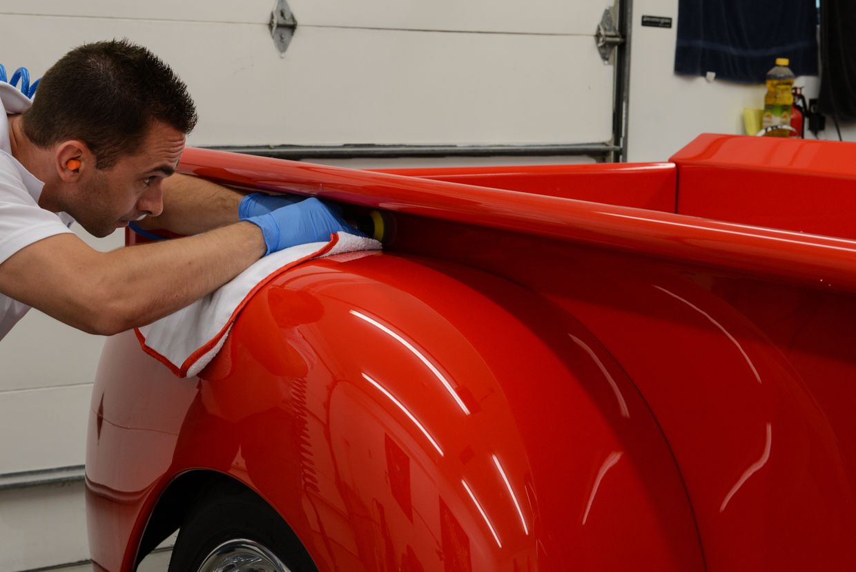

The areas around the box were the most challenging, especially just above the wheel wells.

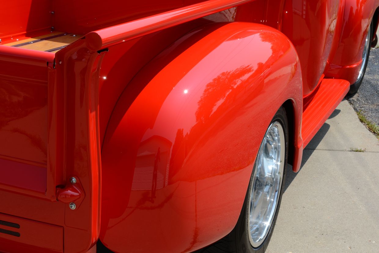

I carefully used my Rupes TA50 to polish these areas

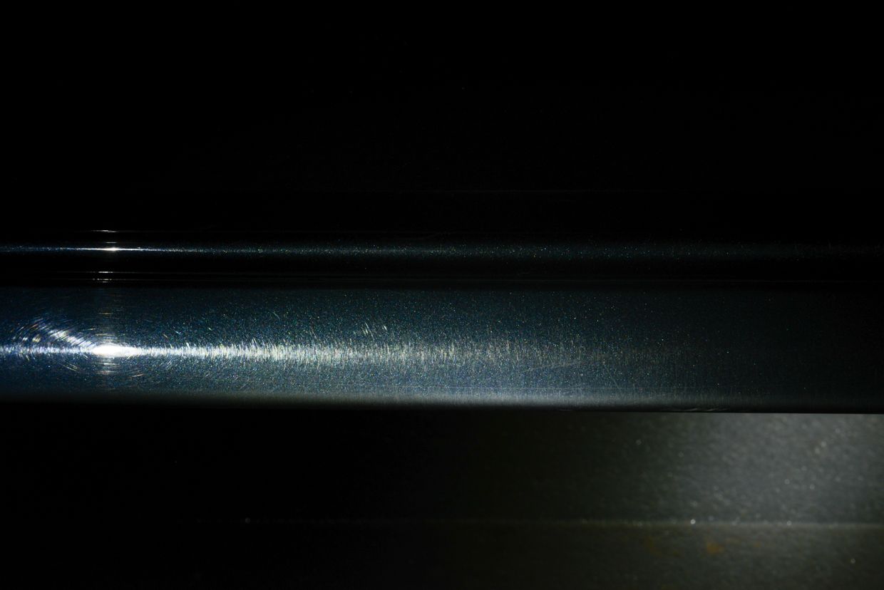

Fenix LED shot after using Rupes 21 and HD Adapt and MFFP
Final polishing was done with HD Polish. Car was wiped down with Earser and then 2 coats of CQF were applied.
