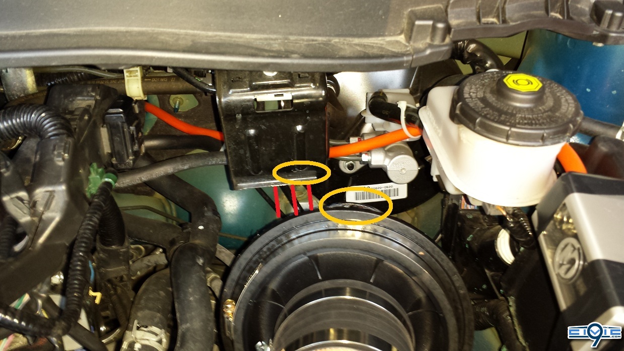

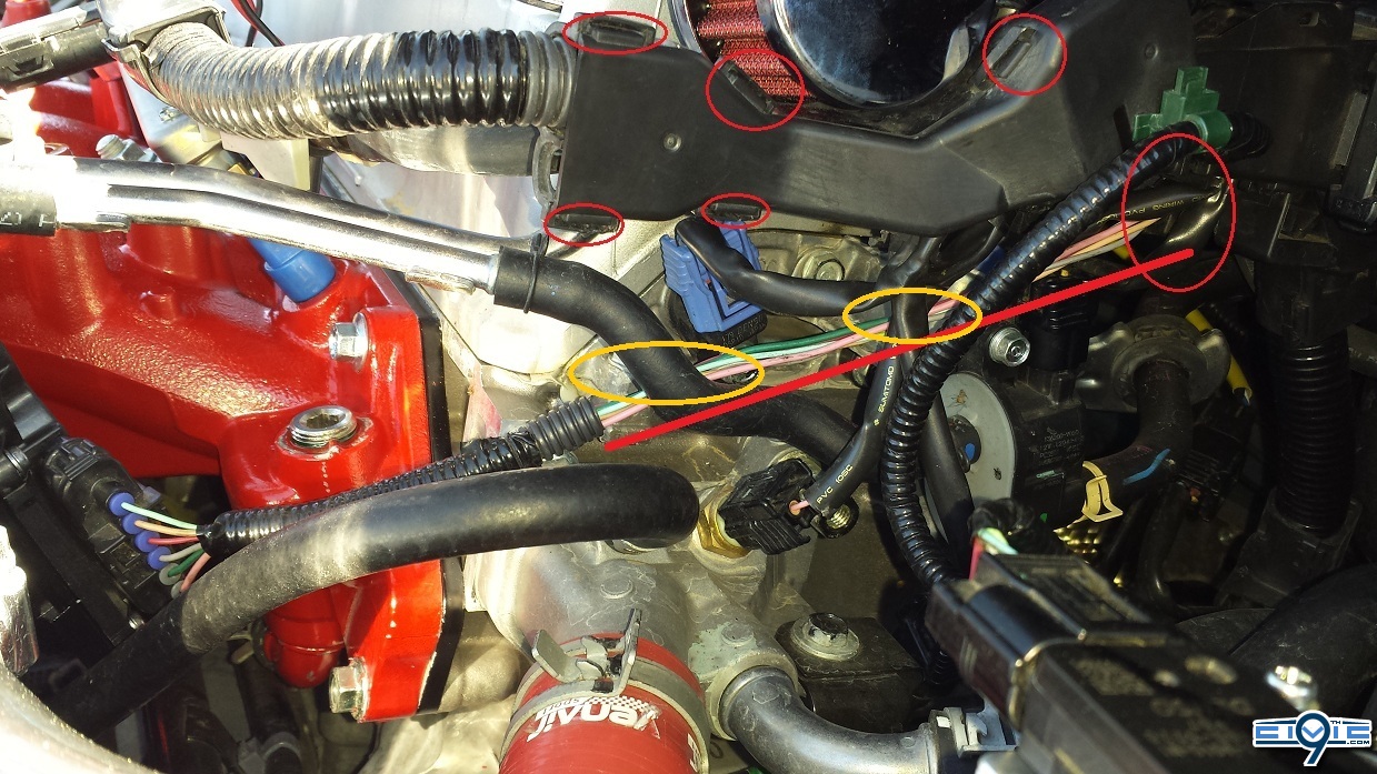

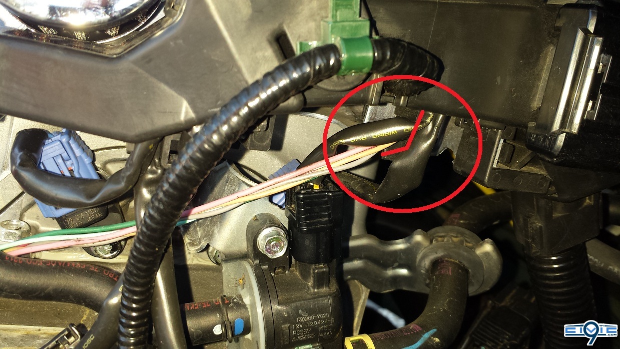

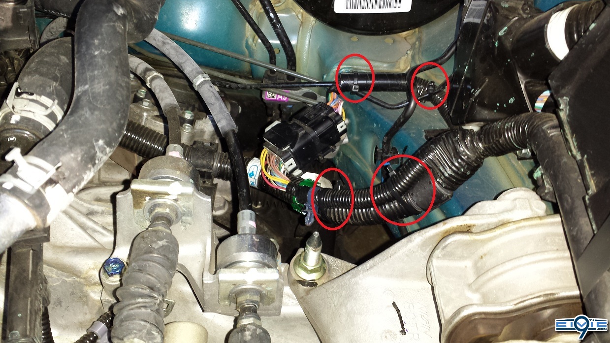

  • Drive by wire connector will not reach the throttle body. You will have to follow the wires back through the bundle and untape them to reroute (red line in the picture). This requires removing the cover (see red circles. This is only some of them.). In order to get some slack, make sure to run the wires behind the coolant hose and another sensor wire as noted with yellow circles. You will reroute them with the bundle that comes down towards the rear of the cover (as seen in the second picture).

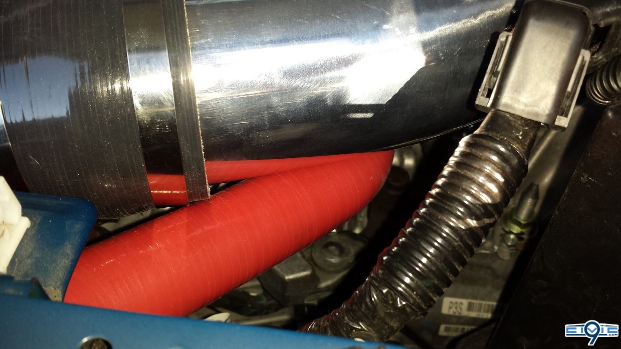

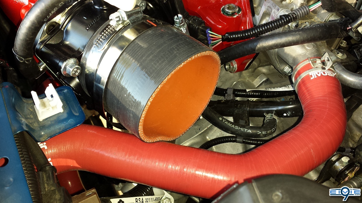

PRL provides an elbow so you can cut your upper coolant hose to prevent heat transfer due to touching the intake. If you do not do this, see picture below for how it touches.

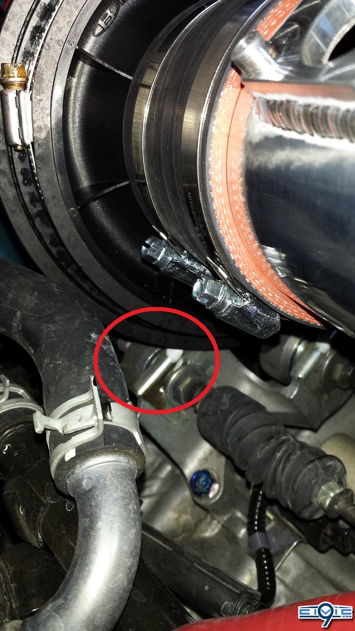

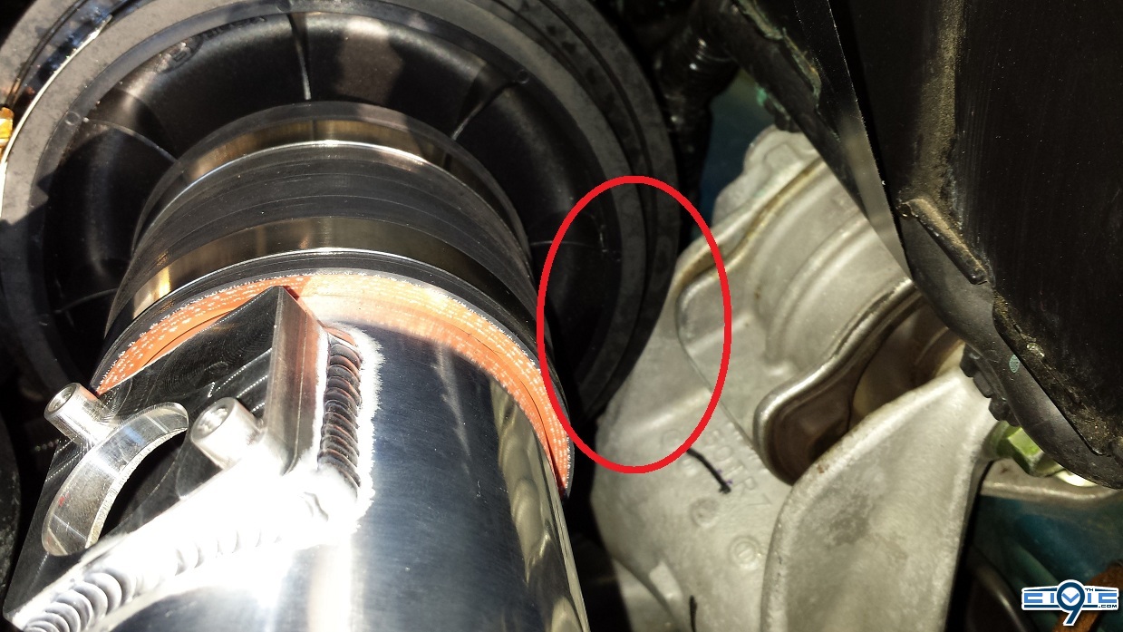

You will need to remove the support bracket for the stock intake box to prevent it from eating the filter. It will also cause the intake to sit too high and touch a metal piece and rattle like crazy. See picture for clearance. Yellow circles are where each part would touch and rattle.

Rerouting of wires after stock intake box bracket removal. I just zip tied them to the existing wires and a steel line.
