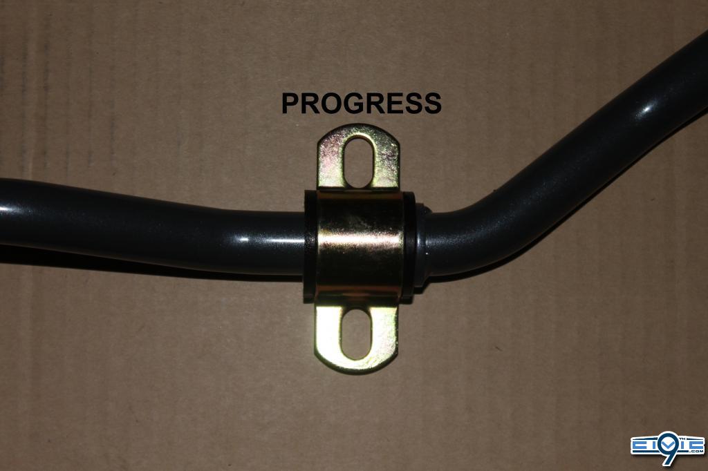

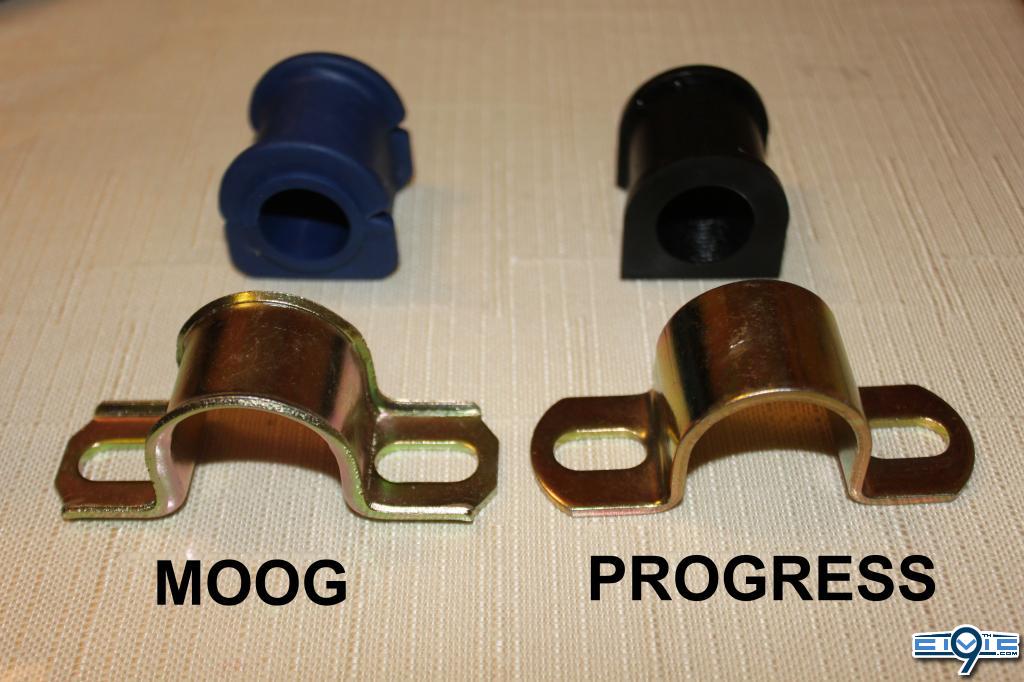

If you already have the Progress 22mm or 24mm Progress rear sway bar (or any other upgrade rear sway bar) and upgraded endlinks, you may not have enough to get the most from that sway bar upgrade. I currently purchased a 22mm Progress rear sway bar and I noticed that the sway bar bushing material was pretty soft for bushings that are meant to be used for a high performing product. I measured the hardness of the bushings and they had a shore A durometer of 70-75, which is just about the same as the rubber on OEM bushings.
So I found a better alternative to the sway bar bushings that Progress provides. It turns out that the MOOG Universal sway bar bushings are perfect upgrades for my 22mm Progress sway bar. These bushings are stiffer with a hardness durometer reading of 90.
Comparison between MOOG 22mm and PROGRESS 22mm:

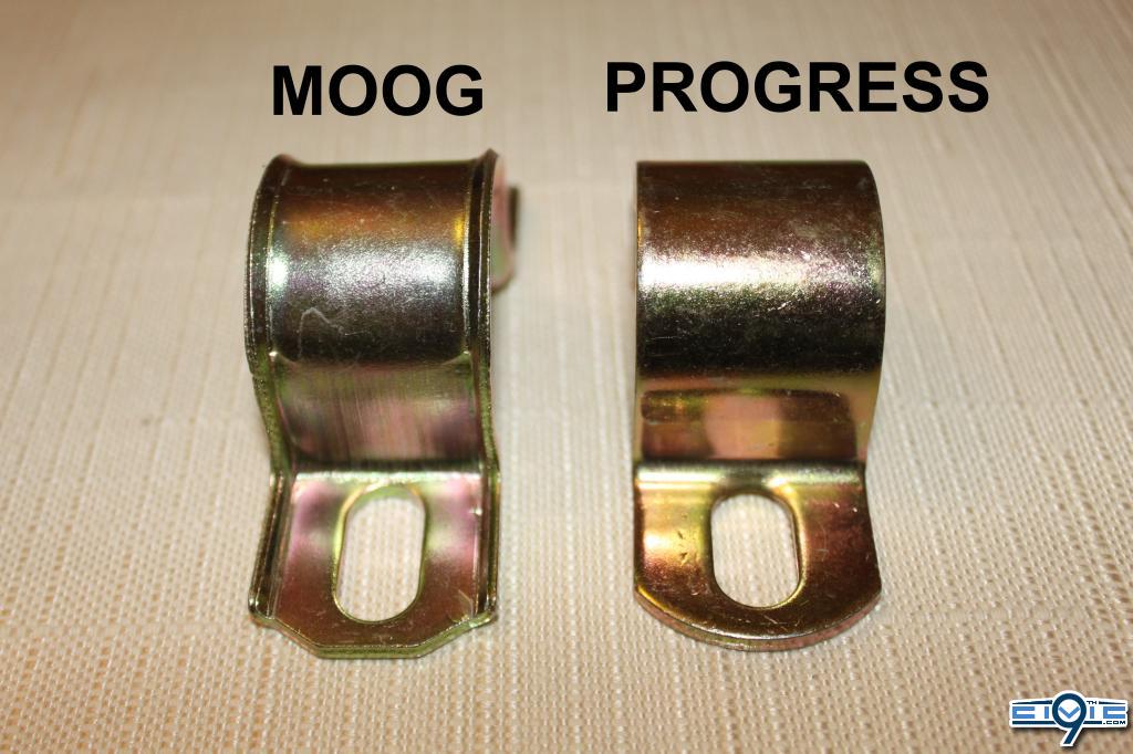

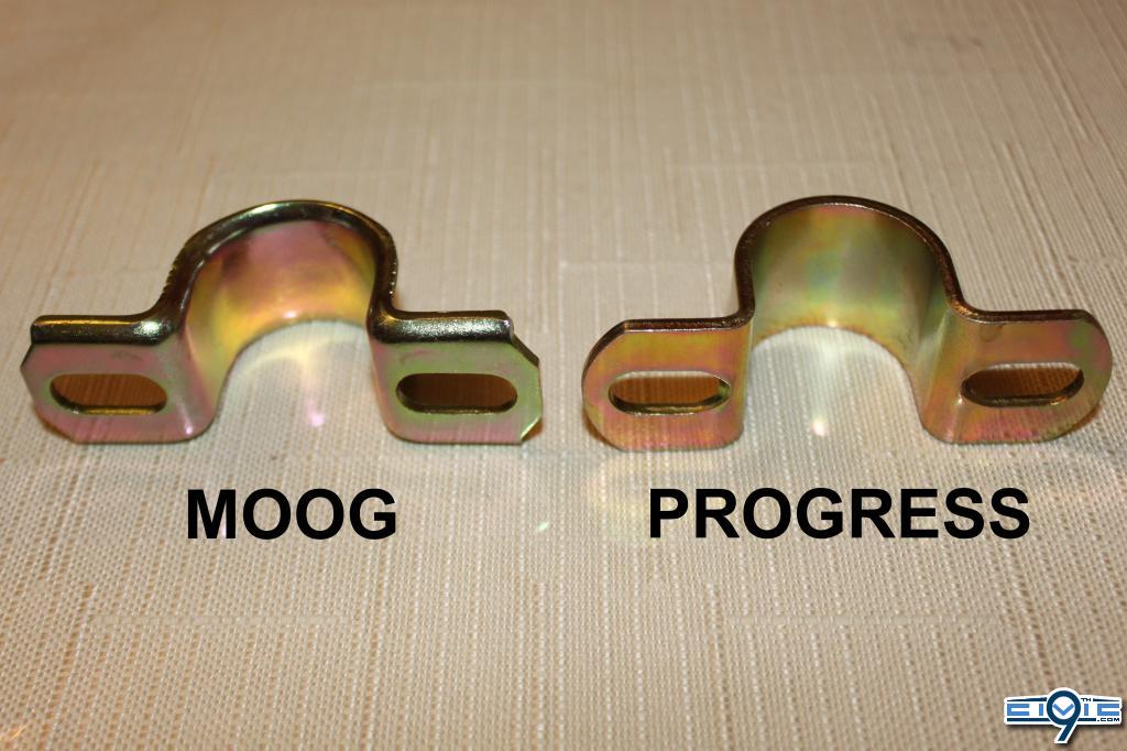

Both bushing/brackets are very similar in size.
Both brackets have slotted holes with the same offset so fitment will be the same and no modification will be required.
The MOOG bracket is stiffer and more reinforced with the curved edges. Less flex on the bracket.

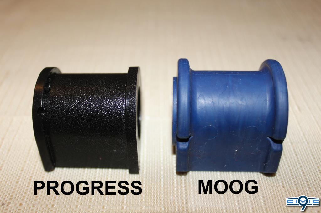

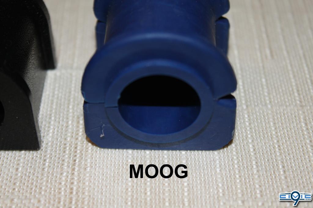

The MOOG bushing is wider.

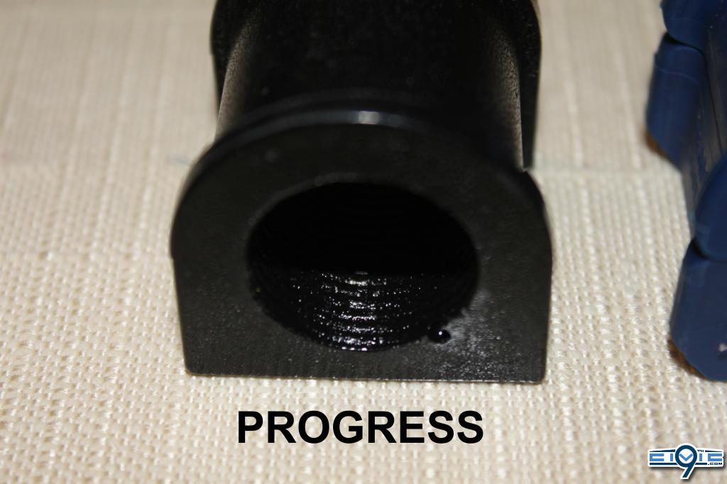

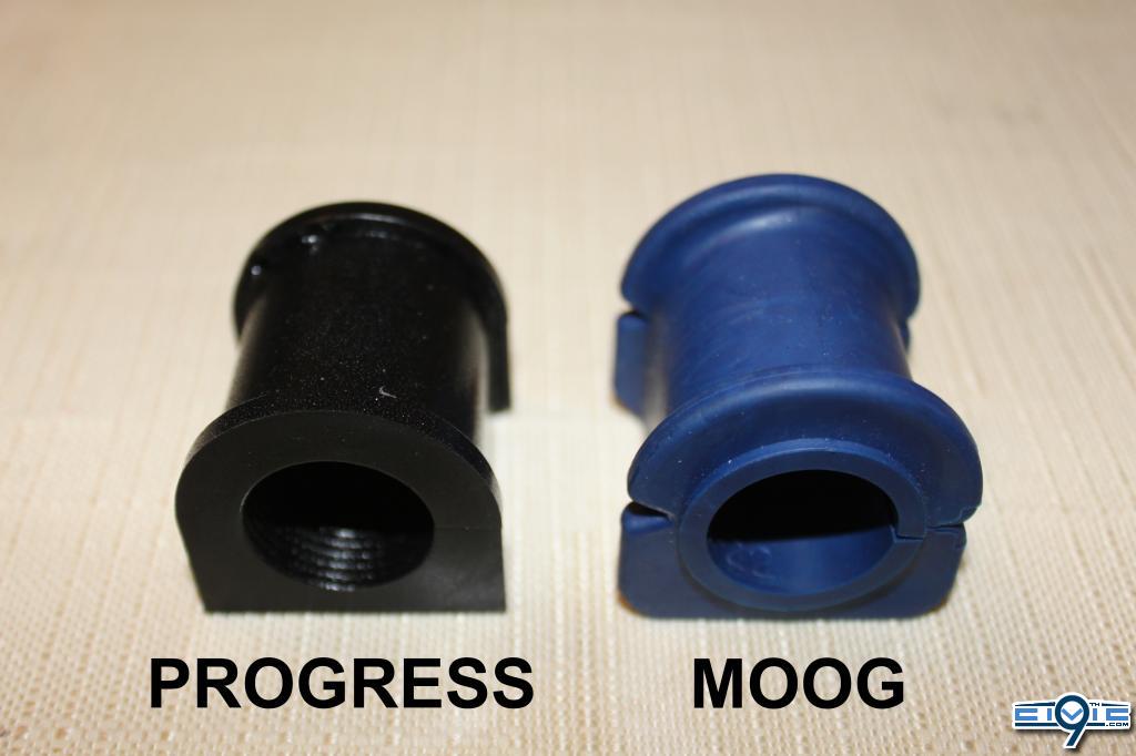

Progress bushing has ridges in the hole. MOOG bushing is completely smooth.
Im guessing the ridges in the Progress sway bar bushings are for the grease to seep through.
In my opinion, the MOOG bushings/brackets are great upgrade for upgraded sway bars. With the stiffer material, there will be less sway bar play on the bushings. This means that the bar will be clasped on tight and the bushing will always remain compressed. The MOOG bushings also do not squeak or require lubrication because of the high abrasion resistance.

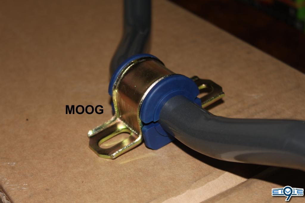

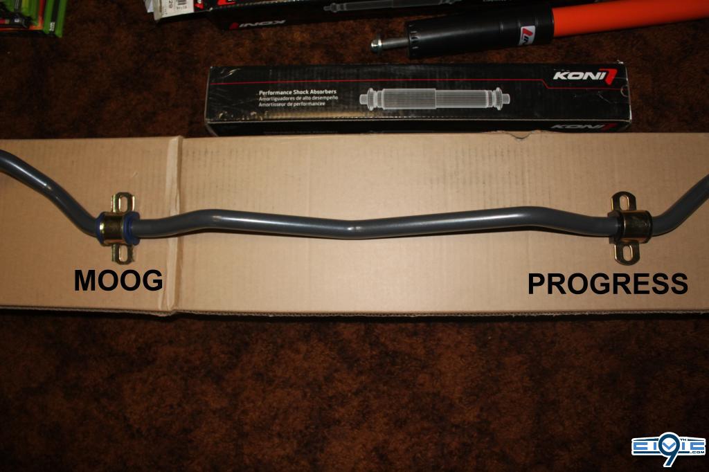

Test fitment on the sway bar:
Both sway bar bushings have the same amount of gap when uncompressed.

For those people who prefer to grease (instead of teflon tape) their bushings, the Progress version is going to have longer service intervals due to that bushing design.
Why? - Take a look at the inside of the Progress bushing, the grooves in bushing will help keep the applied grease in those channels.

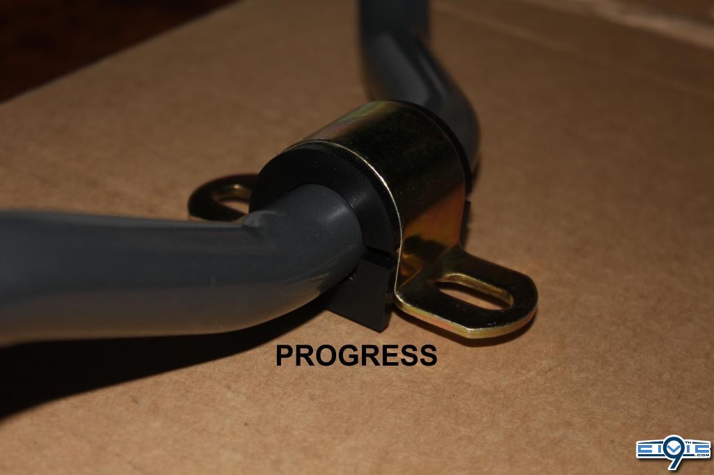

These are reference pics of the 22mm installed on immajackuup's 2012 Civic Si:
You can see that there are gaps on each side between the Progress bushing and the stopping plates. With the MOOG bushings, there will be less horizontal movement on the sway bar bc the MOOG bushings have a little bit of extrusion that will close those gaps. The fitment will be snug.

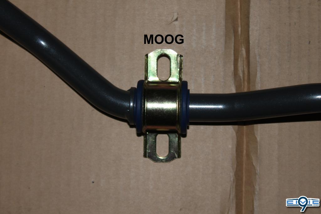

***UPDATE***
I installed the Progress 22mm RSB with Moog bushings/brackets installed. The MOOG bushings left zero gaps by the stopping plates. The fitment looks perfect and I just need to take the car out on a spin.

I just drove the car around for like 5-10min. There were no squeaks at all with these non-lubed bushings. I was literally driving over bumps, small potholes, and bumps formed by compressed snow. And it's 25F outside too.
