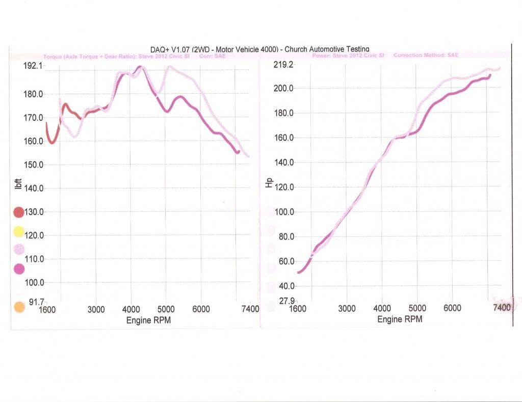

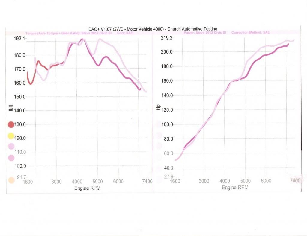

Here is a dyno sheet made on Church Automotive's Dynapack.
The performance modifications include: RV6 2.5" DP, ported stock IM runners, some sort of custom exhaust, and an Injen CAI. According to Chruch Automotive's website, the (or their) Dynapack loses about 20-25 horsepower between the flywheel and the hubs on a manual transmission-equipped FWD car. So, with this car reading 219 horsepower at the hubs, we can assume it has anywhere between 239 and 244 flywheel horsepower. Assuming there is about a 12-14% drivetrain loss, that'd be anywhere between 205 and 215whp. With those mods i.e. the restrictive (when compared to the Ultimate Racing 3" unit) RV6 DP, stock IM and throttle body, and that intake, that would make perfect sense in relation to an eDyno of a comparably modified 9th gen Si.

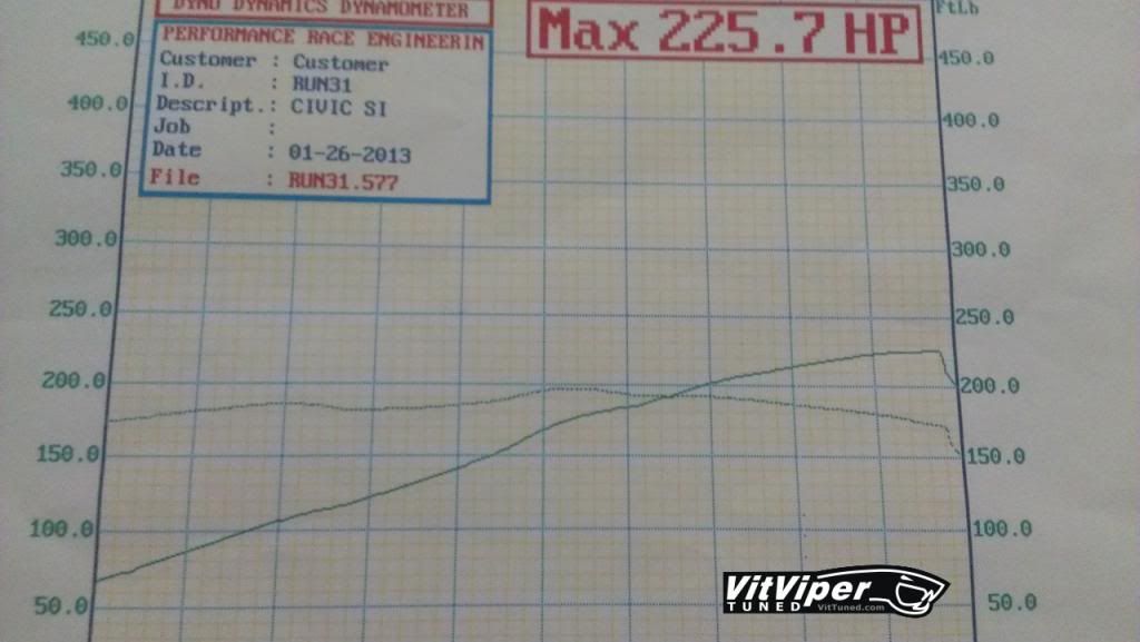

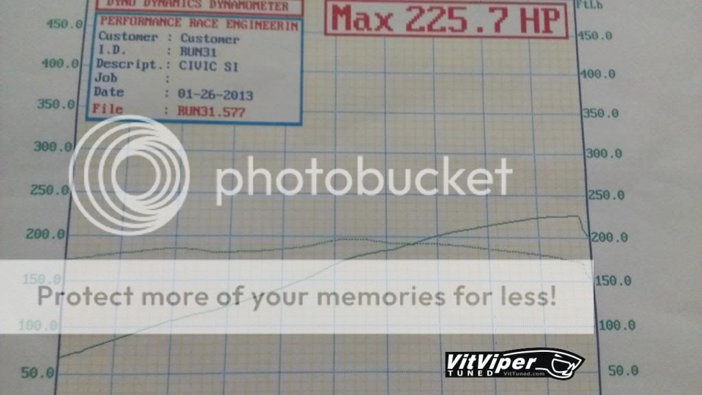

Here is a dyno sheet made on VitViper's Dyno Dynamics dynamometer.
Performance modifications include: Ultimate Racing 3" catted DP, Ultimate Racing 3" exhaust, RBC IM, and 8th gen AEM CAI. This particular dyno pull was done with E85. This car reportedly made 218whp on 92 octane. Once again, with that restrictive stock throttle body and a high-flow cat (probably loses about 3whp or so), this is right on par with comparably equipped 9th gens which have been eDyno'd.
