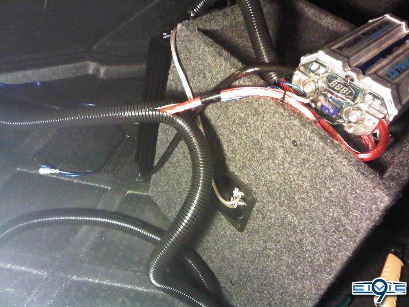

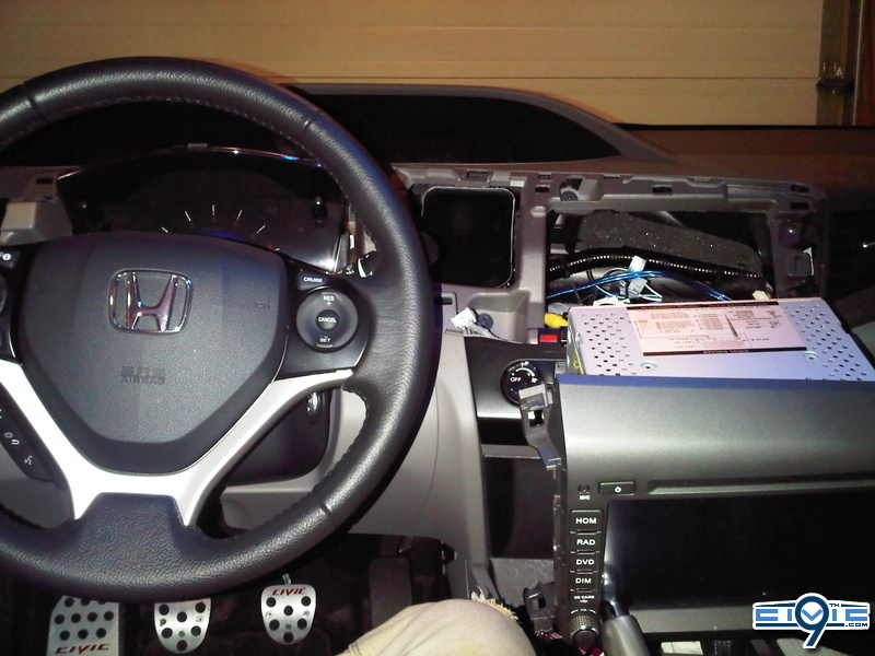

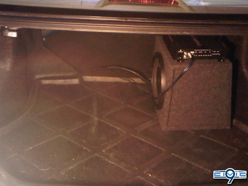

hi, im gonna do a quick walk thru to wire a SUB up in a 9th Gen..

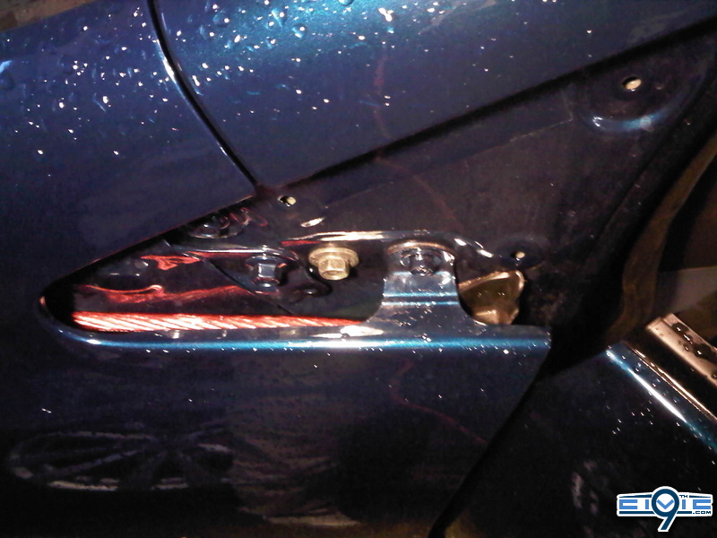

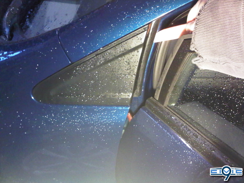

first off gotta plumb the power wire. you can pass the wire thru the door panel.
inside theres a hole, its up behind stuff, hard to find, but its there....

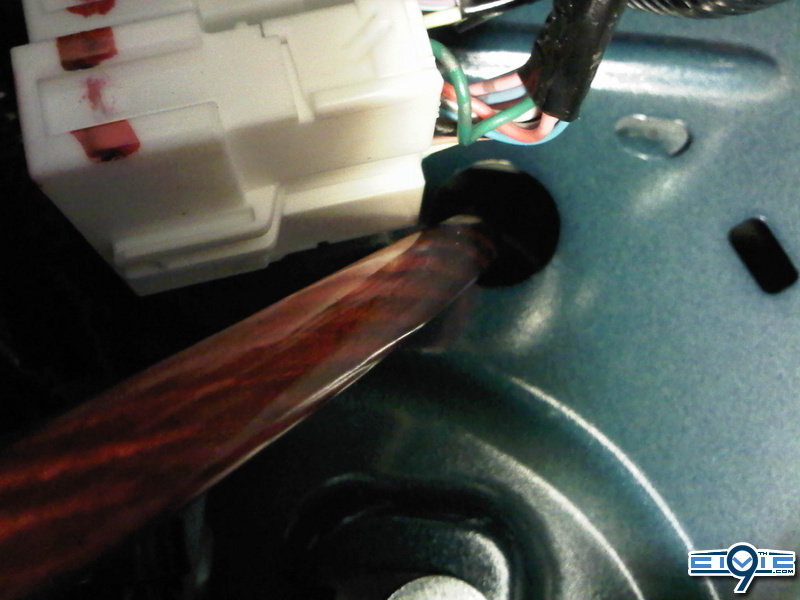

pass the wire thru the fender, its a little easier if u remove the little plastic V...
the only screw you have is the one on the door trunk lock, everything else just clicks apart...
sorry a seem to have lost those pics.... did i not save them on my fone????? ugghhhh
anyways just run the wires along the other wires all the way to the trunk....

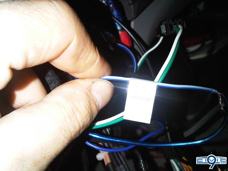

i have an aftermarket NAVI, so it made it alot easier for the remote wire(AMP CONT)im guessing its the right one.. lol
the dash pulls aprt easily if you have nylon interior tools... do not use a srewdriver.. go spend $3 on eaby and buy a couple flat nylon interior tools, they are amazing!
sorry i wasnt as in depth as i could have been, but i do hope to have helped anyone whos thinking about it, where to start etc..... its a relatively easy process, can be done on a saturday... :D

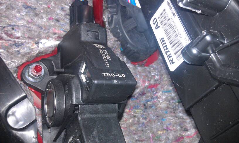

Nice pedals :)
thanks jason, they're actually for the 8th.. eBay... grrrr....... coz the gas pedal is totally wron... maybe will have to break down and spend another $40 to get the right ones... lol lucky tho alot of things are swappable and u can make shift work... lol

Good guide but just a suggestion, there is a grommet you can run the power through above the gas pedal. I would only use the door jam temporarily. Too much of a chance for seeing the wire and it possibly shifting to the hinge and you closing the door on it causing a very damaging short.

no problem webby.. :) i never knew that Bulkybear, I'll have to take a look and maybe do that.. altho i understood alot of 8th gen'ers have done the same thing as I have... but I dont think it really rubs, but who knows over long term.... ? hehehe

The reason I know is because that's exactly what I did lol. But the only spot I could find to transition the cable from the door jam to inside the car was just passing it over the door seal and letting the door shut on it. I figured its on the seal it won't hurt it. But after a while it started to put a flat spot in the wire. And I hated that part of the wire being visible when the door was opened. Even if you found a spot in the door jam I don't know about that prevents that I just get uneasy about wires through door jams lol. Not trying to harp on ya. Just a suggestion.

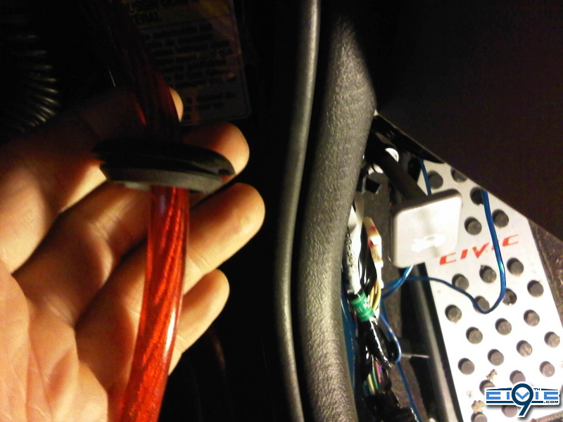

totally agree on not wanting to look at it Bulkybear ..... but sorry i have no idea where you are talking about with the hole near the gas pedal, could you please upload a pic so we all can see... mucho gracias mi amigo :)

It's that rubber grommet in your pic to the right of the connector at the top of the pedal

oooooooh.... i tried that one.... poked a knife way in there.... but then said forget that....im scared of cutting a wire...... so how did you do it?

Long screw driver. Taped the wire to in and pushed it through the side from the engine bay. Then went inside the car untaped it, pulled the screwdriver out and fed the wire through.
