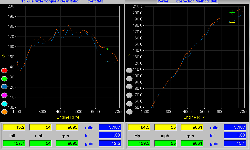

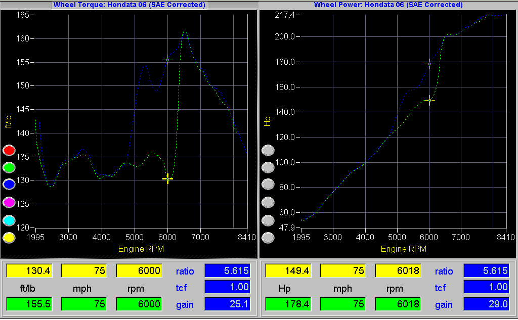

look at the torque line on the 8th gen - on the left...
compare that to the torque line on the 9th below left
There isn't a big kick in vtec sound, because there isn't a major change in power (like the 8th). Plus, there isn't vtec on the exhaust cam.... just the intake cam on the 9th gen. There is a lot more useable torque down low on the 9th.
