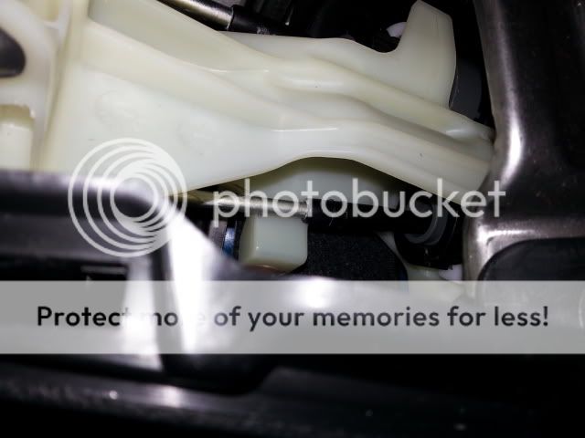

One thing i know..is that IT WILL work WITHOUT cutting the plastic part! Im just scared that the cable will touch it!! I also know that there is not 2775748way to shorten the throw of a shifter... its to get the bottm part longer...which makes the cable sit LOWER and CLOSER to the bracket! So what i think its that cutting it is NOT required but may be recommended

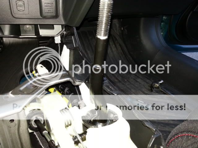

! I just finished the complete installation (shifter shaft, base buishings, cable bushings) of the final version of the BPS Short shifter into my buddy's SI
NO trimming OR cutting Needed of the shifter box!!!!!!!!
Not the best picture but you can see the bracket is still present!!

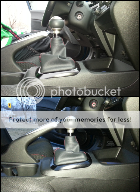

Before/after shot

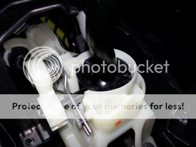

In the middle of installing.... Had the hardest time with the metal push clip that holds the arm that the spring in place. Also, my cable is slightly touching the plastic bracket. Im not going to cut it now. But will keep an eye on it for the future. Other than that one clip, everything was slow, tedious but easy.
