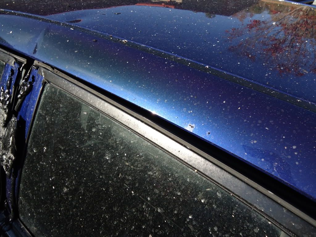

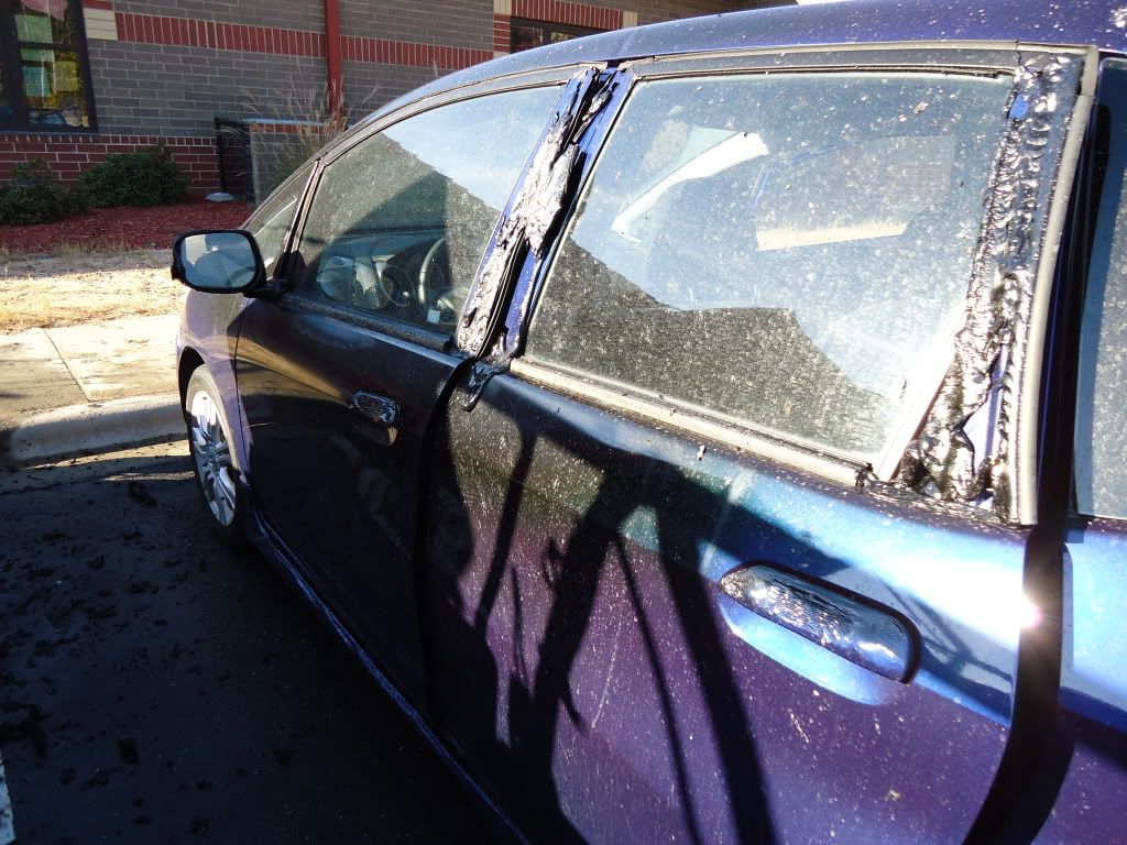

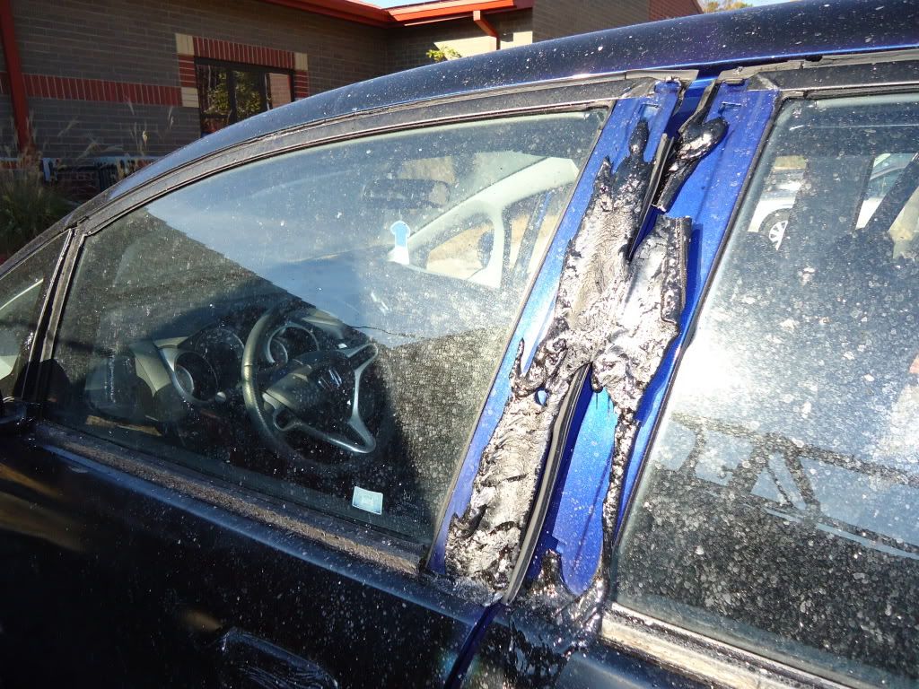

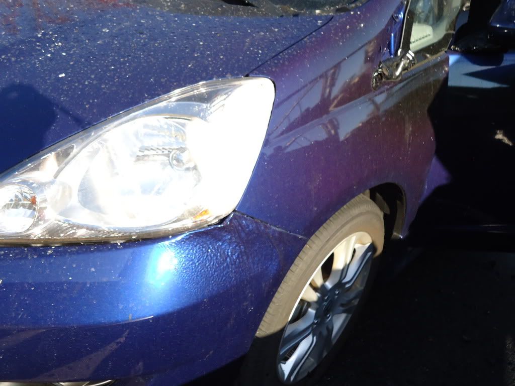

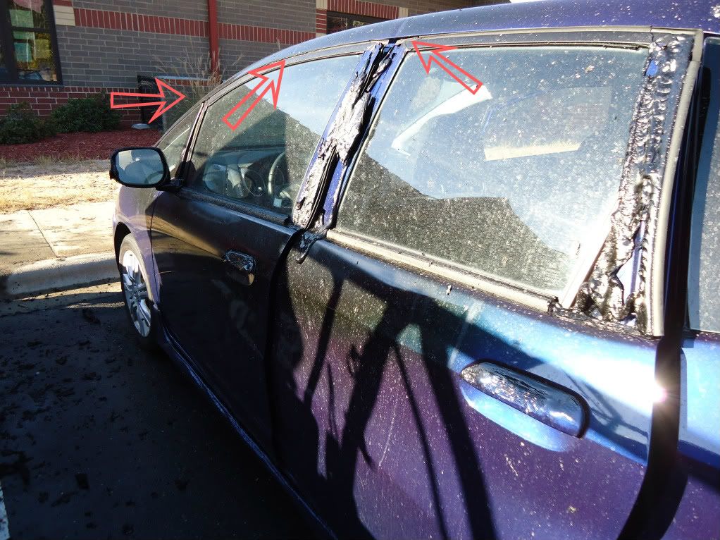

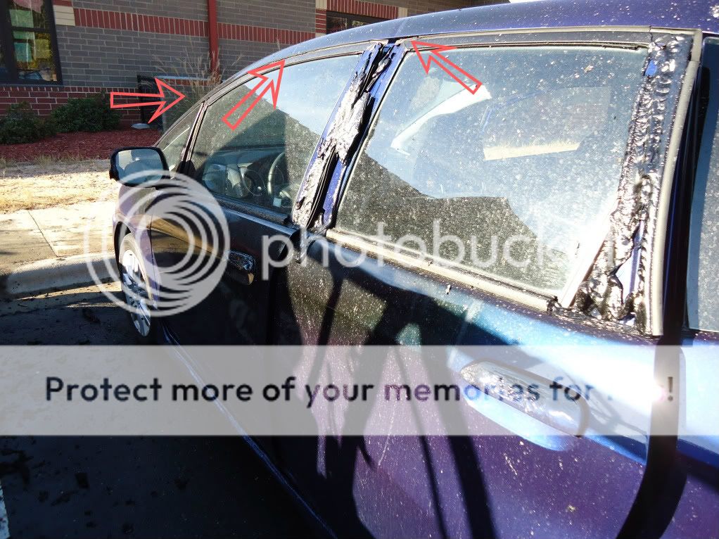

Ok, no...not mine but still, lol My sis-in-laws Fit sport was parked next to a newer odyssey which just happened to burst into flames somehow and I am trying to get opinions on whether you all think is it is a write off. We are hoping so since it is a 6 month of car and who wants to be stuck with a car that has "fire damage"
Here is the aftermath of Fit.

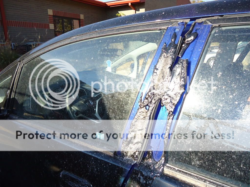

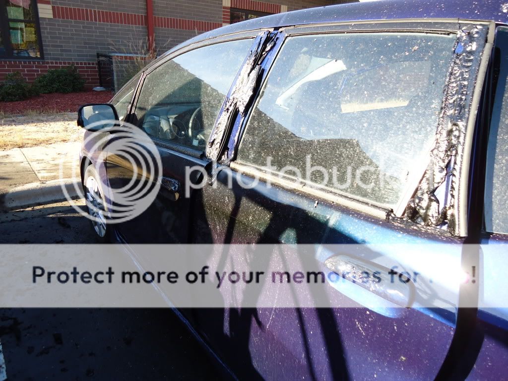

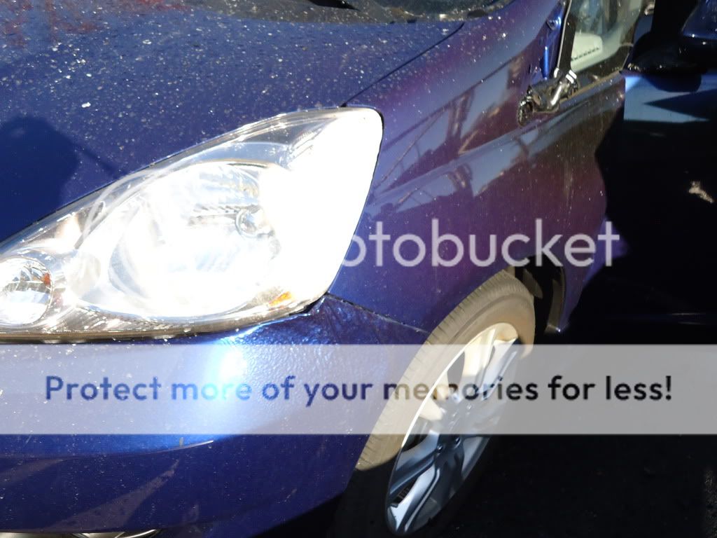

As you can tell the whole driver's side is eff'd. Paint is all bad, all plastics melted, headlight and front bumper are done, the door seals are bad and from what I am told the car STINKS! and the plastic wheel wells are also bad. I think that first pic might be the saving grace. Looks like the b pillar collapsed downward which caused the dent in the roof and the metal section above the doors. I am told the doors don't close or just don't close all the way.

totalled - in my opinion.
front bumper replace / repaint = close to a grand +
headlight - probably 200+ parts from honda
entire side repaint - not sure price, but expensive..
door handles, plastic window trim... all gone
rubber vinyl around all doors - gone
the roof line / pillar cause some concern.. could probably be popped back, but then again, you're talking about repainting the whole roof/pillar
I wouldn't be surprised if things warped from the heat on the doors - causing them to not shut right.
smell/smoke odor out of the interior is another whole ball of wax..
I wouldn't be surprised to see them write it off - sucks to see that happen. Do they know what caused the fire?

My dad glanced at it and doesn't think it's totaled. They'll probably slap two doors on it..and a bumper..but we didn't read into it much...and he didn't look too much at the pics.
His quick guess was $2200 in damage if the doors could shut..lol
just painting a new door will be a few hundred each - without the cost of a door (if it has to be replaced). They'll be repainting both doors, the front and rear quarter / hood / roof to blend - it'll be well over 2k. New front bumper / repaint / labor.. another grand
roof dimple / pillar wrinkles - will take labor hours to fix/fill/sand/repaint
