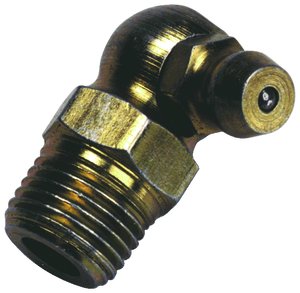

    Or you can buy some spare Zerk fittings and put an angled one in.
    [​IMG]
