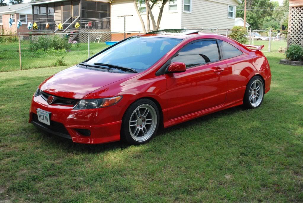

I am an RPF1 whore, had them on my SI. I hope your fitment is much easier than the massive issues I had. I had 17x9 +35 with 245/40 Star Specs. Got sick of running -2.5 camber and still having occasional rubbing, so I sold them. Here was mine:
How much fender work. Just a fender roll or did u have to get them pulled also? I'm running H&R springs and was planning on getting varrstoen 17x9 +30.
Just a roll in the rears, depending on what tires you get you'll rub, I'm running 235/45 and my it rubs slightly on hard bumps to the rear.
