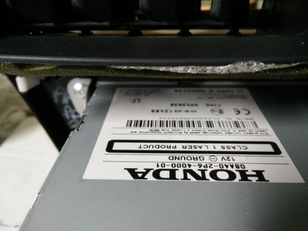

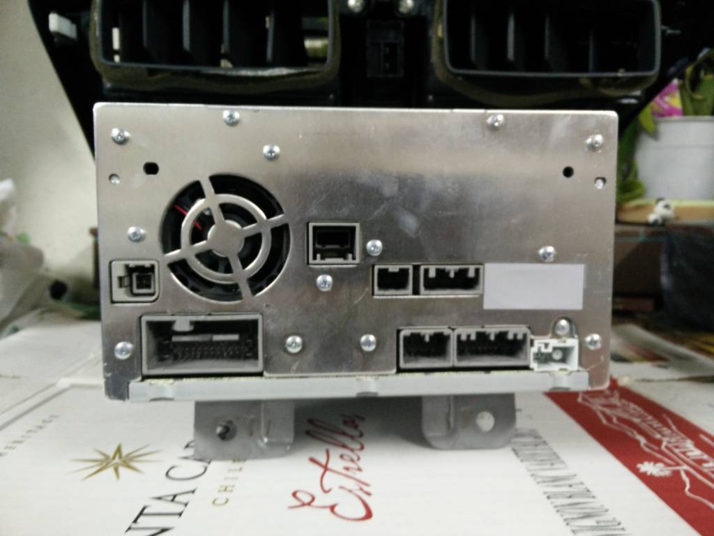

Do you guys have a wiring diagram for Honda SD navigation unit?
I have this installed in my Civic IX (2012 EU) as an option and the whole car wiring seems to be different from all Civic diagrams.
I need to know wires for wheel buttons (I have Joying unit installed, but without volume control).
Thanks in advance!
Thanks in advance!
A huge majority of the users on here are from the United States and Canada. Unfortunately, different countries outside north america have differences in parts and wiring. I know there is a forum called civinfo that caters to civics in europe/uk and so on. They may have some wiring diagrams available that may help you out. Sorry http://www.civinfo.com/forum/9g-general-discussion/
Thanks! I'll check it out.
