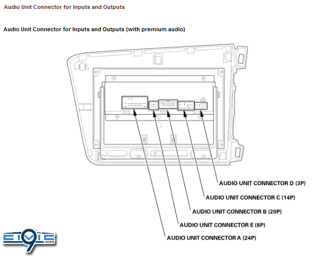

2012 Civic Audio Wiring Guide & Pinouts For Factory Radio
Hi I’m having issues with getting power to my amp/sub. I’m using a LOC behind my head unit and for some reason can’t get any power. I’m certain I followed the diagram correctly and my head unit as well as all my stock speakers still work. I even rerouted the power line on the LOC to a fuse tap and still nothing. Anyone have any suggestions?

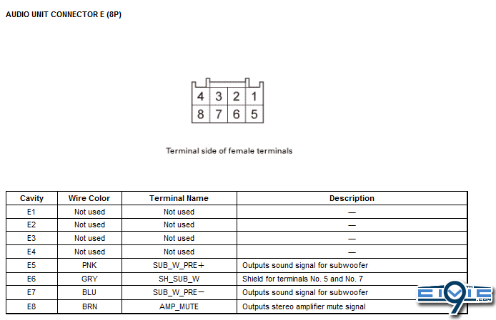

@webby trying to finish up my wiring for my system. Is the output the source going to the speakers? I cut the harness to the out and don't have sound.
like you cut the harness that goes out from the amplifier, or I'm confused. I'm not sure what your setup is or what you're doing
I cut the harness where the amp was to wire in my 5 Ch amplifier and was trying to figure out if the what they were saying was output signal was the actual output to the speaker.
I ran all RCA cable from my new head unit to the amp and I was trying to run the new speaker wire to the speaker and I was trying to tap into the original outputs going to the speakers instead of running new wire through the doors.
