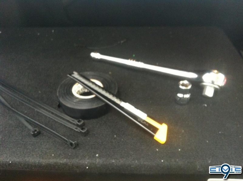

First you will need the tools!
Rachet+10mm bolt remover
Tierap(at least 4)
Philips screw driver( the star one)
electric tape ( if needed)

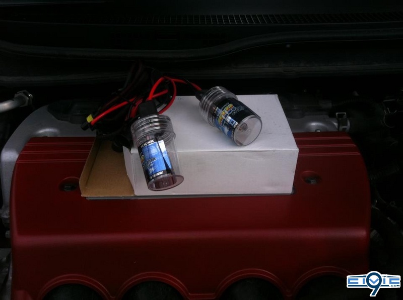

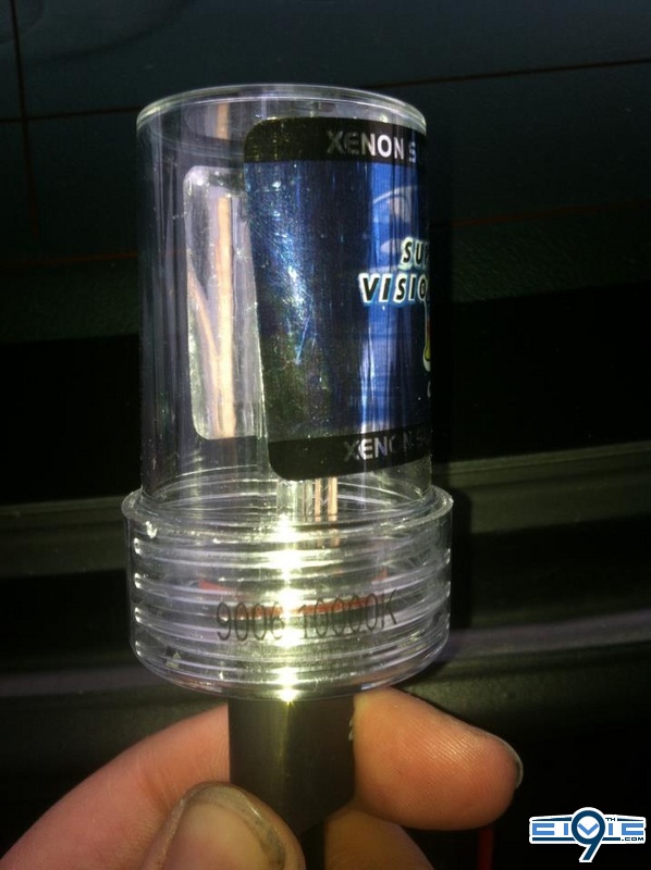

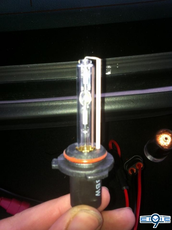

the kit you will need its 9006 single beam Hid Kit (in my case i put 10000k :) )
1- First find where are the holes

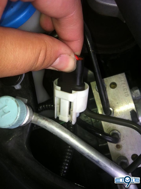

2-Turn the plug to the left and remove it gently
3-Remove the light from the plug

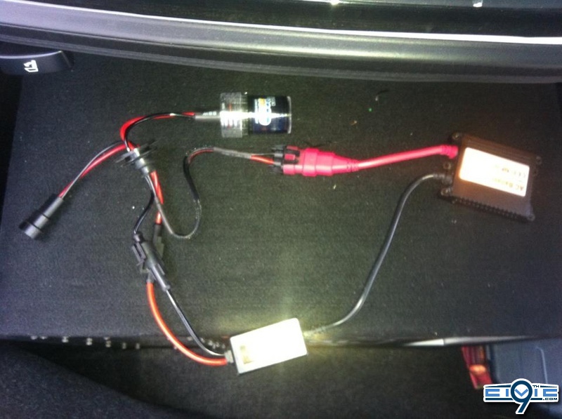

4-Assemble all the kit together

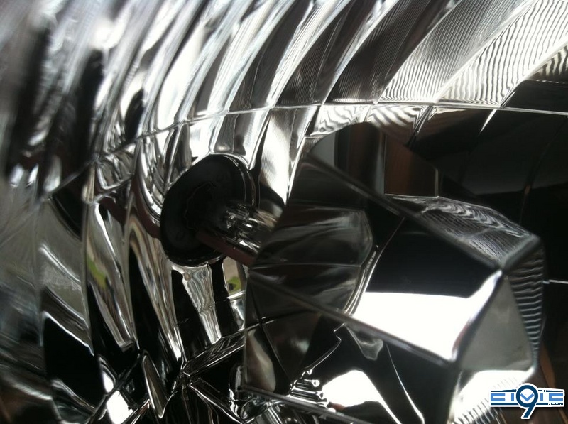

5-Remove the Bulb cover and insert inside the Headlight----BE CAREFULL TO NOT SCRTCH THE BULB----

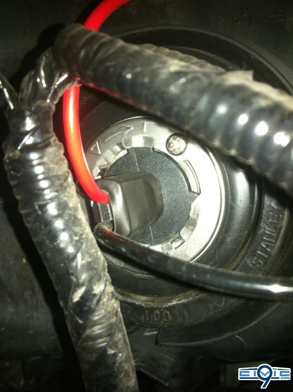

6-Connect the power wire to the HiD plug power

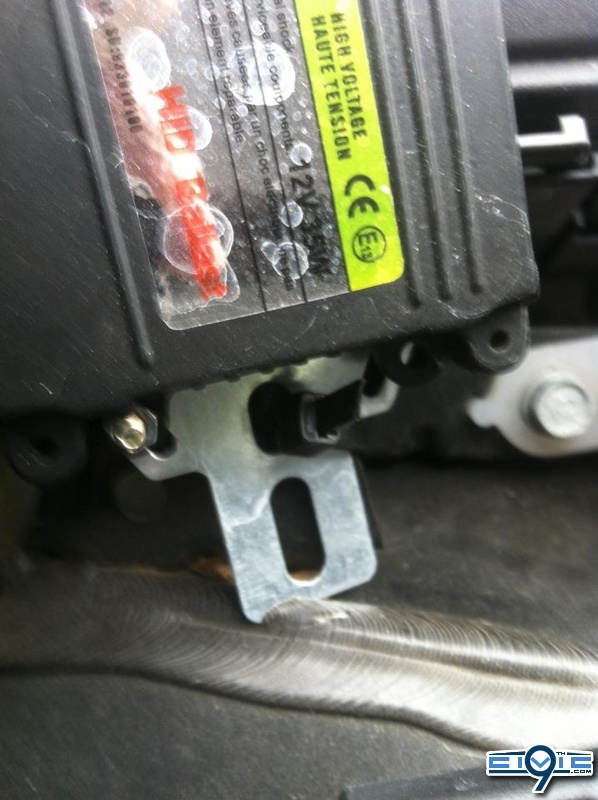

7-tierap the ballast firmly to the frame
it can be many way to tierap the ballast in your car.***

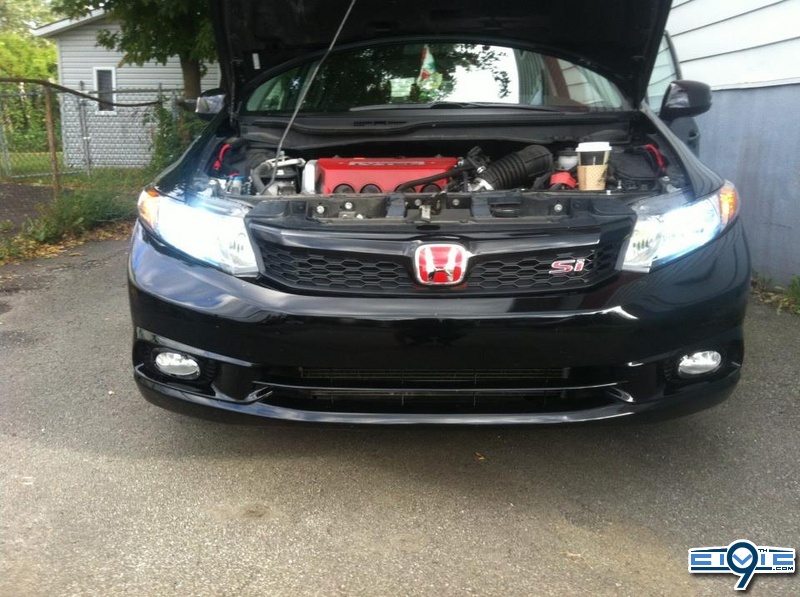

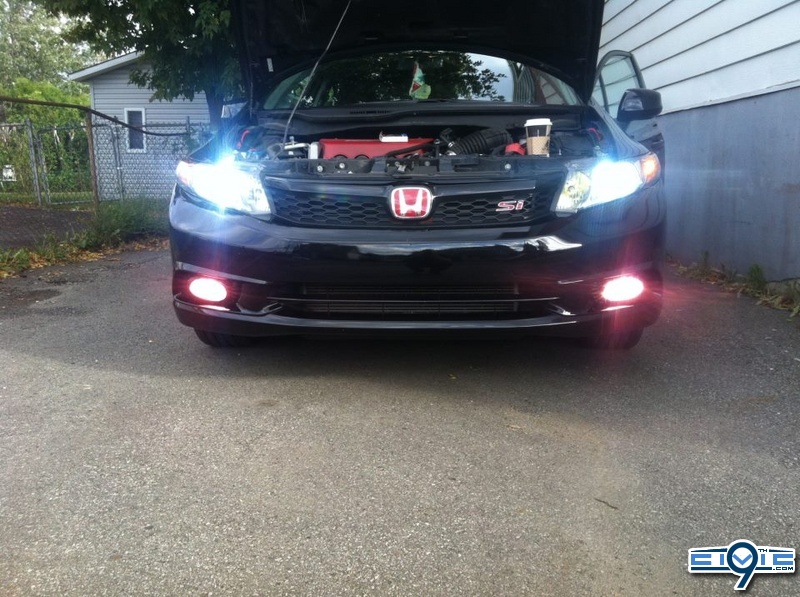

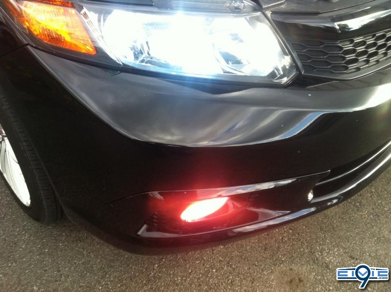

8- Test your new kit!

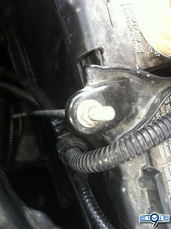

For the battery side... if you want more room to work, remove the bolt that retain your battery.

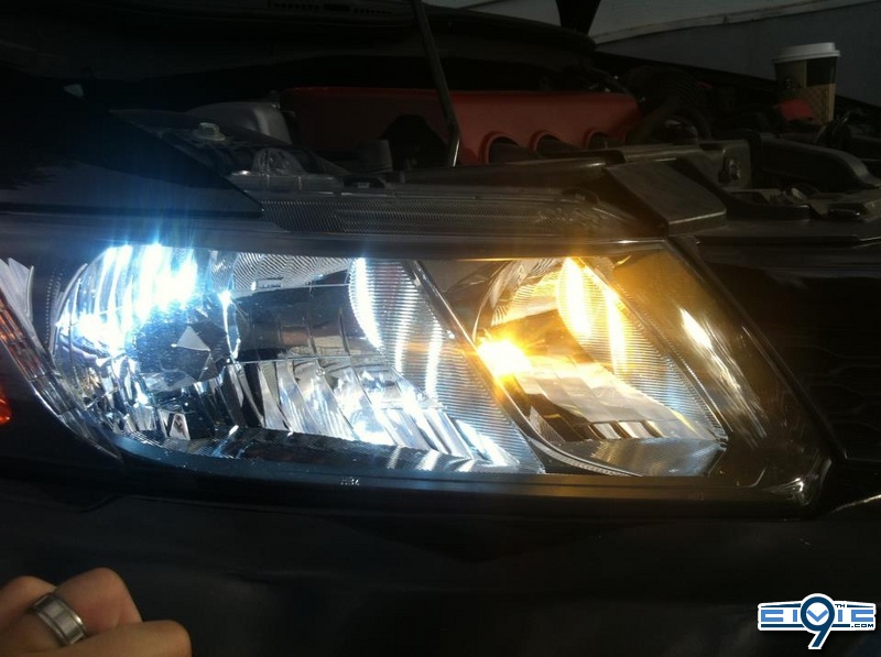

Finaly ...ENJOY your work!!

what side are you having trouble with? battery side I would take the battery bracket off and slide the battery over some to get your hand in there and with the abs side you should be fine maybe use your left hand to make it a straight shot
Thanks. I was attempting with the driver side, because I was able to get the fasteners off my intake cover easier than on the other side. I was actually contemplating moving the battery, but I was apprehensive of trying in the dark/cold. I had to take out the battery to put in the HID's in my 8th gen. Can I move it enough without actually disconnecting it? I'm not keen on actually pulling the whole battery out. I will if I have to though. Also the fastener thingy on the wiper fluid reservoir on the other side.. how do i get that f@cker out? It's starting to tear and I really don't want to break it. Derp.
with the battery you can move it with out disconnecting the cables and for the other side S*** sorry forgot about the washer fill theres a a push clip to remove then the piece will pull out
