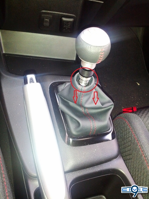

Tools needed:
9/16 open end wrench
Flat head screwdriver - possibly

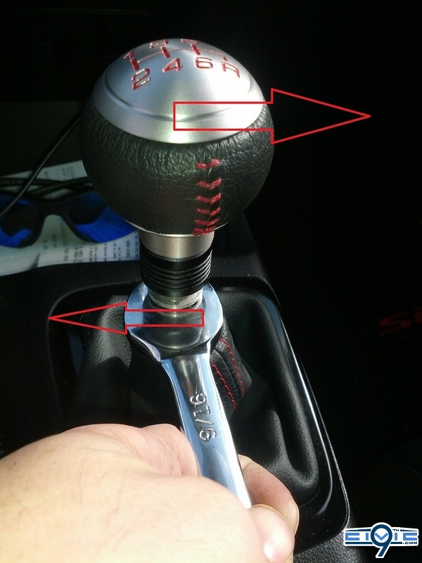

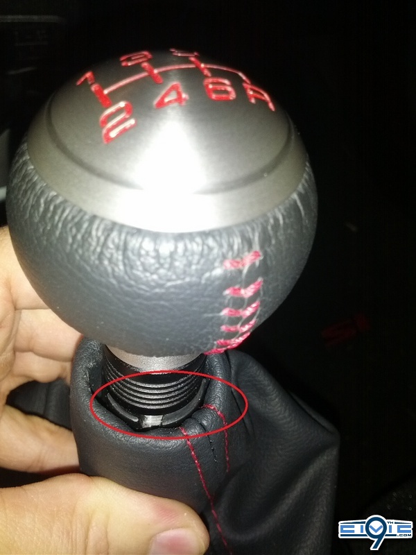

1. Remove the shift knob by pulling down on the shift boot. It will not simply pull straight down. I found it is best to pull down and angle it slightly and work it from there. You may find it easier to use a flat head screwdriver and pry the clip loose while pulling it down. Once the boot clip is off, use the 9/16 wrench on the retaining piece for the shift knob. Turn it right to loosen it. Once you have done this, you can turn the shift knob to the left. It will take about a dozen full turns to get it off.
When putting the knob back on, you will want to screw it back on as far as it goes and then position it so the image lines up right. After you do that, then you will want to hold it in place and tighten the retaining ring to keep it in place.
Note:You want this to be tight so it doesn't come loose mid-shift!

Holy ****...I think when I was trying to take off my shift knob...I didn't detach the boot and just kept twisting. So I think I broke the black retaining ring...I've tried a dozen times and a dozen different ways and now my shift knob won't align correctly.

Heed his warning people. Mine does the same thing...My retaining piece doesn't even come off with my shift knob even after I disconnect the boot from it. The retaining piece barely even twists on and when I twist the knob back on...it like pushes the retaining piece down even though it's twisted tight...that's why my knob won't align straight. I'll make a video of it sometime soon.

Basically what Monk said. Screw the knob all the way down and then spin it up until it is aligned. Then hold it firmly and lock it in place with the retaining piece.

Does the factory shift knob seperate from the black collar or do you need to pull down the boot to take off the factory knob, I saw the diy on it but I thought someone said that if your just replacing the knob it seperates from the black piece below it, any help would be greatly appreciated.

You need to pull the boot down in order to loosen the black retainer.You will also need access to the bottom portion of the black retainer for tightening purposes when putting a new knob on.

I'm pretty sure what they were saying, is that they didn't do it correctly and forced it off, and like squiggy said you need to pull it down to tighten the retainer when replacing the knob.
