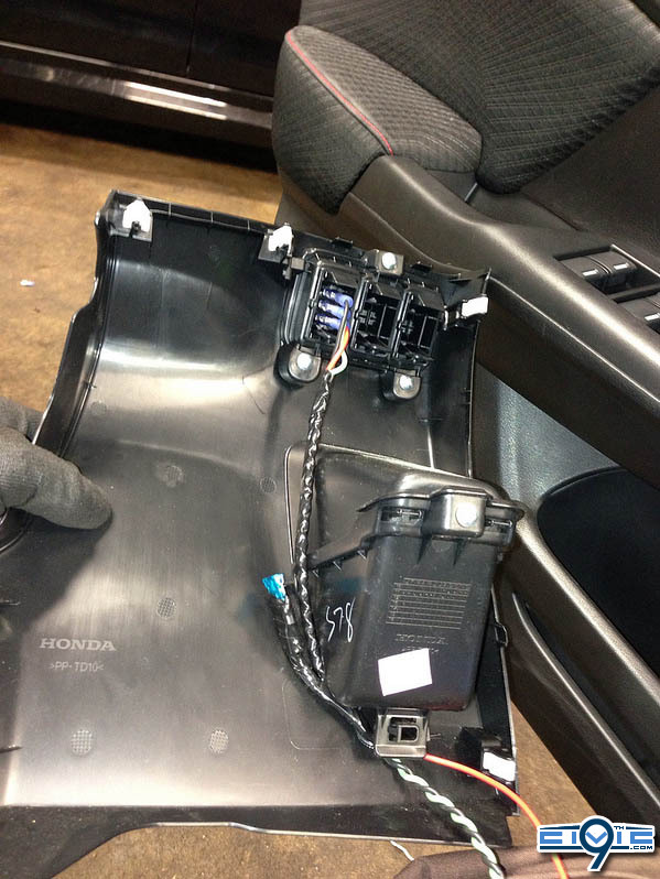

    I did this on 2012 lx sedan oem fogs and switch.
    photo 1.JPG <- No lights
    photo 2.JPG <-Fogs Only
    photo 3.JPG <-Fogs and markers
    photo 4.JPG <-Fogs, Lows beams, Markers
    photo 5.JPG <-Fogs, Lows beams, High beams, Markers

    This is exactly what I wanna do with my car, I hate having to drive around with my lows on just to turn on the fogs. Im also wondering if it can be done by using the factory switches? A detailed DIY would be appreciated

    ^ Agreed. I'm not into hacking my factory ignition wire and having another non oem switch (Have one already for my amp). I don't mind having to run my markers to run my fogs if it means I can use the stalk to use them as opposed to a separate switch altogether.

    We t tap the main ignition wire with the wire we used with the male spade connecter?
    What do we wire the switch with?
    Where does the relay go?

    you can also always buy factory switches. i have 3 of them...

    What kind of relay was needed for the independent fogs?

    40A

    Just a 4 pin 12v automotive accessory relay? Sorry I have no knowledge on relays, thanks for the help.

    sorry for the long response time. Yes 4 pins. 12v of course because all automotive electrical is 12v dc. One for in, one out, one common, and a single ground :)
    You can get them at any automotive shop :) A lot of them have 30A inline fuse and 40A capable relay :)
    Any more questions, you can request an electrical diagram here:
    http://9thcivic.com/forum/threads/electrical-work-inside-outside-your-car.6919/

    One quick question on this where is the 15amp fuse going ? I am just really lost today....

    he uses it as inline.

    Ya still lost with that spent about 4 hours cooking in the sun trying to figure this out.

    you understand how the wiring works though right?

    I have the general idea but he was not very informative with the DYI

    i guess it requires you just have a basic understanding of electrical.. i don't want to have to rephrase everything...
    but he uses the fuse on switching to avoid using another relay. Inline fuse to ensure the switch doesn't get over amperage.
