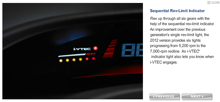

I pulled the 5k vtec quote from a press release, but I see that's wrong as well.
5,200-7k = ivtec indicator
Thanks, guys... you do great research. Those lights are pretty, for sure, but when they light up I generally have other things on my mind!8th car - first SI owners nov/dec 2005
