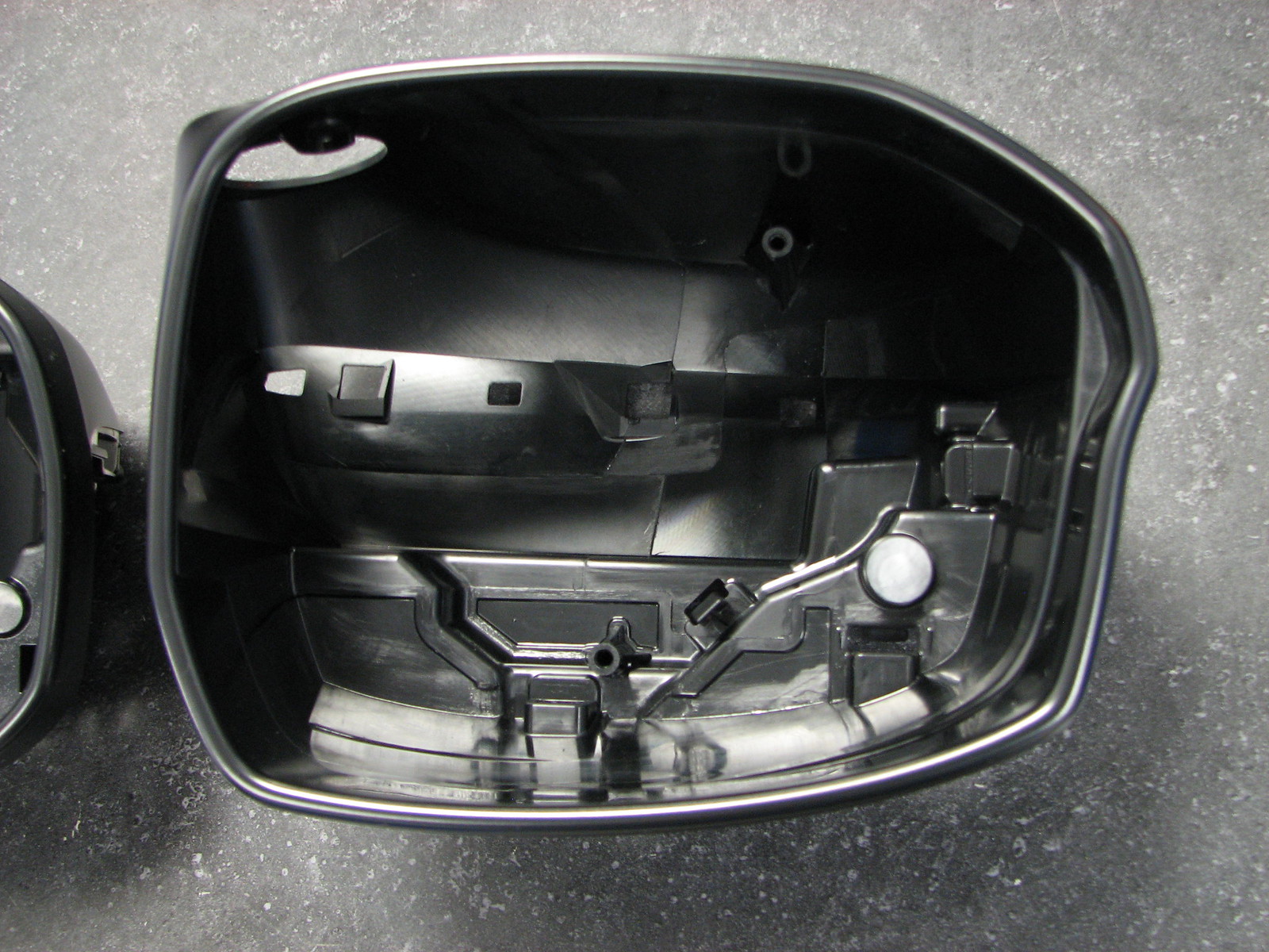

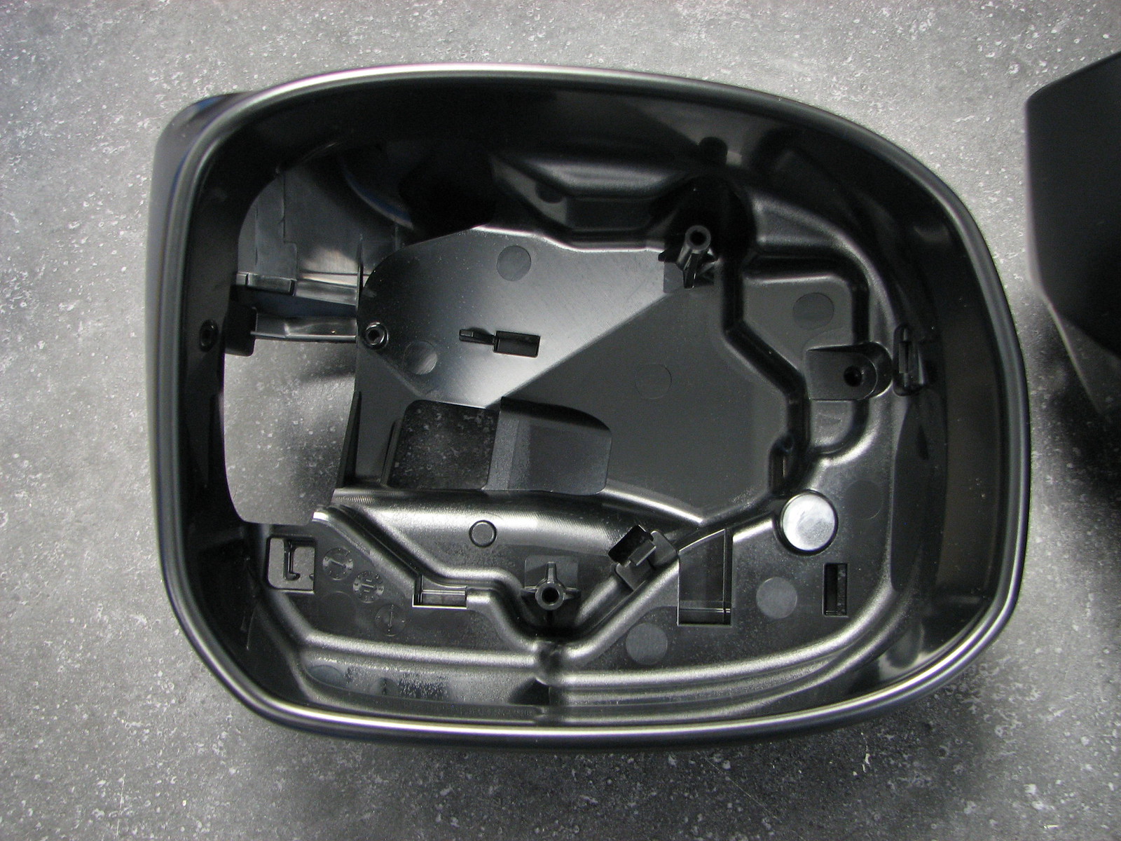

My theory is that if the bolting points of both housings and the bottom hole are the same, the most expensive part (mirror core) can be reused, making this mod cheaper.

Very good pictures indeed. Thanks Paul.
Seems like the same mirror core can be fixed in both housings. At first sight, I was baffled why the depth of the screw mounting was different on both housings until I checked the picture of the front part of the Hybrid, where both parts of the Hybrid housing have to be screwed at the same place.
Can CollegeHills Honda please check if am I rightl? Thanks.
Hybrid housing is different from non hybrid due to the LED Part that is mounted on. Parts ordered is about 190$
