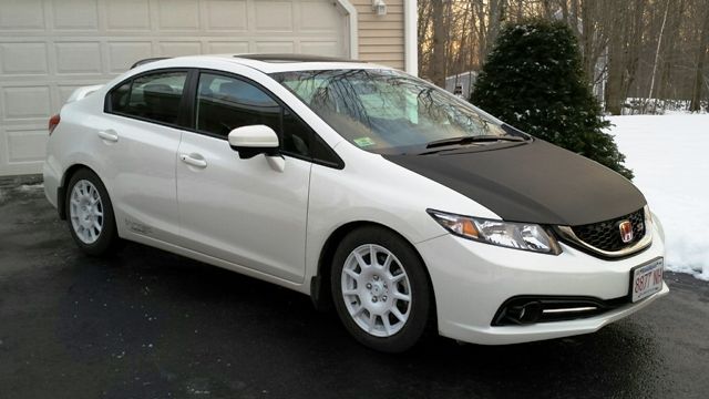

Just my 2 cents but I think for the real world everyday driver the Eibach Pro kit is perfect. It gives a perfect drop and pairs well with the stock dampers. Any lower/stiffer and the ride gets harsh and the dampers can't keep up with the stiffer spring rate. This is my 3rd successful application of a pro kit. I ran a VW CC 120k miles on Pro kit with great success and the stock dampers held up well even on crappy New England roads. Also, use the Honda bump stops. The Eibachs that come with kits are universal and fit loose in the spring perchs.
