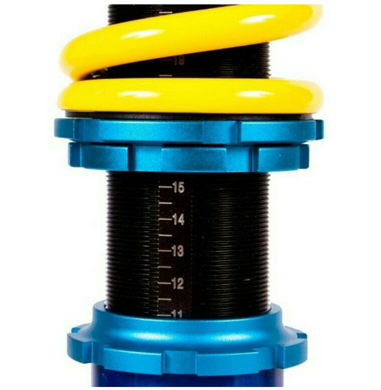

I wish my coils had this feature... All coils should
