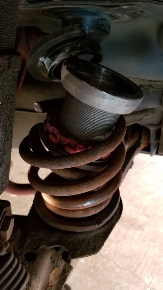

I've been driving through some rough construction back and forth to work everyday for about 2 weeks now along with some construction on highways around Chicago, and last night my rear suspension collapsed. So I just placed an order for Tein Street Advance coilovers, and they should be here soon!

Found the problem with my suspension
