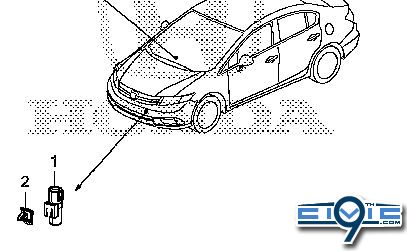

I'm curious, on the CIVIC Trims that have this sensor already, where is OEM location installed?
Thanks.
Thanks.
This what you mean? Behind the front bumper
Is there a pre-drilled hole for the bracket to fit into the bumper, or did you have to make one?
This shows the location of the hole. On the driver's side behind the bumper.
If anyone wants a "cleaner" and likely more waterproof setup, the temperature sensor is the same connector as the power steering fluid pressure switch. Dorman makes a connector, part number 645-203 for $15-20

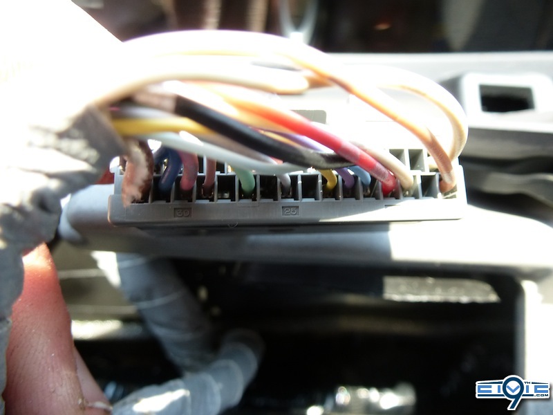

I soldered the Dorman connector to 16 guage stranded wires that were in an insulated sheath and then heat shrunk them for protection (I would recommend no larger than 18 gauge wires though because of the way the JAE pins fit into the tach pin cluster) . Over the heat shrink I heat shrunk the wires and insulation with a 4 foot piece of heat shrink 1/4 inch in diameter all the way from the connector 4 feet toward the fire wall so there would be no way of water getting in the new wires. Then I put the wires in a 3/8th inch black corrugated conduit for further protection. As far a routing from the bumper I feed the corrugated wires up around and through the same hole as where the headlight goes through the frame, then around the battery, and to the inside of the PCM/ECM and then under the master cylinder. Next through the rubber plug directly toward the firewall behind the master cylinder. With the wires through the fire wall and the dash taken apart, its relativity easy to feed the wires under the dash and up to the wiring harness that plugs into the Tachometer. I would say the trickiest part is installing the wires into the tach pin connector cluster. As you can see from picture
1.
there is a black tab that must be popped up (I would say only about 1/16 of and inch) in order for the JAE pins to slide into pin connectors 8 and 24. Use a jewlers flat screwdriver that fit into little slots to pop up the black tab. There are videos on youtube that show kinda how to do this. None of the ones I found showed this kind of connector but some were close. The JAE pins have to be crimped just right but its not too hard, however they go in only one way as there is a grove that slides into a channel. See photo, see the little slot or channel in each pin port
With the black tab popped up, wires crimped, gently push the JAE pin in to connector 8 and then 24 with a jewelers screwdriver until it ever so softly snaps into place all the way at the back of the connector. Pop down the black tab and connect the wire pin cluster to the Tach and then reinstall everything and it should work great!

to the left is Picture #1. Don't know why those photos on my last post didn't work but here is try
I tried to fix your post, but I'm not sure if it's how you wanted it. You would need to upload the photos directly to your post by clicking the "upload a file" button next to the "post reply" button, or post them to another image hosting site. The site you were trying to link the images from doesn't work here.
