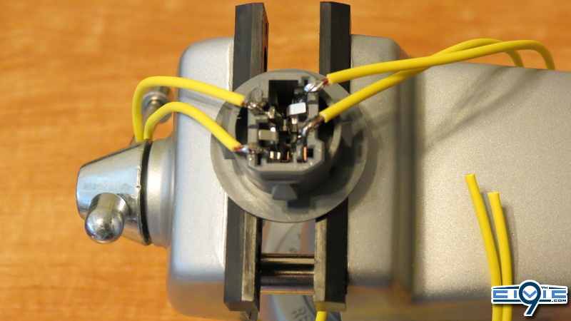

this was brought up in the diy thread -
^^These connectors are the ones you purchase from a Honda dealership.
After soldering the wires to the connectors, the wires will then be connected to your harnesses that came with your projectors.
003b-sized-jpg.21834
^^These connectors are part of the harnesses that come with your projectors when you purchased them.
If you didn't receive any harnesses with your projectors, then you'll never get them to work and you should return them.

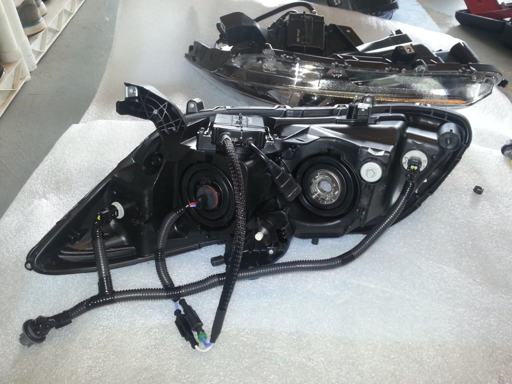

This is the harness in the early stages before epoxy:
Here it is on the light along with the HID ballast
So you did have to make a harness? Also, what type of HIDs did you get? Kelvin temp?
5000k 55w promax/xentec and added a relay harness
Yes I made the signal quasi-harness/splitter. I call it skrub's ghetto harness.

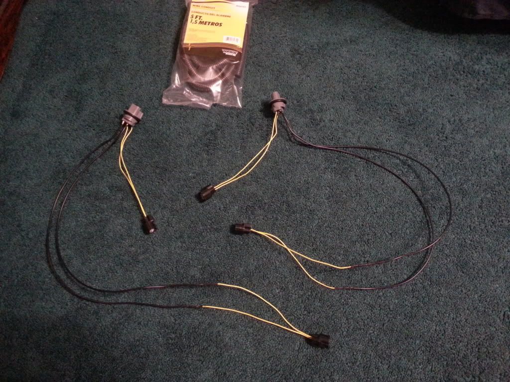

I built some harnesses following Jasonandre DIY projector thread:
If anyone wants me to build them a set, just PM me. I can order up the parts and build some for you.
