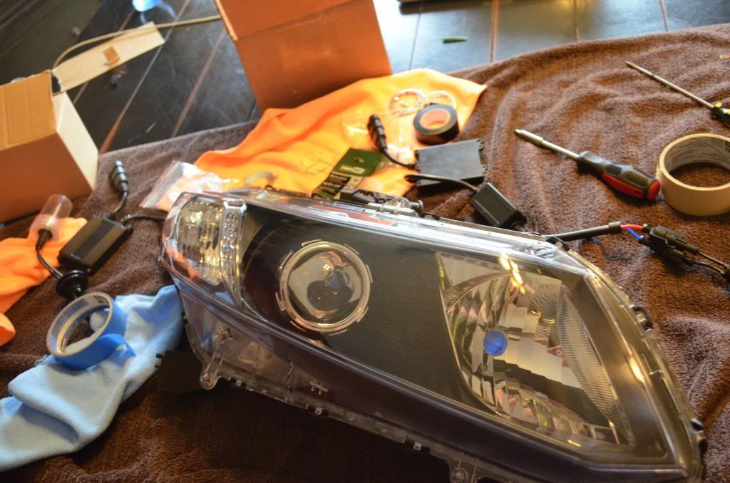

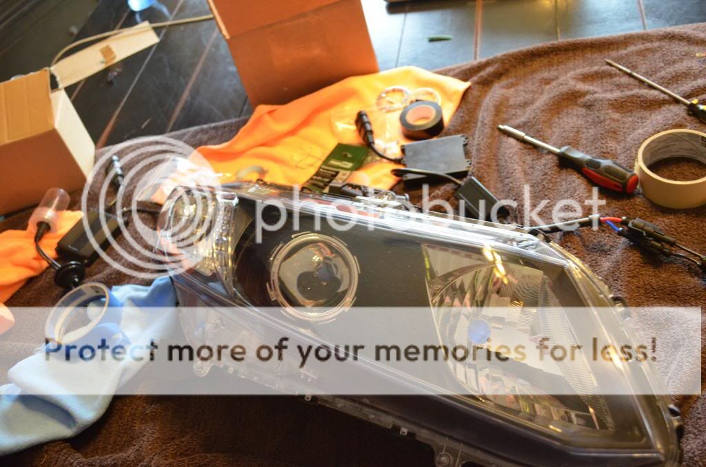

You do still have to open the OEM headlight and insert the projector itself. The reason the Mini is so popular is that it threads into the stock bulb hole instead of having to cut away the housing and affix the projector with JB weld or something similar. Usually no major cutting required and alignment is an simple and rotating the projector until the cutoff is straight.

Ok, after looking at the link I get it. Thought there was one specifically for the 9th gens. I knew I had to take the lens off the housing. Does it matter if I paint the shroud or does that need to stay chrome for light dispersal? $270 is a bit steep at the moment, but for the look and the actual improved lighting it would be worth it. Thanks @Nix and @webby for the help.
You could paint them. Some have used a high temp flat black, or other high temp paint. Some have done their entire oem chrome housing flat back

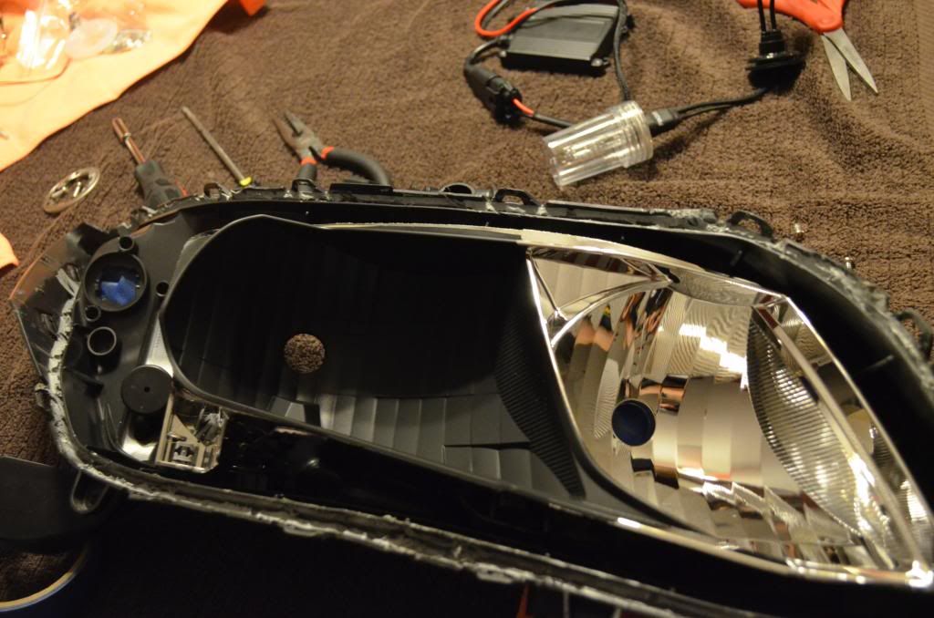

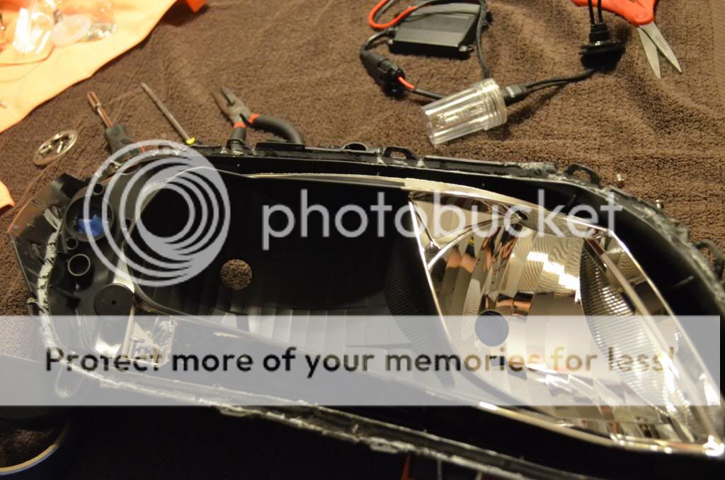

Would painting the flat part of the housing affect light output with the standard bulbs in place? Wanting to make my housing as black as possible. Would maybe a gloss black work for that area, so it still reflects light?
the low beam side is the one you'd paint (if you paint anything). If you painted the chrome reflector on the other side you'd lose your high beams. It needs that chrome to reflect the bulb light so you have high beams.
I know the curved part needs to stay chrome (no retrofit). What I was asking about is the flat part at the bottomof the reflector (no retrofit)? Would I be able to paint that?
That would kill light output if you painted it without a retrofit

That's what I was trying to find out @webby. Thats what I figured, but wasn't entirely sure. Either way itll be a fun project. Thanks for all the support.
