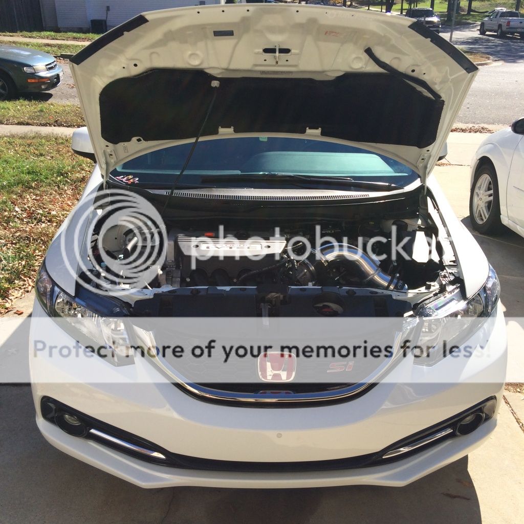

@323 Its not even the battery relocation. The two main problems were the clutch line breaking loose and the actual intake intake design is HORRIBLE! (Sorry prl) reason I say this is because when you line up the pipes together it basically looks like its going to slip off. Honestly this intake kit is not a clean intake install And it comes with little to crappy install guide! And you need to cut some of the wire clips to extend the positive connector. Honestly the 8th chassis is much easier then the 9th.
I can agree with some of that. I think I'm one of the first to have it on a 13 sedan. The wire harness is run slightly different in the front of the car due to the different front bumper. So I think that was the real problem. But for real doe, THAT CLUTCH LINE WAS A PITA! That was not easy what so ever. I got it done but again that was a royal BYTCH! But I love the sound and the look of the intake in the bay. It's so nice and shiney with good sounds and things and stuff!
I do agree you that we should have gotten some type of a install guide more than what is provided on the sure but it actually was all you kinda needed but a full guide would have been nice. Overall I would buy again if I had to. But I would have paid someone to swap that clutch line. I will never do another one of those in life lmao

I didn't think the clutch line was that bad. I have small hands and forearms though. I took out the CDV at the same time. I have an RBC so I am not sure how much of a difference it is with the stock intake manifold in relation to room to maneuver.

I think the PRL clutch line is different... I think it's longer and replaces more of the line then the one from P2R... but I might be mistaken

Room to maneuver wasn't the issue see:
It was this little mofo :
That was the PITA! It took me about 2 1/2 hours to break it loose.
But another issues is my front support bracket I believe is different than the 12s so the wires out clipped in different spots it was a crazy installed. But it's done and I'm happy! But it was for sure HELL and not easy but again I believe I'm first the 13 sedan with the Intake so now we know it's harder on those than the 12s

Yea it does the PRL one replaces just about all the hard line. Only thing left is the hard line that runs from the CMC to the new SS LINE
Looks like this
If you look at the pic with the battery tray it replaces the hard line right next to which runs all the way to the frame

You couldn't break it loose while it was still in the bracket connected to the wheel well?
Hell naw! We tried that. I had to get my superman vise grips and a 10mm and all the man juice I had left and twist opposite ways of each other and it finally pop loose. It was seriously over tighten from the factory.
I was a bit concerned at first, but it eventually popped loose. A lot harder than I was expecting it to be.
Exactly! I got the slave off really fast! But it was for sure a lot harder than I was expecting.
