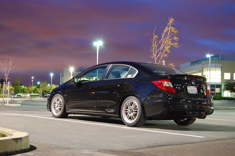

thanks bro! check my build for the exhaust mount and modification that I did to make it work. You can also message the seller on ebay and get that mount specifically for cheaper
Yeah I did some searching before I bought my exhaust and, in hindsight, I should've just ordered and installed everything all at once. Oh well.

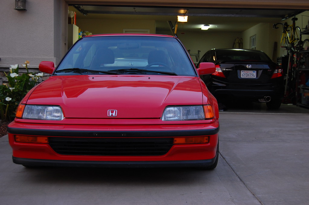

Just picked up a new project...the 9th will probably be getting kicked out of the garage soon

Cheers guys. I'd like to make some changes to the car soon, particularly a new wheel setup and finally a track day (been putting it off cause of work). But I'll be honest -- ever since I've bought the EF, I've been focusing a lot of time and energy building that car. Soon!
thanks man, i appreciate it. do it -- 235's are perfect on this setup.
Your build is awesome!...exactly what Im going for.
I've bee contemplating for so long on what wheels to get between the RPF1's or TSW Nurburgring...but I thought 17x8 RPF1 might look small, and I didn't really like the "bubbled out" spokes, prefer the 9" wide, so they're flat, but i don't want to roll fenders or rub....but your build has sold me on them, your car makes the 17x8 look amazing and I actually don't mind the 8" wide ones now that I'm seeing them in the 35 offset.

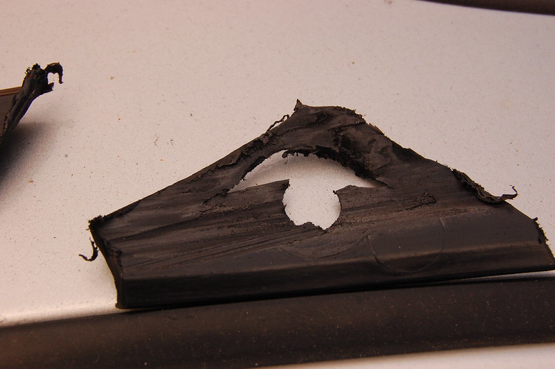

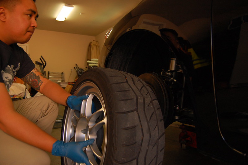

Had time to do the fronts this morning with my friend before heading out to work later this afternoon. Decided to just cut up the fender liner instead of ripping it out.

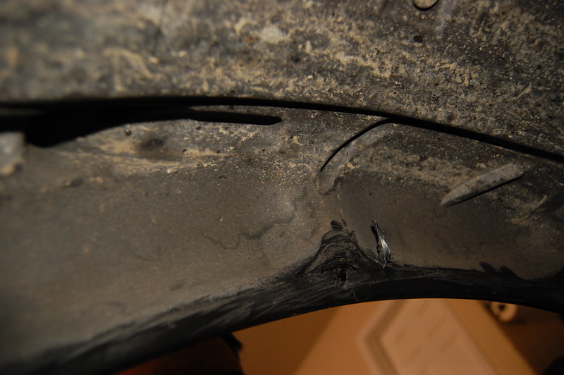

Here's where it was rubbing under hard cornering :vtec: --
Cut the section that showed wear out, heated up the tab on the fender itself, then rolled it over by hand. Took it out for a quick drive and it seems to be alright now. I'm sure there are better ways to do this, but like I said earlier, I wanted to keep the liners.

I only rubbed when making aggressive turns where there was a level change in between. Other than that, there were no issues rubbing. I just took the precautionary step by rolling the fenders since I have access to one. The rubbing itself wasn't on anything other than the plastic tab that sits at the very center of the fender liner (at least in my case).
