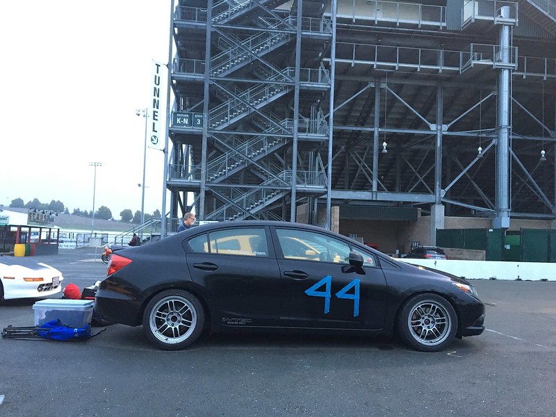

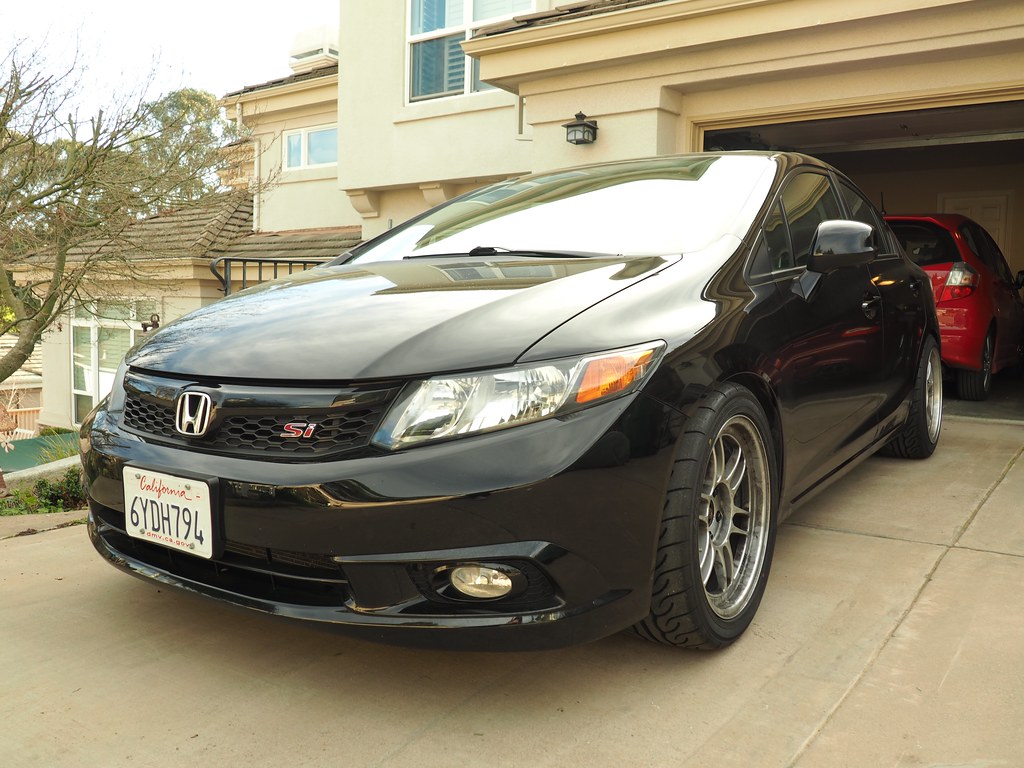

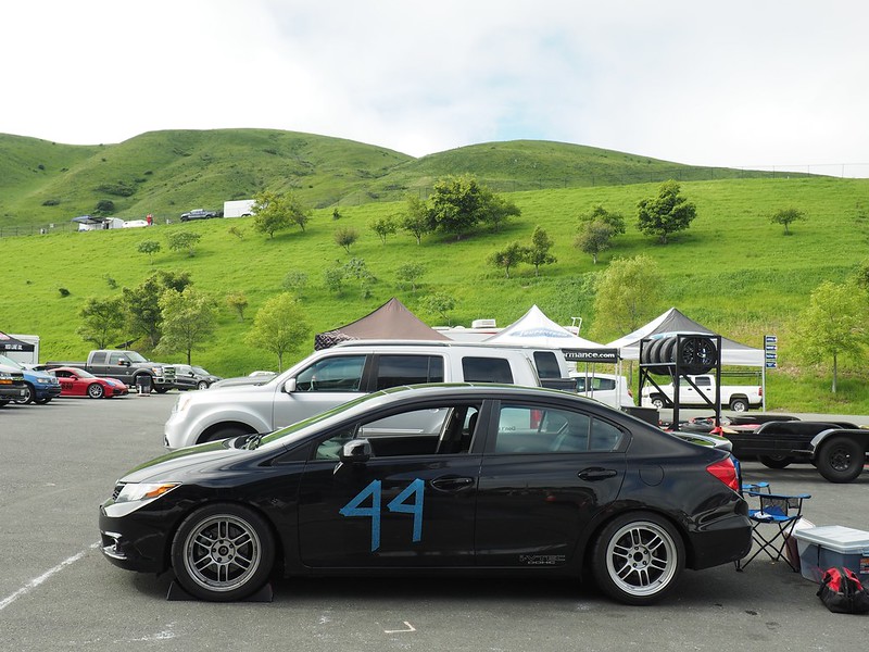

Noice! Thats wide as heck on the front!
Just cause everyone is going to ask:
Camber? (-2 R/-1F still?) Offset? (+35?) Rubbing?
255 is some meatGot my new setup on, but haven't had a chance to get any decent pictures. 255F/225R on a 17x9 setup--
So with a 17x9 +35 wheels you can fit a 255/40? with no rubbing and -3 camber?
How do you like the staggered tire setup on the street?
I'm in the process of going 255/40 17x9+38 on the fronts and 225/45 17x8+35 rear. I have a set of advans that have been hanging out in my attic for the past year.
I usually don't mind being the Guinea pig but good to see someone else with a 9th went the same route I'm considering.
Also noticed you have 17x9+35s any issues beside trying to run more negative camber? My +38 is close and I only have a 225/45 currently to test with was wondering if I'll run into any issues when I bump up to the 255/40s
Awesome, thanks for the reply. My previous wheel set up I cut the fender wells and rolled the tabs I figured I'd have to do it here as well. Probably going to need to run a spacer up front it seems then. No biggie might be an excuse to get extended studs.
Now that you've been on the mono-rs for a while how would you rate the daily drivability? I had a set of ksports but have since put the stock suspension back on for now. Trying to get an idea of how the 8kF and 10kR spring rates of the mono-rs will compare to the 7kF and 7.5kR ksports.

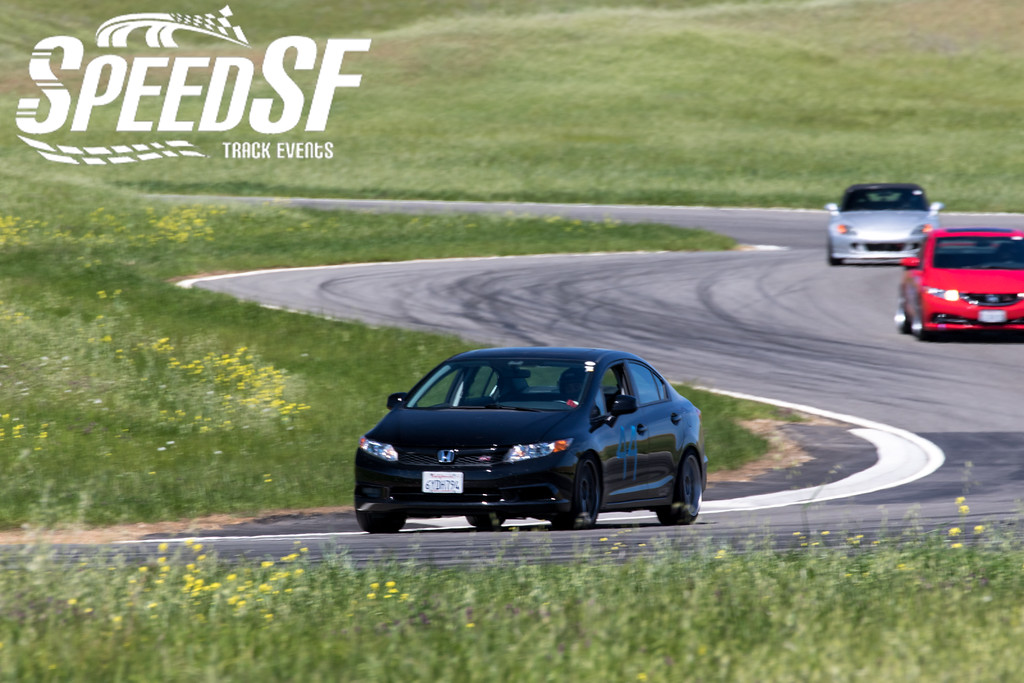

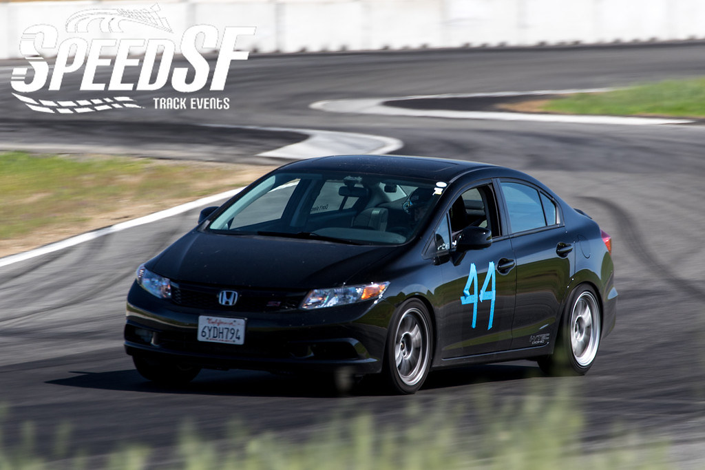

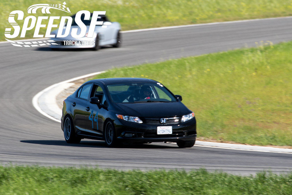

Didn't have a transponder this time aroundHow was the day? Results?
I thought that rear window sticker said: Don't stare! Drive!
Looks super fun. How do you think you did? Slay anyone or catch any much "faster" cars with the new setup?
