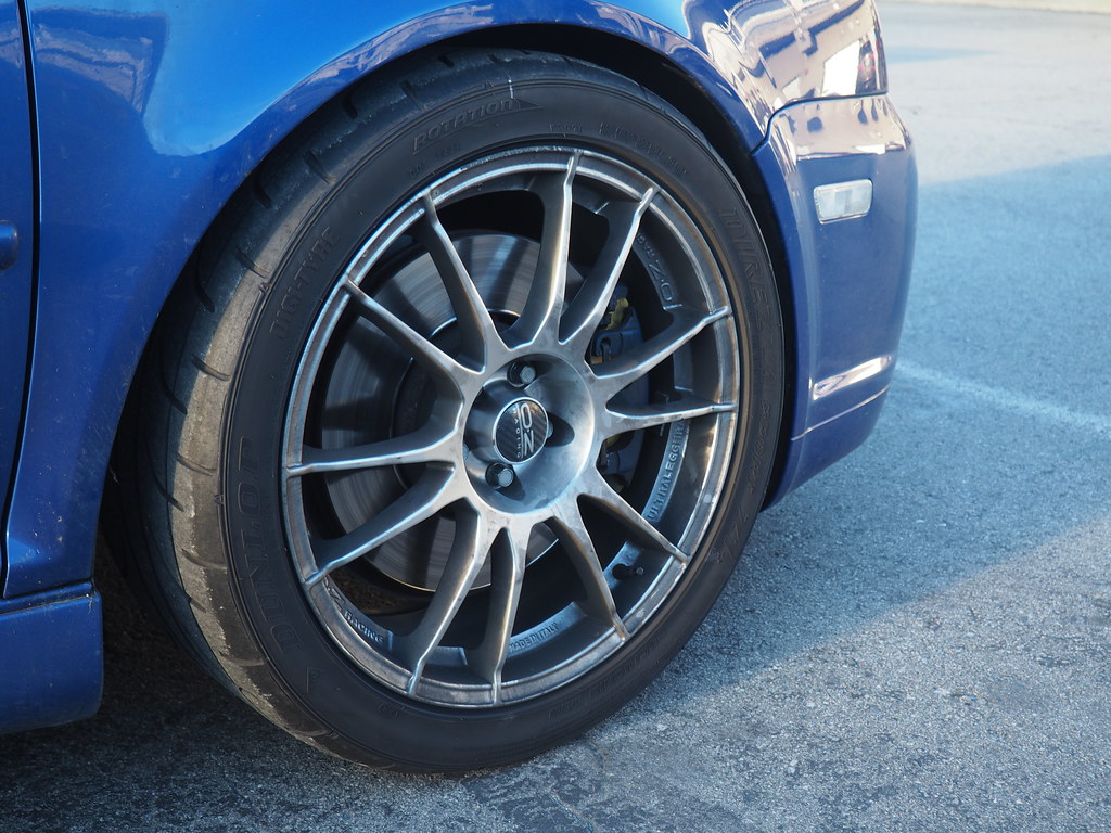

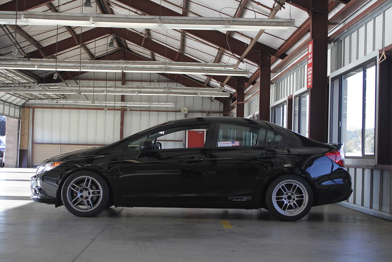

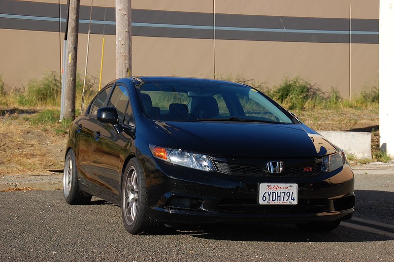

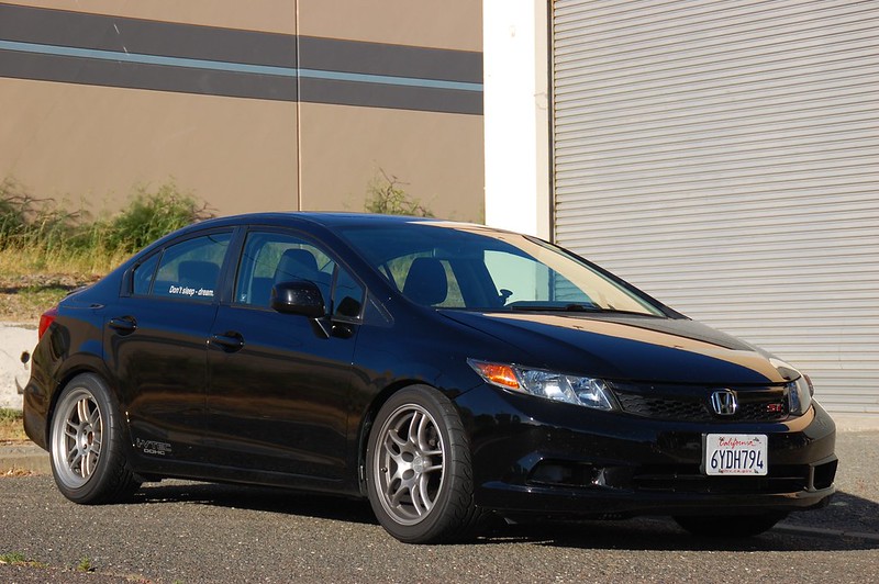

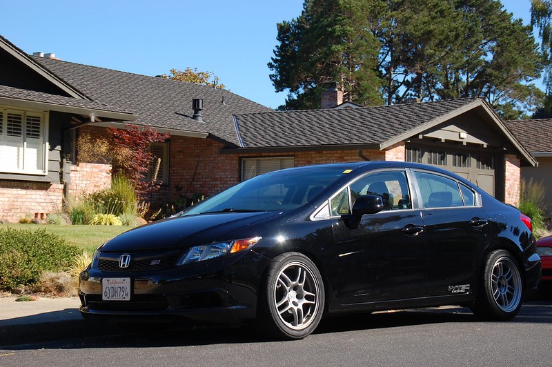

No proper pictures yet, but I have a pair of R33's that I tossed onto the front to give me more shock clearance. The way the RPF1's sat up front made me a bit nervous and I could hear them rub against the strut under compression. R33 wheel specs are 17x9 +30et and I remounted my 255 Advans on them. This is just to see what I can do in terms of fitment as I am looking to jump down to a lower et to dial in more negative camber.

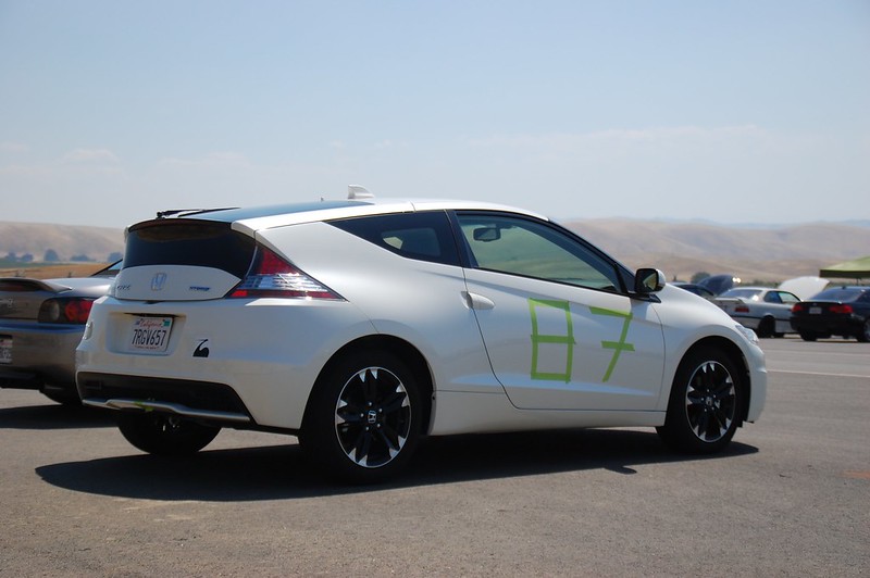

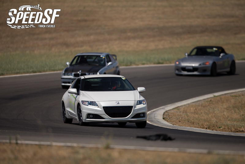

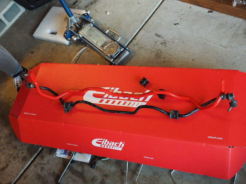

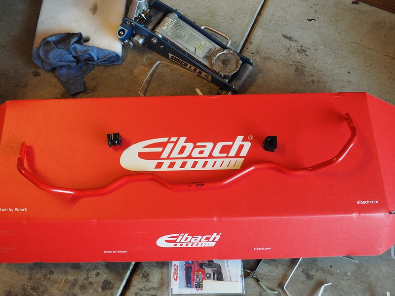

Ordered a rear sway bar and was going to install it before my track day this past Saturday, but discovered that I had a nail in one of my tires. So what did I do? I took my daily driver CRZ out to the track. Can't let that spot I paid for go to waste!
Gonna have to figure out my tire situation before the next day. I was really looking forward to see how the sway bar would affect my times.
Rear sway bar installed. The car feels great and I can't wait to see if it makes a difference in my times. Should be heading back to Sonoma in August.

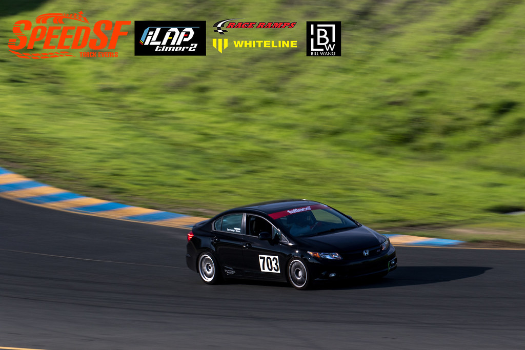

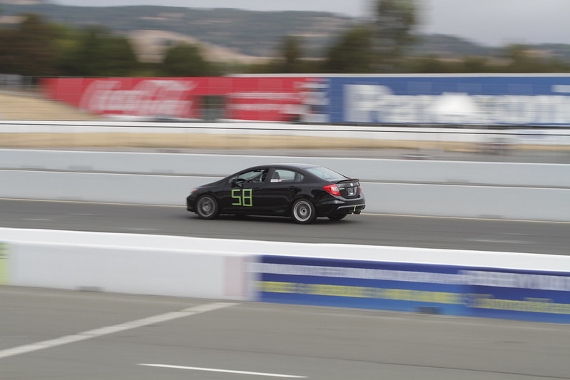

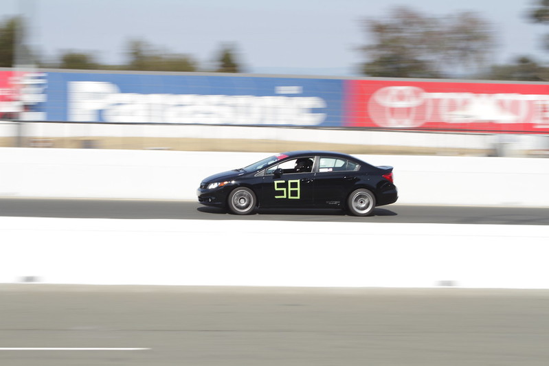

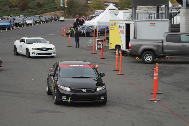

Went out to the last NASA event of the year over at Sonoma Raceway. Waiting for pictures from a friend as well as the pro-photographer. Until then, here's a video of me playing cat and mouse with a friend's Camaro SS.
Thanks. The car needs a brake overhaul and new front tires. I'm not sure if I can crack that 2:00:xxx mark with the stock motor anymore. So next season, it's time for some engine bolt ons.

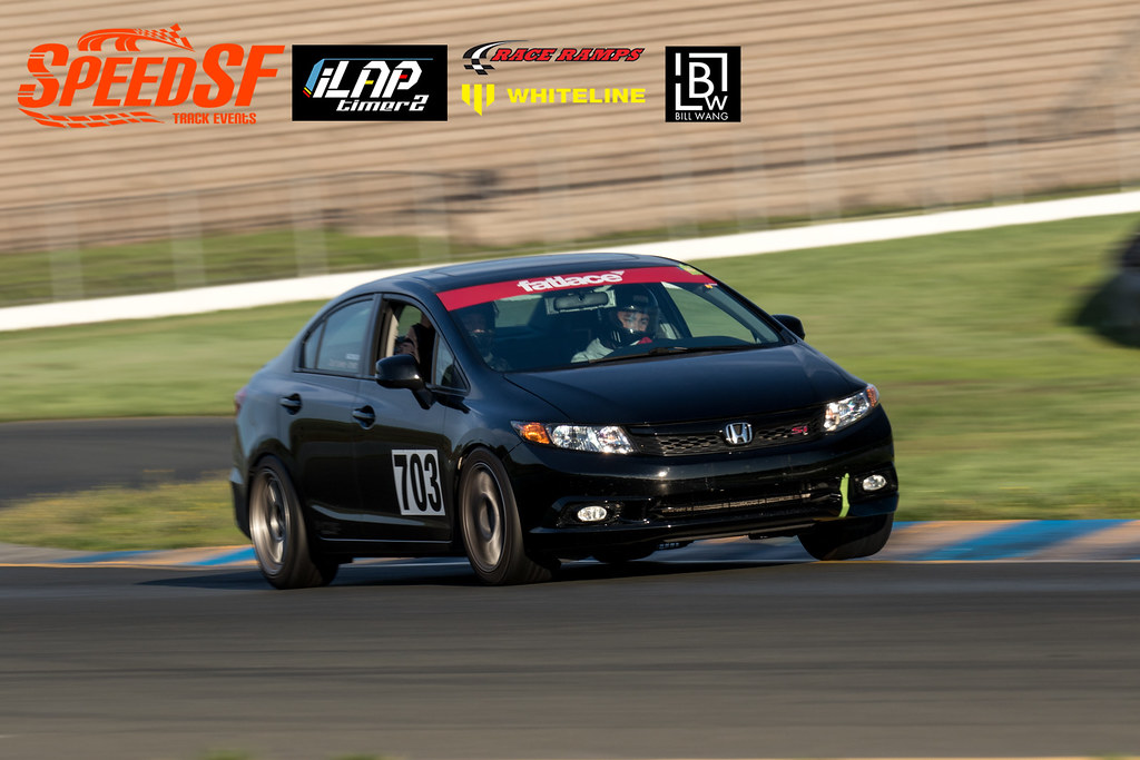

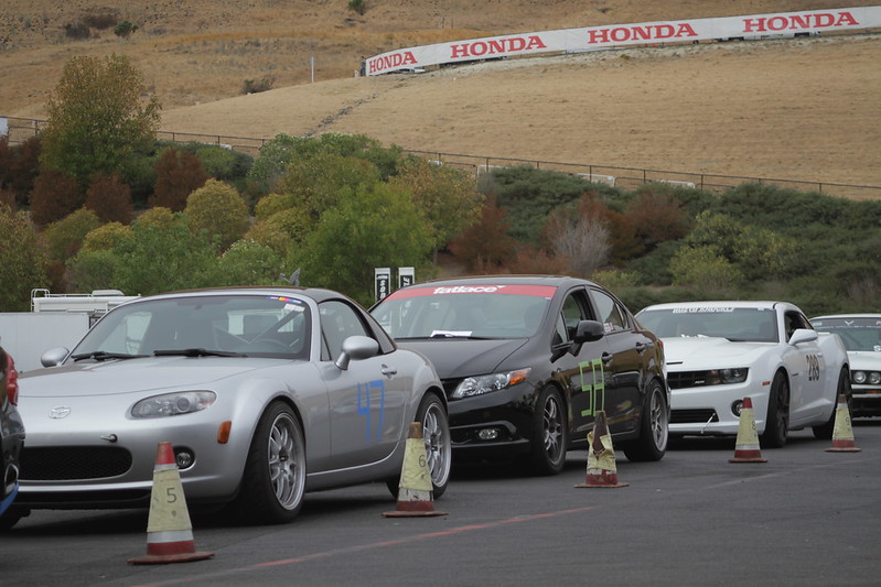

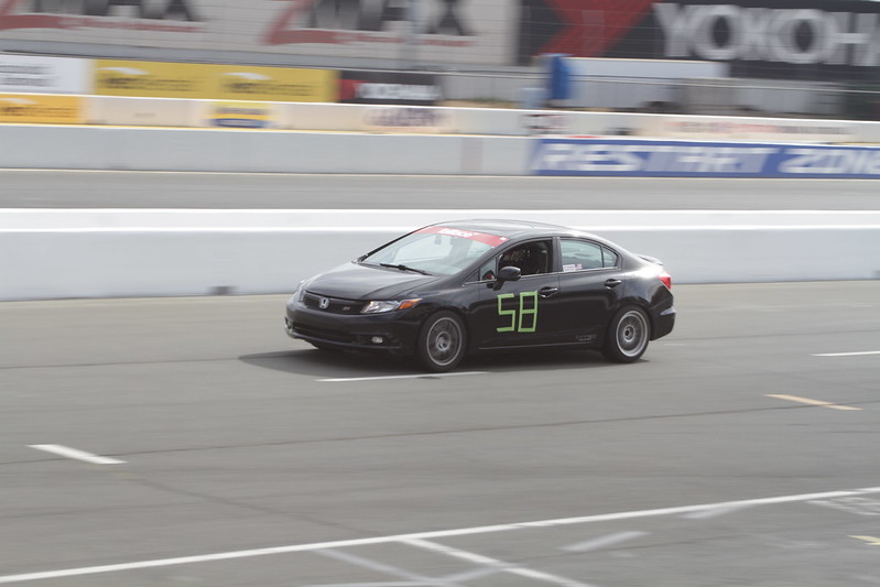

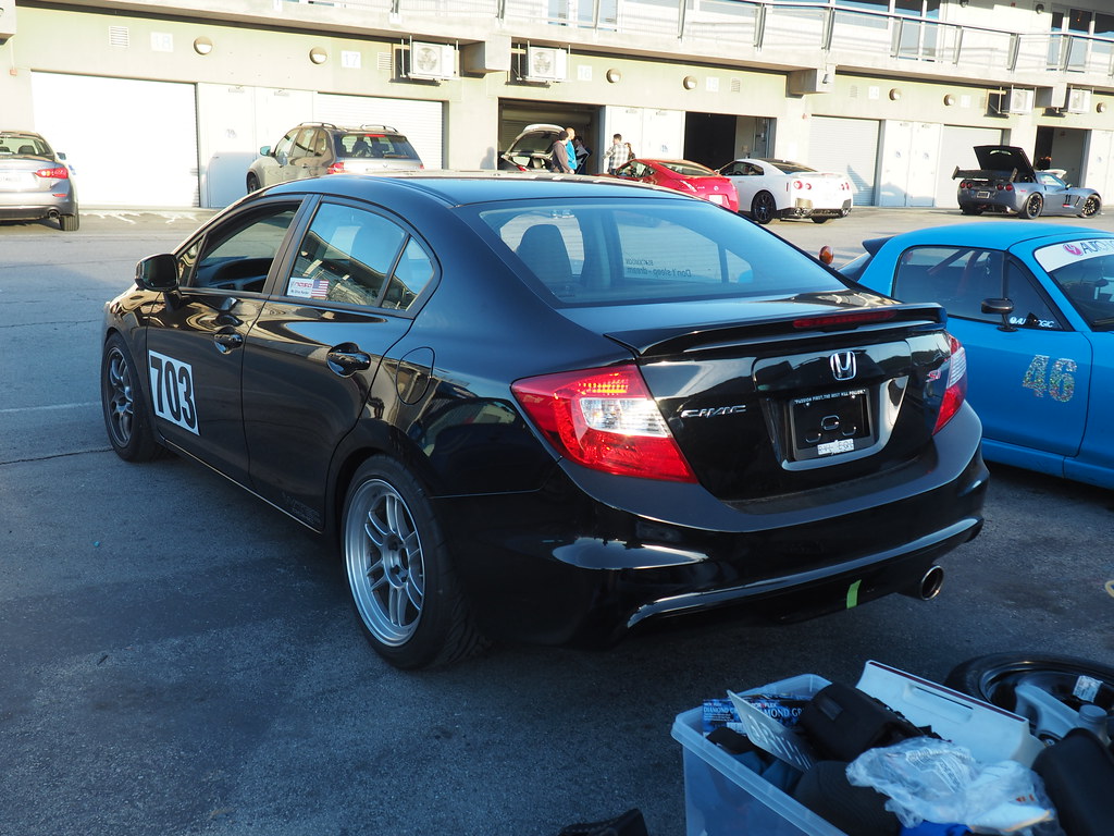

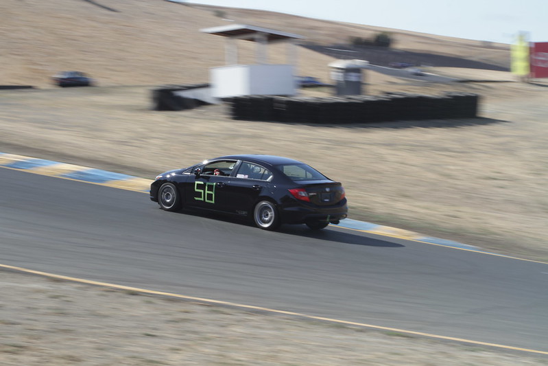

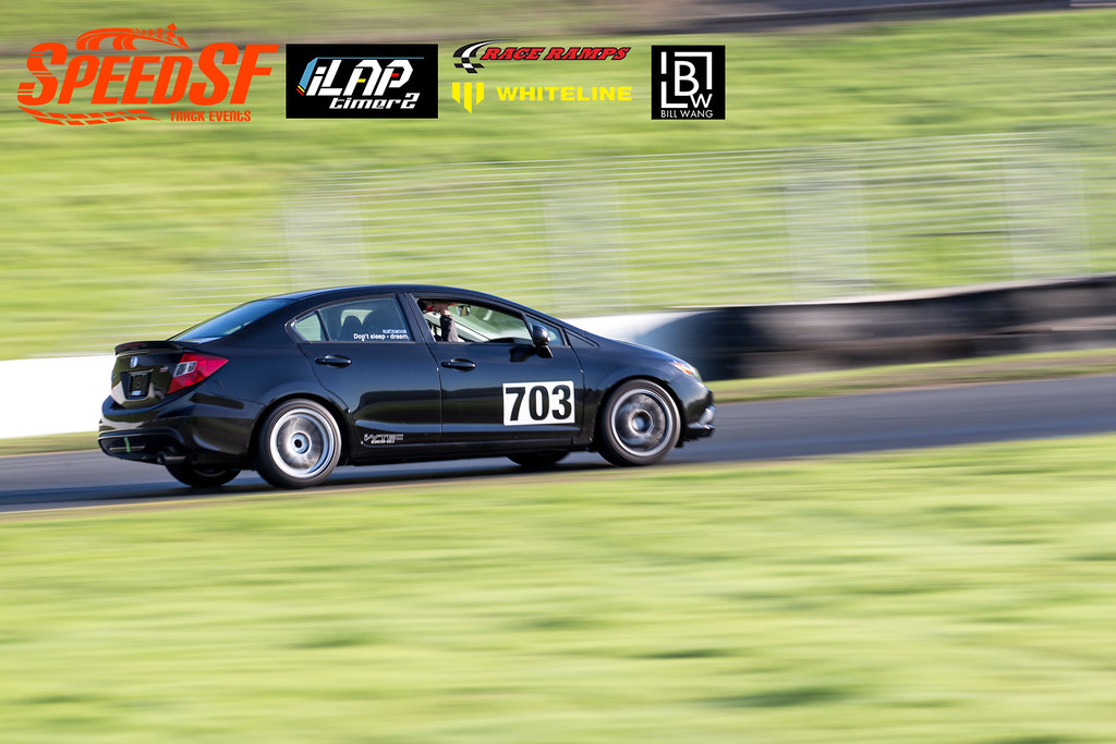

Ran my last event of the year and managed a 2:01 at Sonoma. Short of my goal with the stock motor, but I'm still happy with my progress this year. Next year, the car will start to get more changes, so these are the last photos of it looking the way it does at the track. I've sourced a wingless 2012 trunk and will be changing the car a bunch for next year.

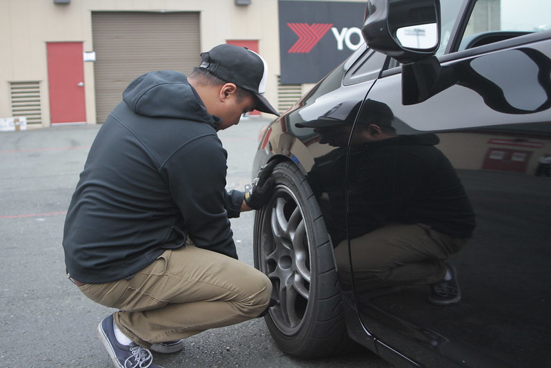

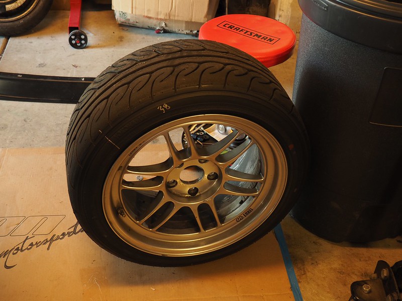

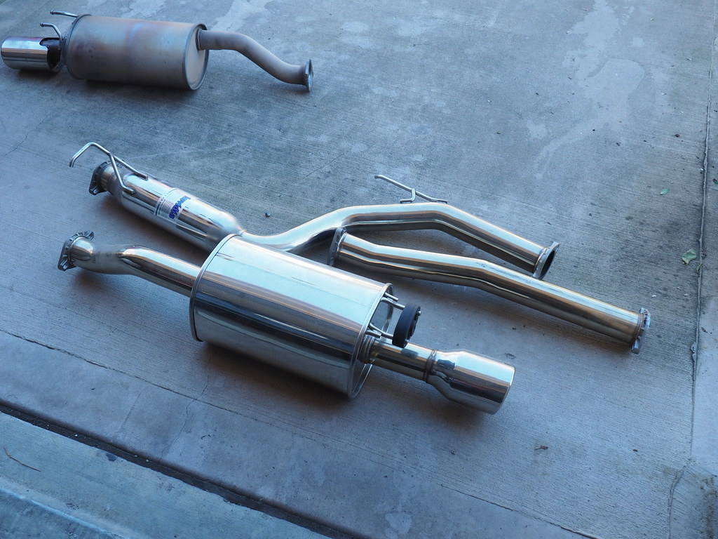

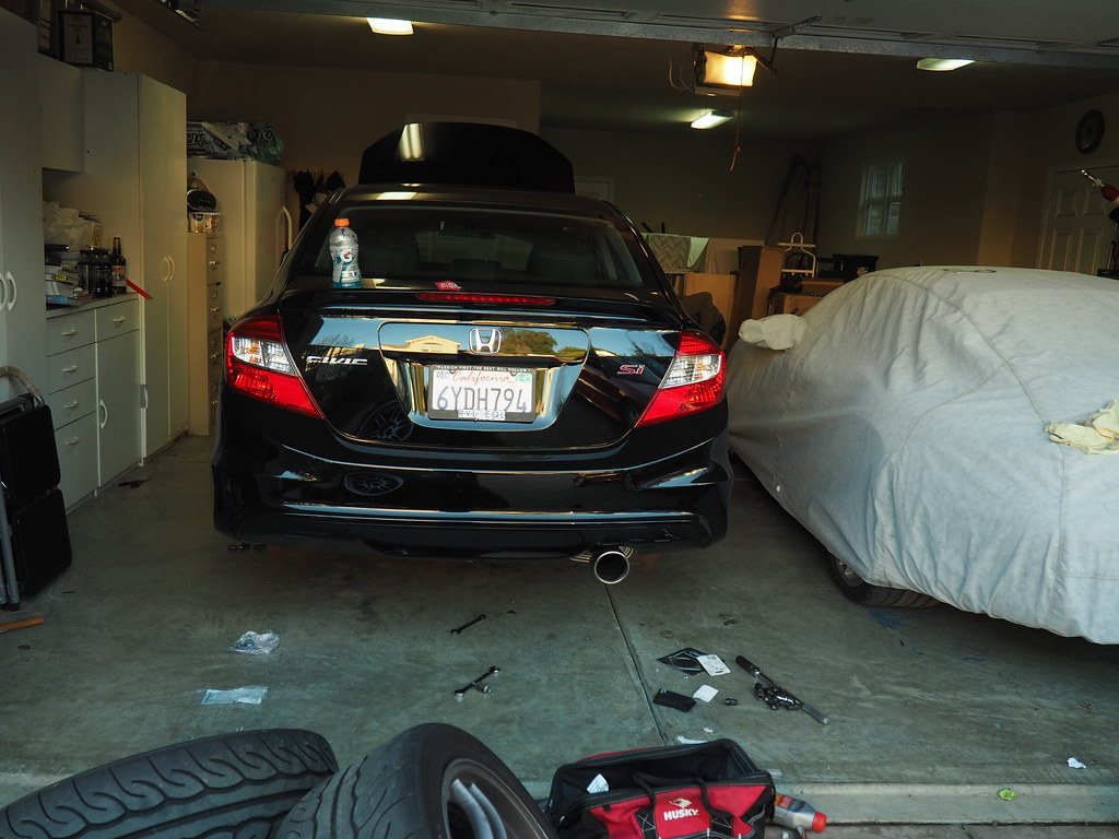

Went over the car and cycled out fluids and installed my catback the day before —

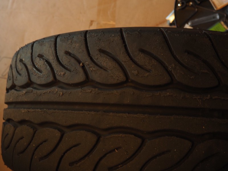

The Neovas look like they have one more good session in them.

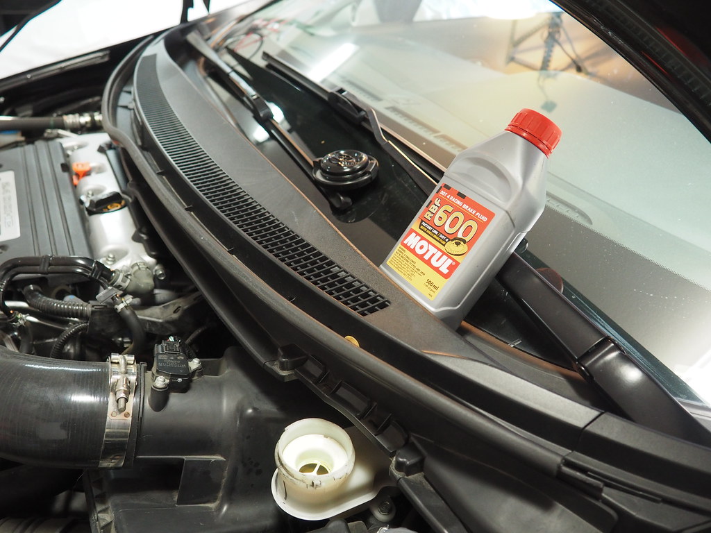

Cycling in some new brake fluid

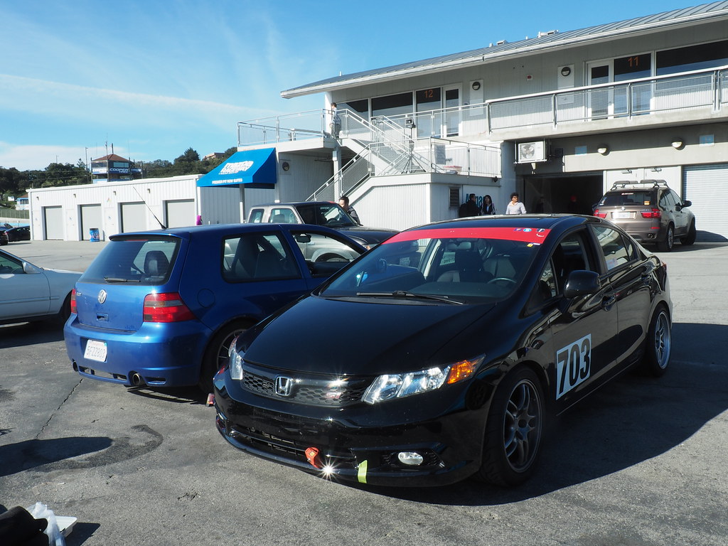

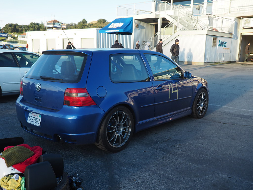

The next day, my buddy and I cruised over to Laguna Seca. It was my first time there as a driver and my friend's first track day all together. He drives a Volkswagen R32, but has a bunch of other cars as well. I was able to help him shave off 7 seconds by the end of the day while I rattled off a 1:54:XXX. Brakes were toast by the second session out. I guess it was time to get new pads and rotors, but I wasn't planning on going this early in the year. I think with a fresh set of tires and and without the brake fade, I have a high 1:40's time in this car without any real motor mods.

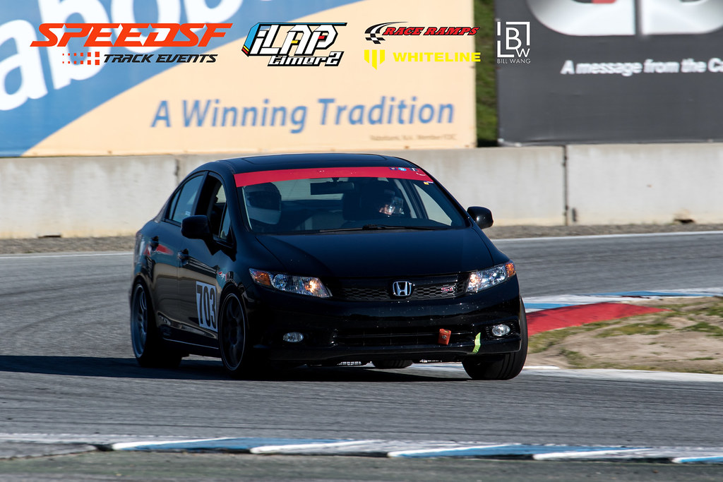

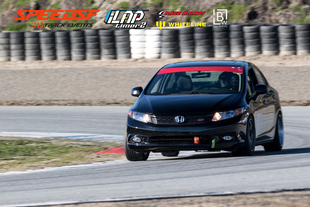

And from the pro photographer -- the GOOD photos

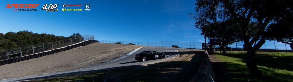

The world famous Corkscrew. Super difficult to nail this.
I actually spun my car cause I carried too much speed in, the rear end got light, and I lifted causing major snap oversteer. D'oh!
Lucky dog, got to go racing at Laguna Seca! How awesome is that! Cool pictures too. Spun out on the corkscrew... legendary. hahahah
