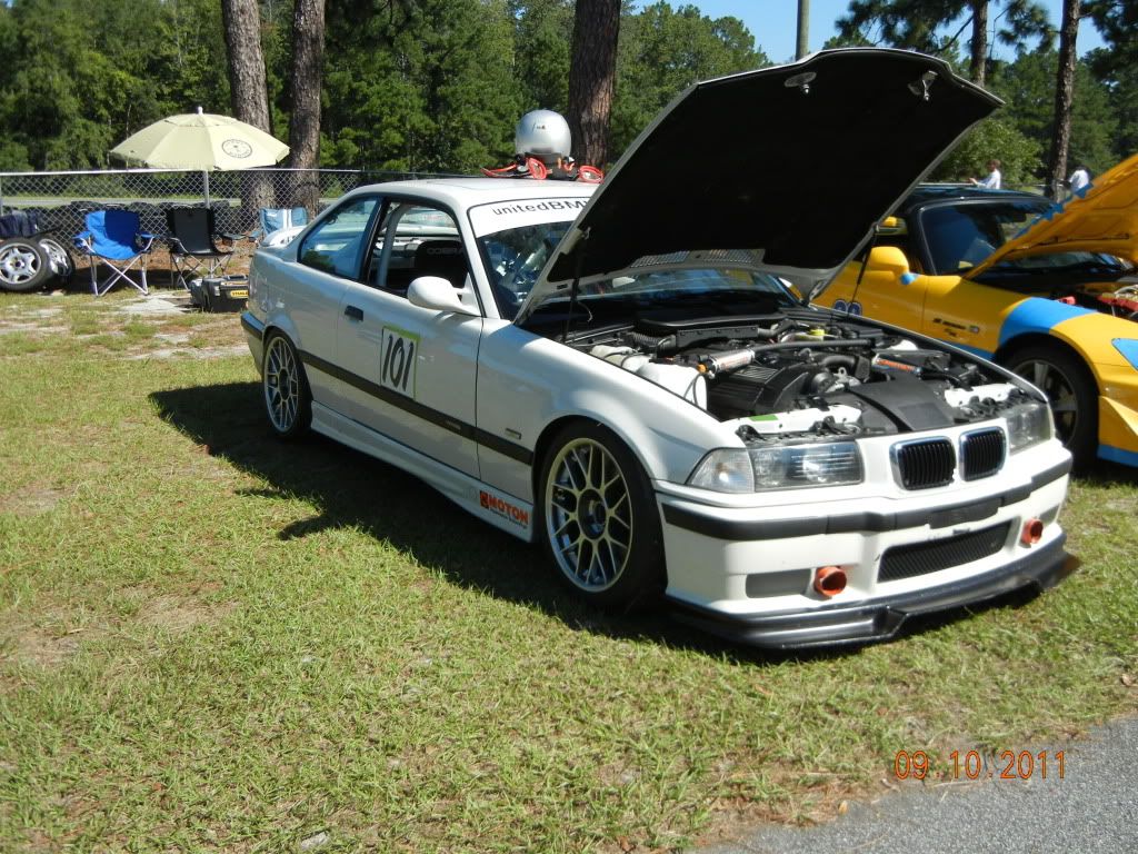

not sure if you've answered this already, but what camber/caster/toe specs are you running?
-3.5 6.8 0.07out
-2.4 0.11in

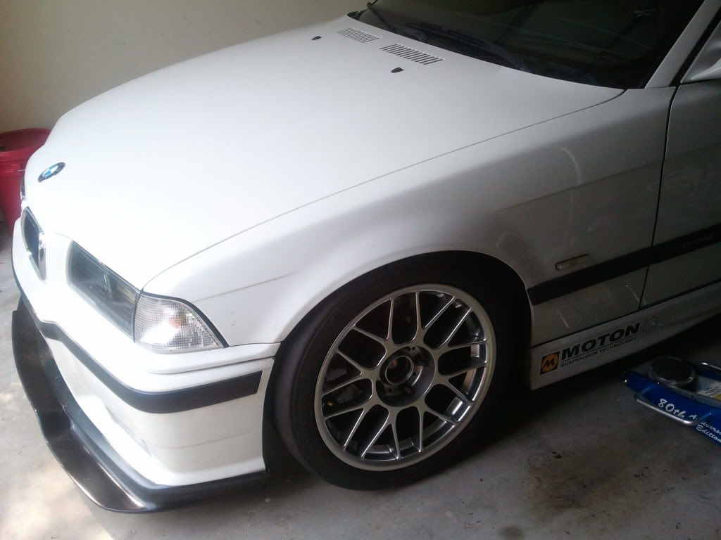

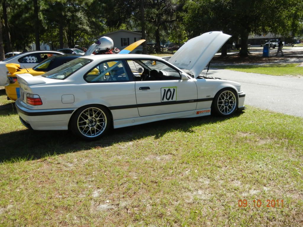

Threw the track wheel on to test fitment before taking them to a friends house so he can take them down to Savannah for me next weekend:
-3.5 6.8 0.07out
-2.4 0.11in
and thanks Jesse. We need to meet up some time, it's been too long. I heard you were rocking an e30 now? Post some pics :)
-3.5 D:!!!!
Do you feel that actually helps? What dia. sway are you using? springs rates and rebound rates?
you can see it when we hang out :) it's a jaloppy right now, though :(
any shots of the full car with those wheels?
Jesse, yes. Tire temps were pretty much to spec on the pyrometer with that camber. Stock sways at the moment.
Webby; no. I only put one wheel on and took them all to the guy who's taking them to Savannah for me next weekend. I'll grab some shots when I throw them all on.

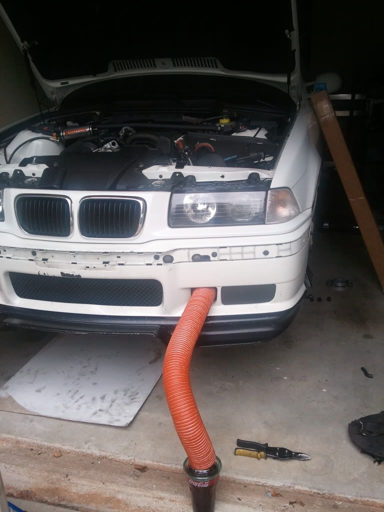

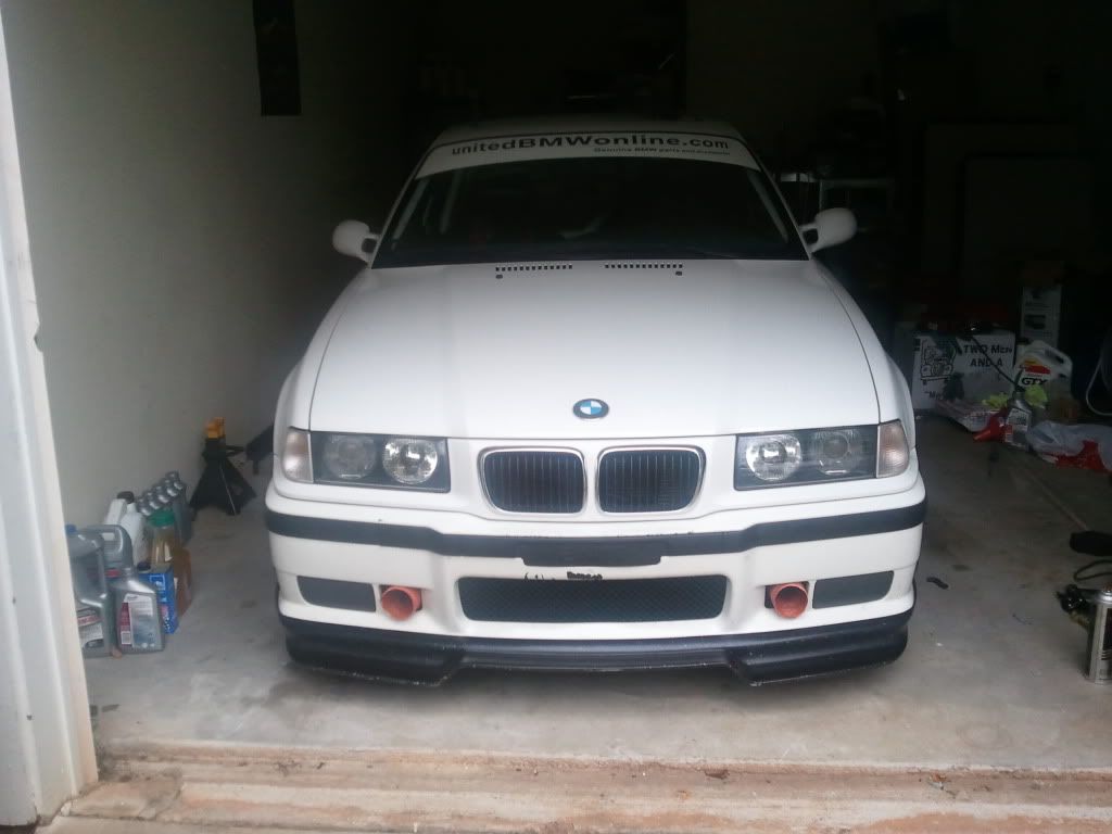

So I finished my prep work today..

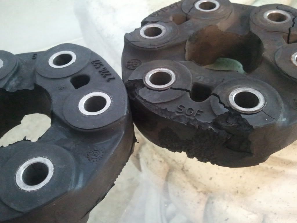

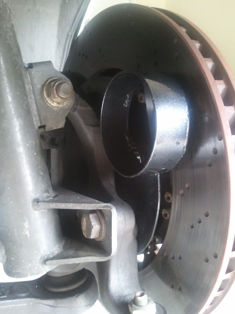

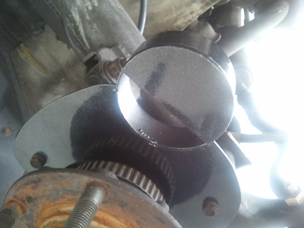

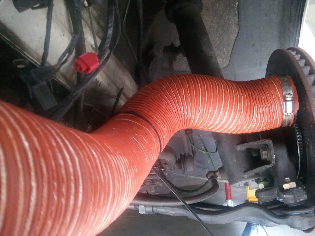

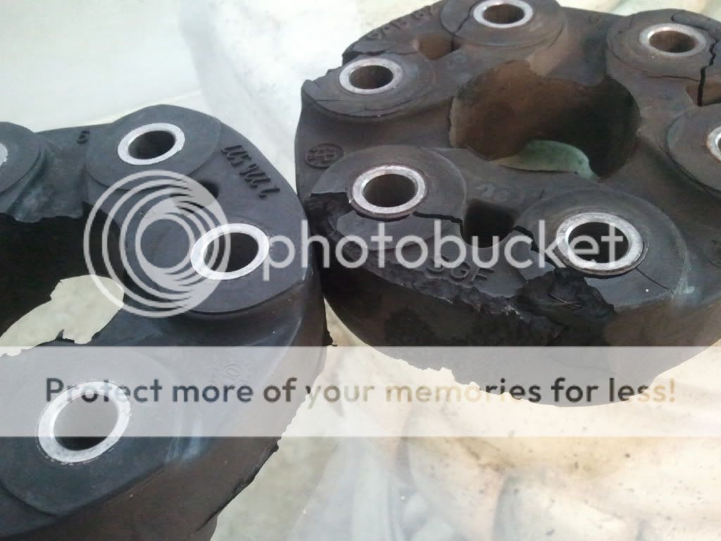

Replaced the fubar'd driveshaft flex disk(connects driveshaft to output shaft on transmission), transmission mounts, brake duct backing plates and ducting, and an oil change.
"Everything runs better on coke"
If you don't have me on facebook...
pipe sticking out is temporary until I can get a proper duct/mount.

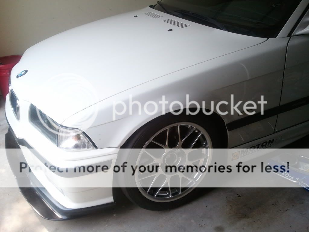

also, paint on front bumper got worse after I ripped the whole thing off trying to get it in the driveway on 2x 6' 2x10 piece of wood. I'll get it repainted at some point.
yeah, I saw the guibo last weekend when flushing the tranny fluid and diff fluid and my eyes bulged.. first thought was "damn it, I have to spend even more money on this bloody thing"
I'm hoping my bmw endeavor isn't as expensive and exhausting as yours.
why did you go with an oem rubber guibo instead of a solid one? just curious, because I'll be doing a rear-diff swap and I'll need to change the guibo as well.
After all my research this was the most commonly used by all the NASA/BMWCCA race cars. It lasted 2 years and there's no real performance gain from anything else. I got it at employee cost ~$75..

Ken - the brake ducts worked very well. No fade throughout a 20min session. Although the track isn't hard on brakes... my PFC01 pads are superb with or without.
