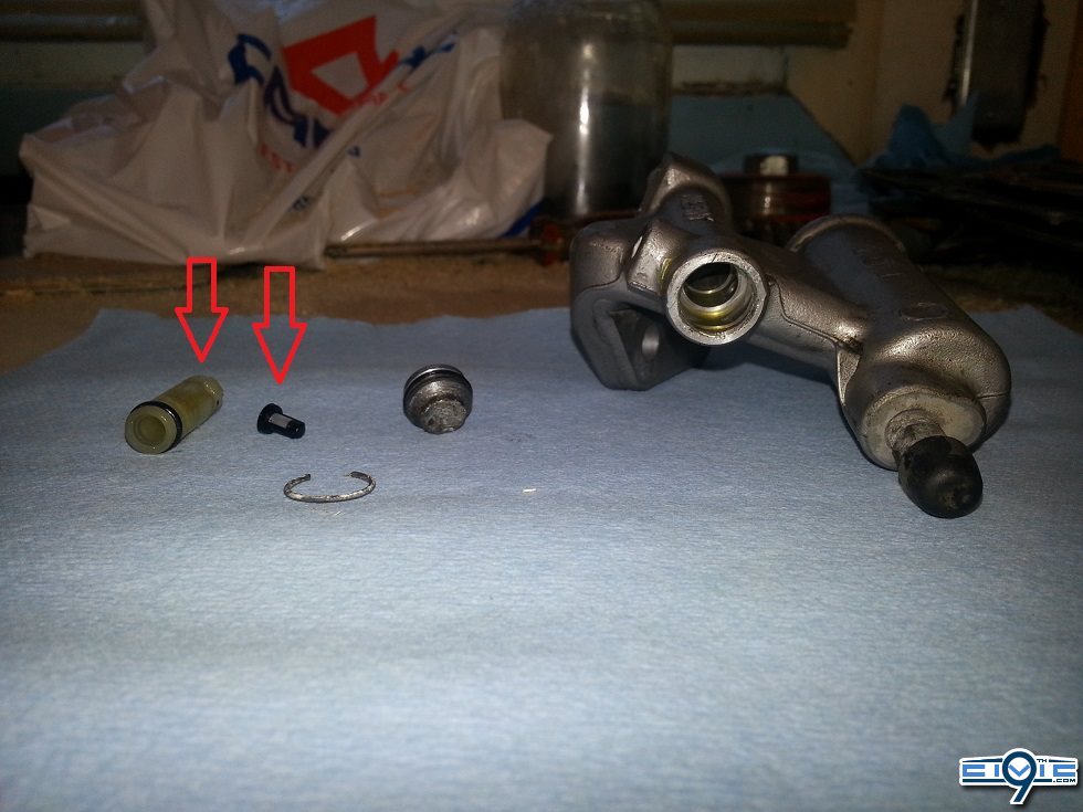

so basically you throw away those to things that have the red arrow?
There's no reason to save them, but I saved mine.
Yes. Those two items get removed and you put the cap and wire circlip back.

getting the c-clip/ring out is a giant pain in the arse.
  • Like
Reactions: Nix
I had good luck with getting the circlip out once I grabbed a jeweler's screwdriver. And it didn't go flying like I thought it would when it came out.
