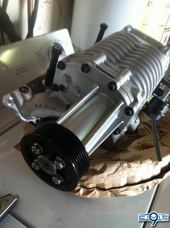

I received the kit today. Nate and the guys at CT-Engineering did an awesome job packing the kit. Even though the kit came from the same state, UPS is a little rough with the handling. The Box itself was a little dinged but the items were in immaculate condition. CTE hand-rolled packing paper into giant cigars, along with dry foam packs to protect everything inside.
Here's what I received today. Installation should begin tomorrow.
