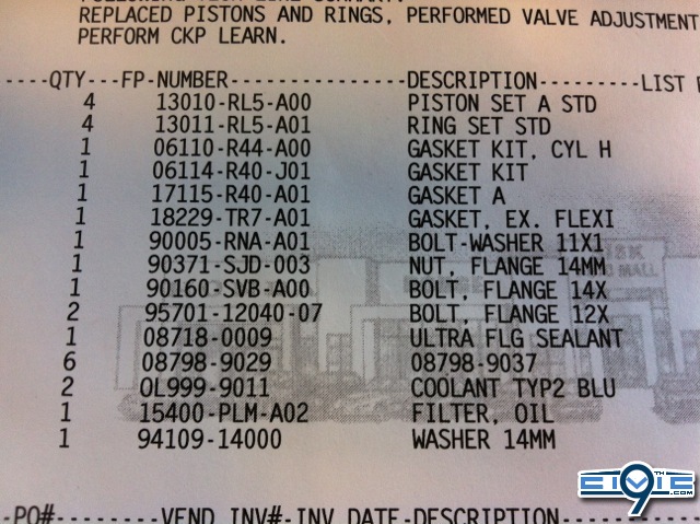

here are the parts that were used to correct the oil consumption issue

Sorry i accidently posted incomplete parts list and ran out time to edit the message. webby is there a way I could email you a pic of the work order copy? I am trying to add it but it says the file is too big.
