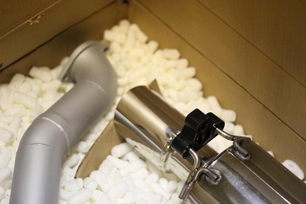

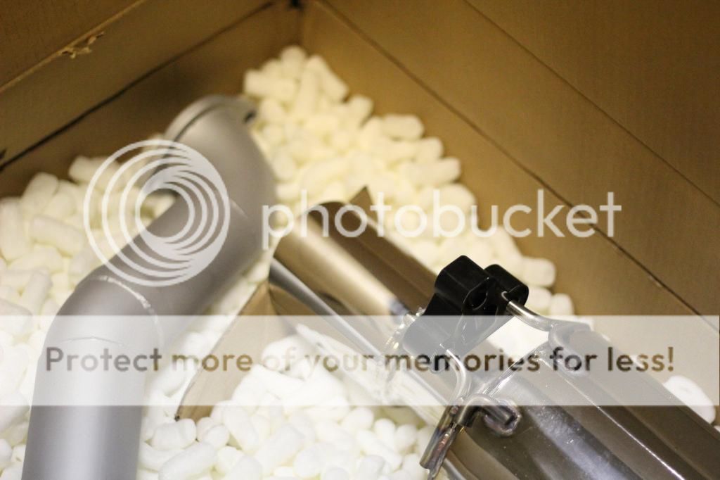

This is what it looks like on my exhaust that isn't installed yet. And yeah, it is for the 2006-2014s.
Someone was also having the same issue saying that the stud that holds the cat heat shield is what is hitting the mid pipe. The stiffer mount should stiffen up the exhaust and prevent all that movement.
So I decided that I'd also pick up one of these stiffer hangers... How the hell did you get it on the exhaust hangers? Maybe I just need to take the muffler off and put it on in the garage, but it's too narrow to fit on mine by about a 1/4" and no amount of forcing it with a screwdriver or prybar was doing the trick (just deformed the hole and I couldn't get it to slip on)...
