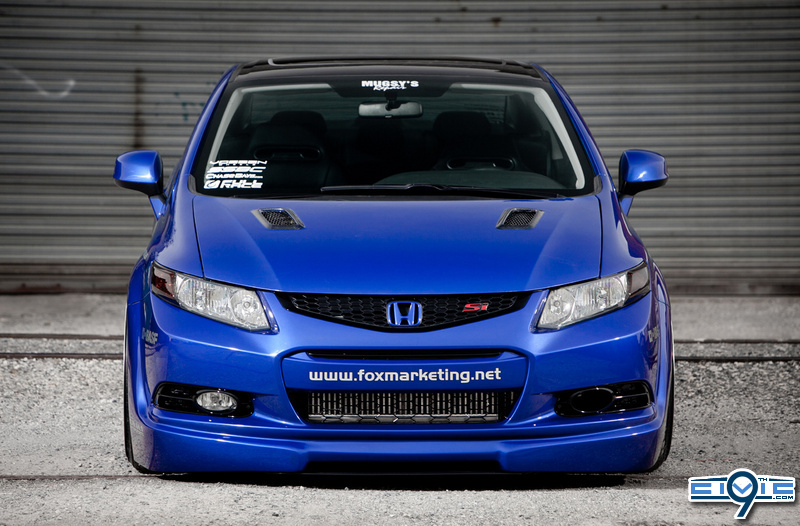

Wait...so this kit requires removal of the fog lights and a smaller battery?
Yep
Ya...that's not gonna work for me. There's gotta be a way to route the charge piping so these things aren't necessary. Probably needs a different intercooler.
Maybe this sounds ridiculous to some people, but my headlight combo switch has a fog light switch, so I need there to be fog lights. I suppose I could see if there's an EX switch with the auto-on/off headlight function with no fog light switch. If that exists, then we're golden. I never use my fog lights anyway.My guess is since Arizona rarely gets fog or 20 below temps, it's not a big deal..
I don't know that they've had a 2013 in for fitment. Honda changed the crash beam on the 13's...so their design on the 12's may not even cary over.
Is there still nobody with this kit yet?
I don't know why we can't use a battery relocator like the PRL one and just have the intercooler route where the cold air intake goes through the fender well. I'd rather keep my battery relocator. Better than getting a tiny battery.
Perhaps the intercooler charge pipes should be rethought and rerouted now that the battery relocator exists.
I feel like this kit was thrown together in a hurry because fox marketing needed it ASAP for sema.
It's because of the design of the intercooler Full Race is using. It's vertically veined rather than horizontal and has both the inlet and outlet on the same side, rather than the inlet on one side and the outlet on the opposite side. It almost seems worth it to just buy their manifold and the EFR from them and have charge piping custom made to an intercooler that actually fits without having to give up one fog light and get a smaller battery.
As seen here. The PRL pipes pretty much route to the same spot. View attachment 19176
