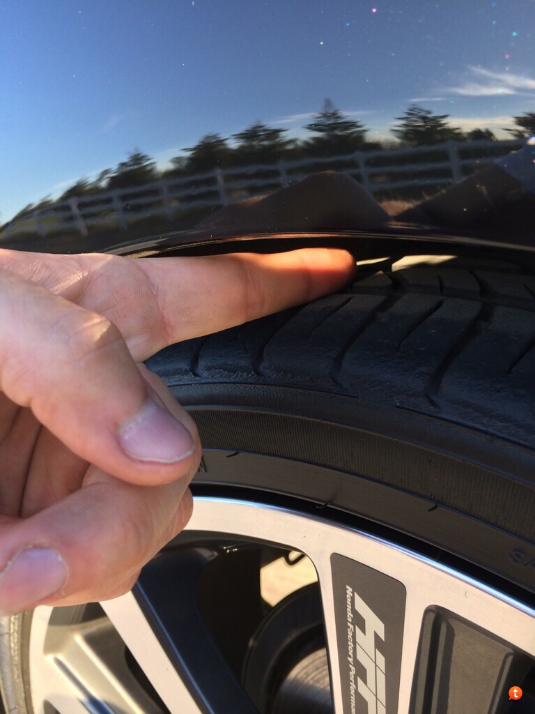

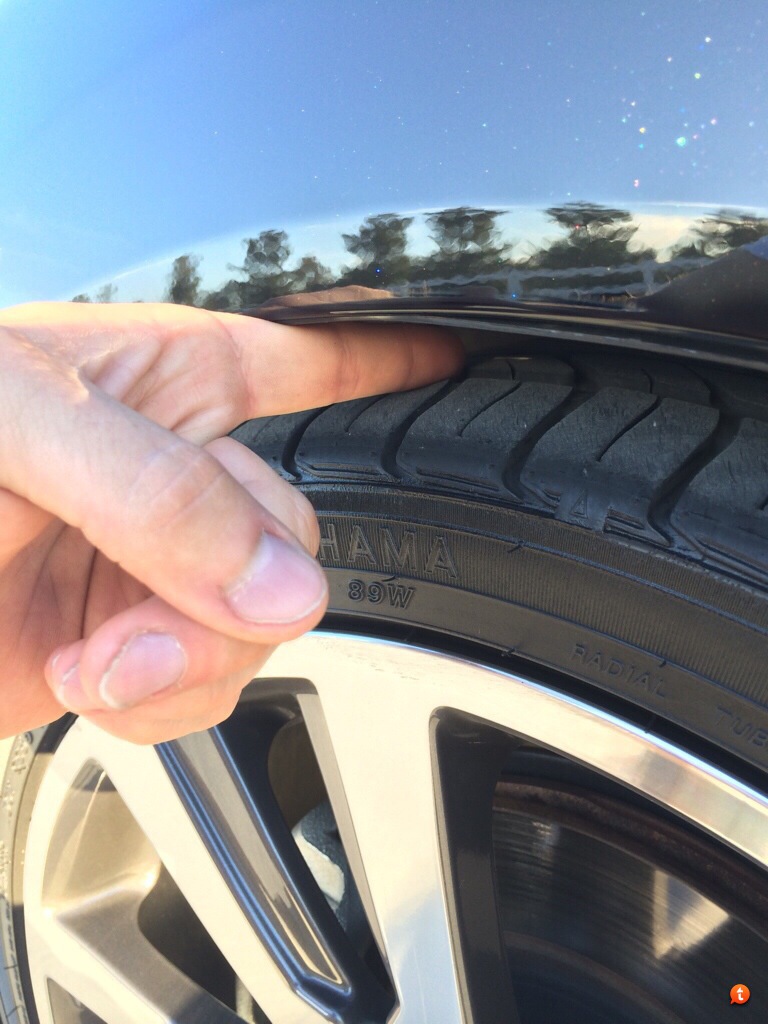

H&Rs installed today. They said I needed the camber arms on the back. Here's a pic. Can someine tell me if I need them? Rear on bottom.

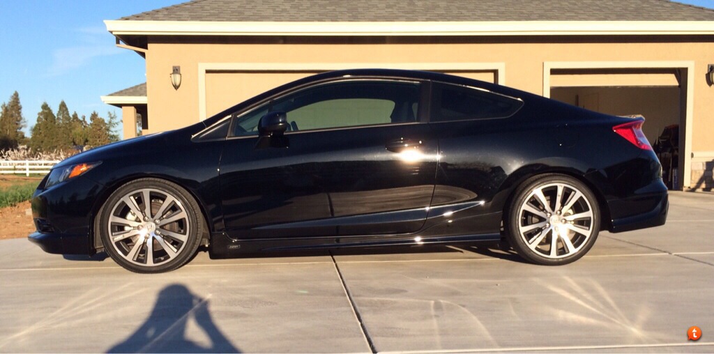

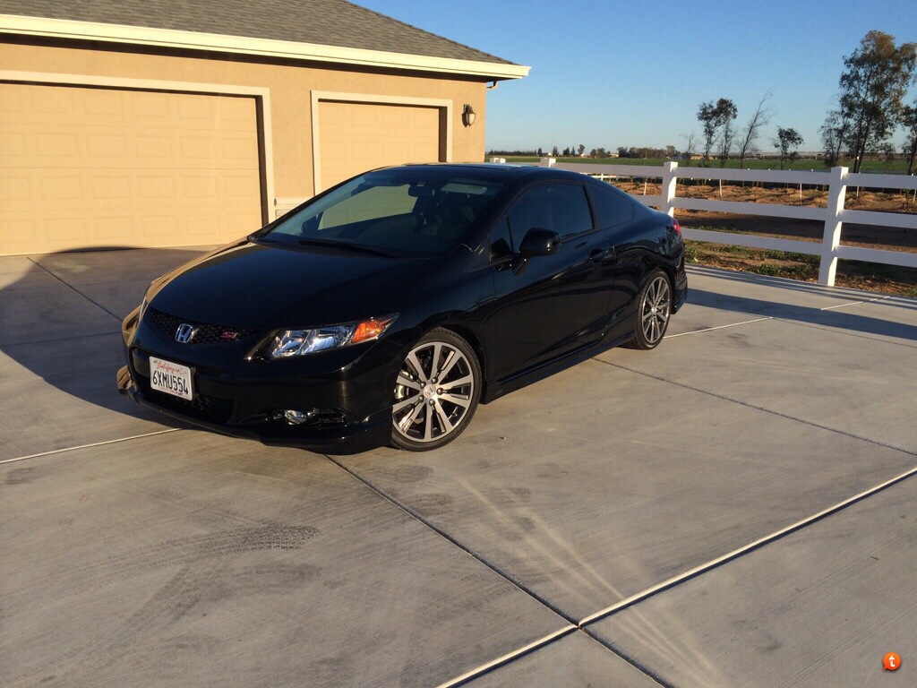

I had similar camber numbers when I first installed my H&R's. They told me the excessive camber in the rear is what also causes that infamous H&R "reverse rake" look when the front looks higher than the rear, as camber affects the appearance of wheel gap. I ended up getting the Ingalls camber sliders for the rear and bolts for the front. Here's how my H&R's look after re-alignment w/ camber kit to factory specs and 3 months to settle.
Front
Rear
Thanks JayGeeisMe for the info. Looks really good. How much did you pay for the set and install?
No problem. And thanks man! I paid $140 for the Ingalls rear camber sliders and $20 for the front camber bolts. Found them both online. Shopping around, I found that most places only differ a few dollars. But be careful as some sell each side separately and some sell as a complete kit. So read carefully. I paid for one hour of labor to have them installed by an alignment shop who has experience with lowered and performance cars.
