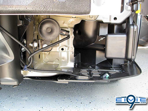

Step 2
Locate your high tone (right above the radiator)
First, unplug the connection to the horn (#1)
Second, unbolt the bracket in #2
There isn't a lot of room for a much bigger horn (without some modification) I personally had to bend that bracket (#3) to get my new horn to fit.
Step 3
Follow the instructions again and undo the same bolt and plug for the low tone horn (pictured below)
This horn is found right in front of the driver side front tire.
There is a lot of room here if you want to replace the low tone with a larger horn.
Make sure both tones work before attaching your bumper again.
That's it! You're finished!

To use these horns on amazon do you have to cut or modify the stock wiring? I need to replace the horns on my Civic and on my 2013 Accord as well as they are both about a weak as can possibly be.
no cutting or splicing, they plug right in
