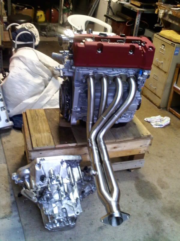

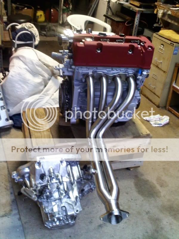

With our engine (k24z7) the "headers" are part of the engine so the down pipe just meets at the back of the engine where typical headers would.will the down pipe mess with the testing? I have heard of a header full exhaust but never really a down pipe.
Normally, NA cars don't have downpipes since the exhaust side of the head will have outlets connected to a header, or headers depending on the engine size. The 2012 Si's K24 engine is an exception with having a downpipe since the engine's head has an integrated header collector on the exhaust side which has only one outlet.
The exhaust side of the K24 head is collected into one outlet. For example:
While the K20Z3 has 4 outlets (one from each cylinder) on the engine head:
