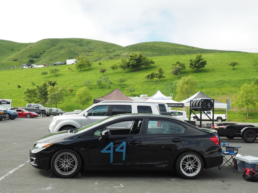

as for tire width, Safe Gabe has run 255’s.
17x9+22 on 255/40-17 tires up front. He also takes his car to the track (clearly)
With the 9j +35, you need to just roll the middle tab of the front fenders. You can run a +45, but you camber needs to be very very conservative because clearance will be an issue on the front struts.
I'm on a +22 with a 255 up front on stock fenders. They're pulled, but they're stock. You can safely run a 9j with a +35.
This is my +35 setup with 255/40/17 up front. It fit, but JUST barely. As I said early — I'd recommend running a square 235 all the way around if it's your daily driver and you're looking for a rotatable setup. Let me know if you have any more questions.
I was toying around with the idea of getting 17x9 +35’s rpf1’s. Same color as the pic above. I’d prolly have to get camber bolts for the fronts but idk. Kinda getting hyped on the hatchy. Prolly gonna finish that this summer.
