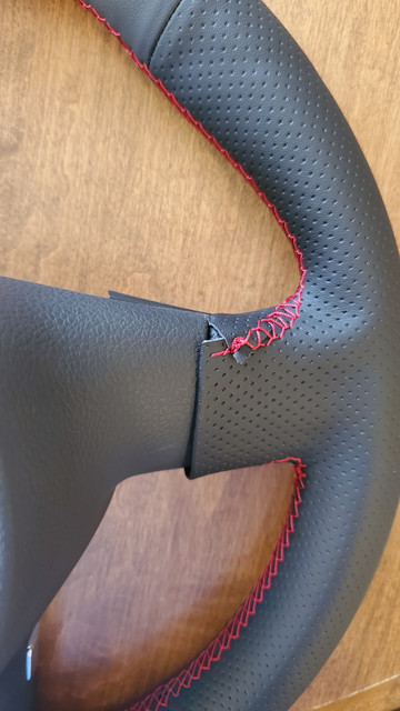

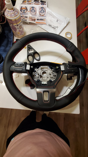

Started on the steering wheel cover. It is as hard as most of the reviews say it is. Time consuming. I messed up a couple times and might have to re do it. Overall the quality seems good. Fits well. Doesn't feel much thicker.

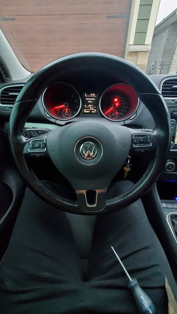

Wish I had some torx bits at home to remove the two controls on the sides. As im writing this i rememberd that I do have torn bits I just bought.

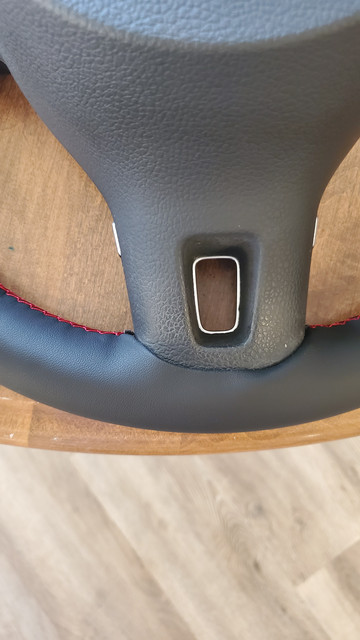

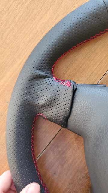

Finished this morning. All of the parts I dont like are all my fault. If you take your time to do this it would turn out 100% I mainly got this to try it out and if I liked it I'd probably purchase one for my civic. They provide enough thread to do it at least 3 times. Enough tape for at least 2 times. Obviously you learn from your mistakes and I could do a much better job the second time. I'll leave it for now. If it bothers me or if the golf doesn't sell soon I may re do it.
The tape they provide is much thinner than you think and cannot be felt through the leather. The instructions provided are translated to English kind of poorly. If I grip it tight and twist I can feel it move slightly so I'm not sure how that will be over time. Next time I'd use more tape, its just tricky because once it sticks its difficult to position it.
I think the reason for the wrinkles on the one side is because of how I sewed it. I started at one of the bottom then did the entire top and finished with the second bottom. Should probably do both bottoms and finish with the top.
