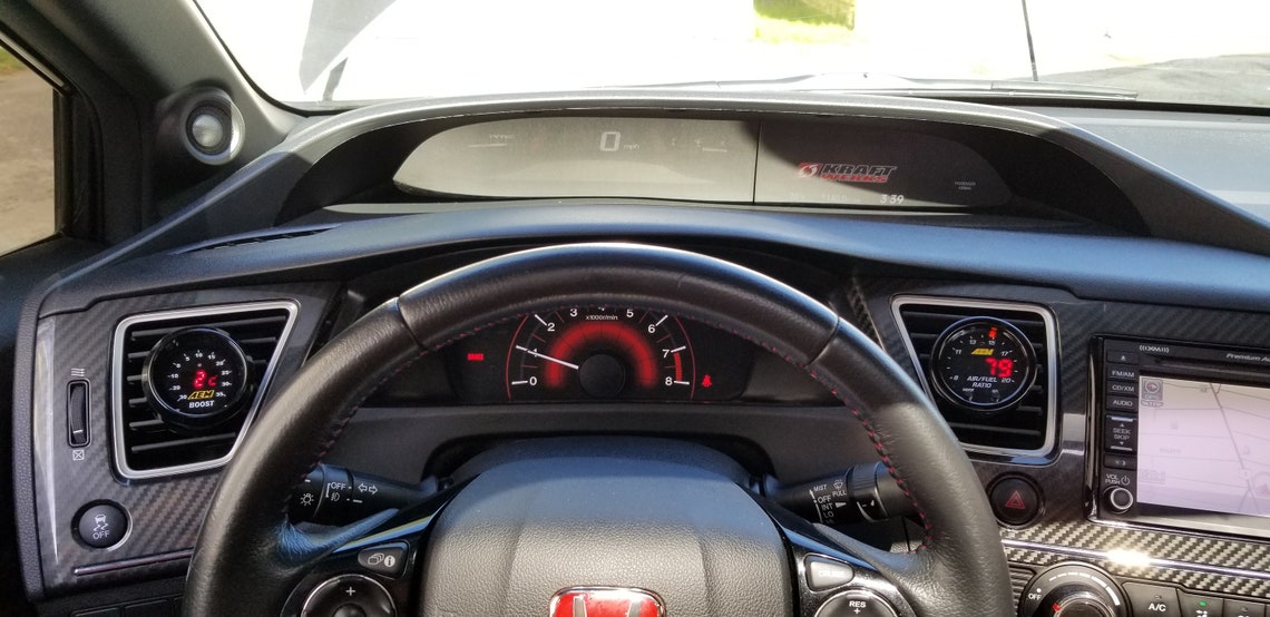

ordered the left side this morning. guy is out of michigan, over the boarder from me so it shouldnt take too long to get. now i just need to get a afr gauge. also looked into wiring the afr into the ecu using the secondary ect sensor wiring so flashpro can read the data. apparently the aem gauge is more acurate and usually read up to .88 difference than the o2 sensor.
Is the wiring running through the vent?
im not sure. i havent really looked into the install yet. i know the whole carbon fiber trim panel pops out, i know a lot people are worried about the heat damaging the gauge. i may make a block off for that vent or something.
I kind of feel bad, just ordered an aem gauge off Amazon to save $60 instead of buying from a parts store.
I'm having what seems like way too much trouble finding info I need. Ect2 is at the bottom of the rad on the driver's side correct? Hondata info says ect2 signal at the pcm is on connector a terminal 44. When I check for continuity from ect2 connector to the pcm connector I have non and the wires are different colors.
Pcm connector a is the first one on the left ? White connector.
So I just checked all the pins on connector a until I found the ect2 green wire with continuity. Turns out it's a34 which hondata states is the eld pin.
