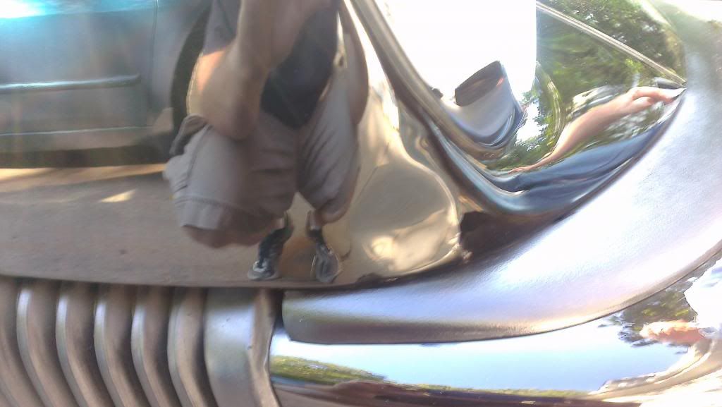

Paint shop claims they didnt dent the car, but their job was to make sure there were no dents before paint, my dad doesnt recall ever denting the car and the restoration shop had a corner out of the way that the car was always sitting in for the past 15 years. In addition to the dent there is a lot of severe orange peel to which the paint shop replied "oh paint shrinks"
after much arguing the paint shop is going to honor their workmanship lifetime warranty and redo the paint, dunno whos taking responsibility for the dent

Where is that dent located? I can't tell from the pic. That's good that the mechanic isn't over charging.
front passenger quarter, right next to the headlight. the car would have almost had to have been in pieces to dent there cause the bumper sticks out a inch or two beyond the metal just beneath the dent, and the bumper has been on since paint was done

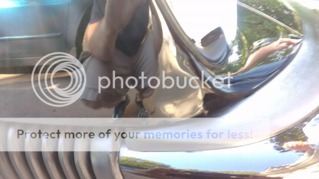

I see it now. I can also see the dent on the 2nd pic from the original post. When was that pic taken? Same day you got it from the shop?
yea, once we got it home we noticed a few things, took it back the next day to say we found these and just wanted to let you know that we didnt do it
