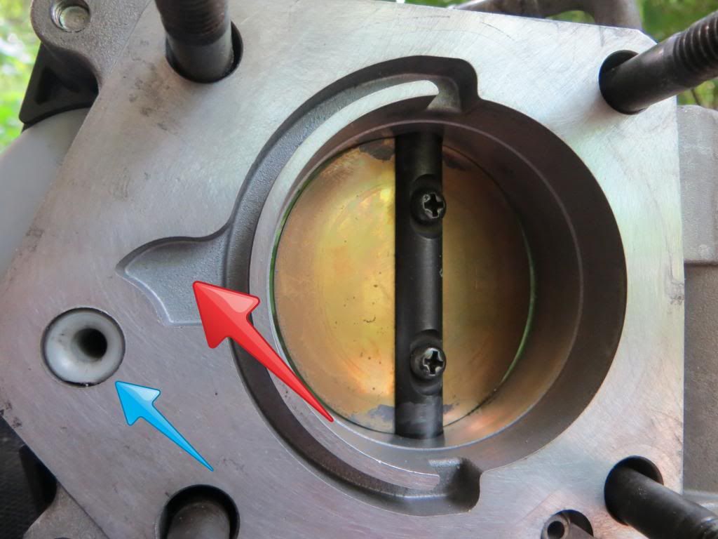

An update for any interested parties.
I did the modification to the P2R throttle body spacer as pointed out by webby a few weeks ago. Since then I have had no recurring "tighten gas cap" messages and when reading emissions codes everything clears out. It almost would seem as tho the system was resetting at every start and that's why the message came up intermittently. It only came up when the ready monitor would set. I'm still assuming the reset was due to the code but I can't find out how to verify that. All I know is I modified the gasket and everything is working fine now.

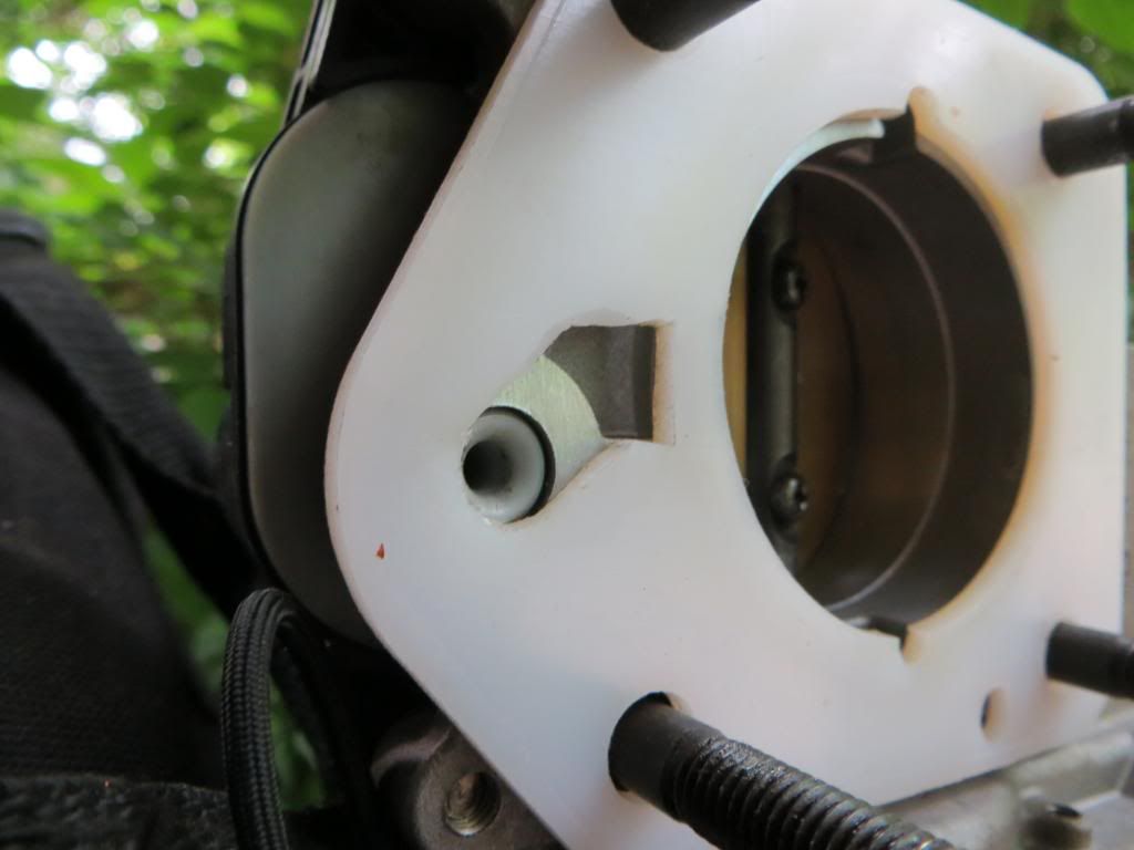

@Twitch , @Pauly99to17 Are you guys still having issues with the p2r spacer and the gas cap message? I don't know if its what webby linked already but I just put one on recently and cut a hole in the gasket. No issues.
Cut like so:

I never had an issue. I notched mine as soon as I got it. There was a thread talking about how to do it. I remember posting pictures in it.
