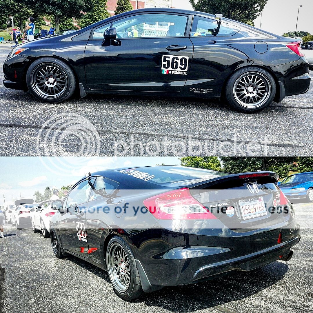

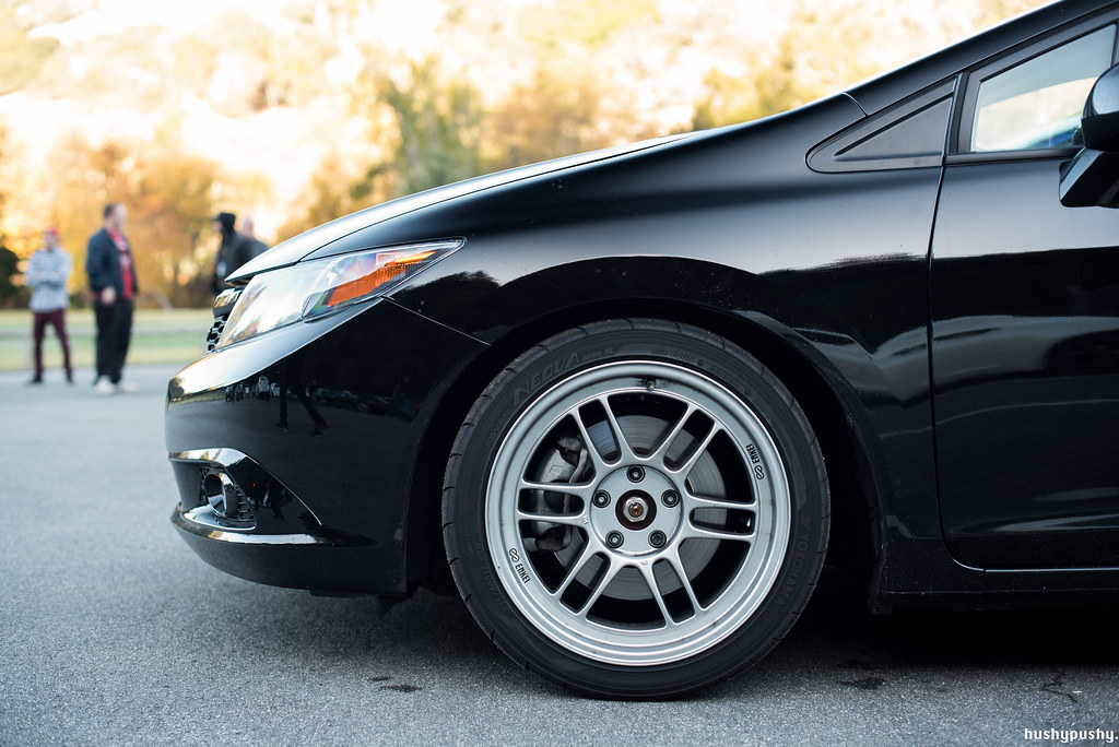

HR springs , fenders rolled and pulled, no spacers, -0.5* camber front -4* rear, ill try to make it -2* at one point to avoid excessive camber wesr and more function.

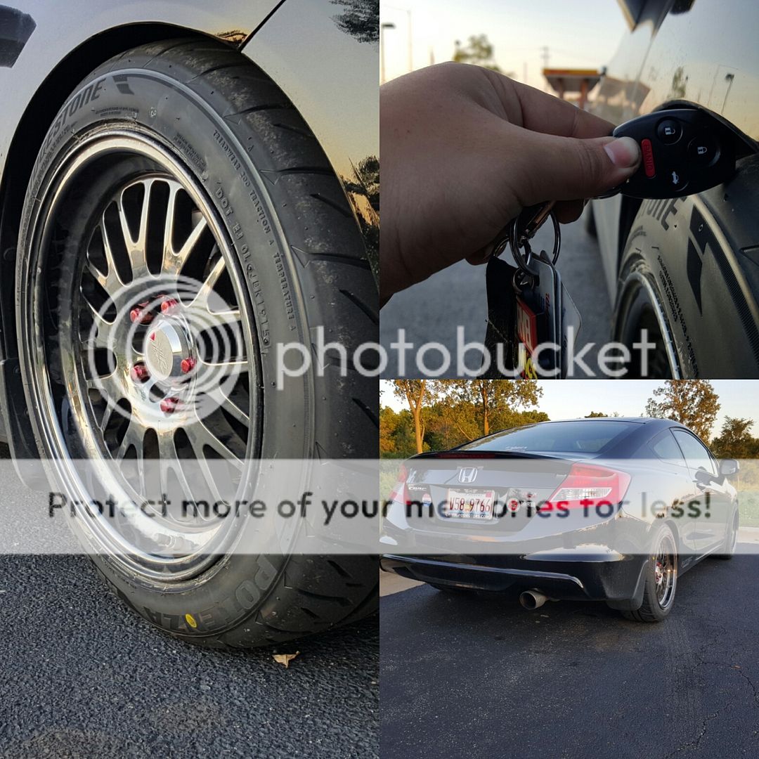

17x9 +35 xxr wheels Bridgestone Potenza RE71R 235/45/17

The grip is amazing, it's so sticky that i feel one of my rear wheels almost.going airborne. I drove them through a tornado storm, extremely heavy rain and lakes of water at 80 mph no problem, i can take clover loop exits off the highway at 55 mph tores dont even squeal. They're beautiful, i don't know how to give you a good answer regarding overheating as i only auto cross and my runs are just a minute or ao, but they do not loose grip.
I rolled and pulled my fenders more....but i found out where im rubbing, that screw that connects your resr bumper to the fender, im thinking of using a dremel and cutting that off.

Lowered on hr springs, 17x9 +35, 235/45/17 , fenders rolled and pulled, i still get lots of rubbing, any help?
Current set up on camber is -0.3* front, -4* rear, front barely clears struts, i will try to gt as close to -1* front, and -2* rear on froday.

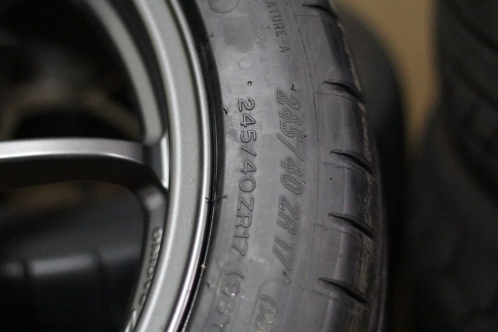

The problem is as follows:
Stock tire diameter: 24.7"
Your tire diameter: 25.4"
235/45/17 is a bad size for these cars. If you don't know about aspect ratios being a percentage of the tire width then I would suggest reading up about it.
245/40/17 has a diameter of 24.7" - you may find these will actually fit your car better, albeit technically "wider"
235/40 is more conservative and has better gearing anyway.

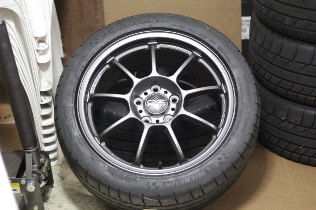

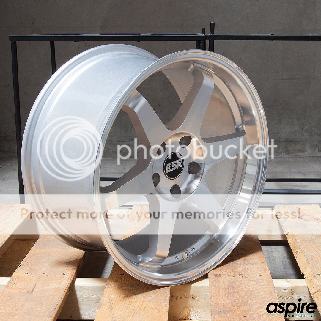

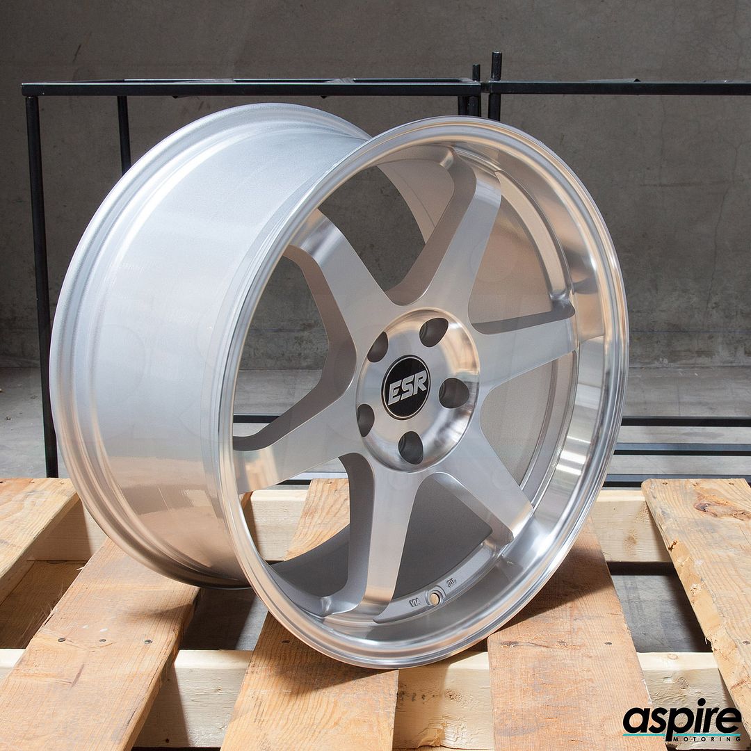

I made a thread about these, they are 17X8.5 offset 30. I can't find a but one person on the web that has these and the guy is not on any forum from what I can tell. I like the meaty look but I do not want to do a ton of modding to get these to work and def do not want to run a super skinny tire.
I think these would be hot with a set of pro-kit springs on my modern steel metallic Si.
