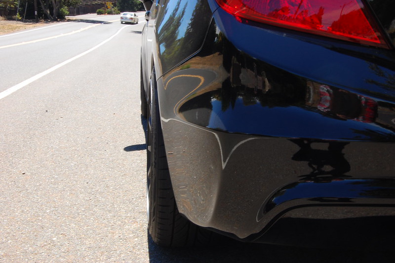

I am currently sitting on Eibach ProKit which is slightly higher than H&R. My wheels are 17x9 35mm offset and tires 225/45. I only rub at the front during hard cornering, I can hear the tire hitting that inner fender well.
20150413_074723_hdr-jpg.46529
Looks really good!
I thought there would be more stretch with a 225/45 (seeing as i have 215/45)
Any close ups of the tire on the wheel?
