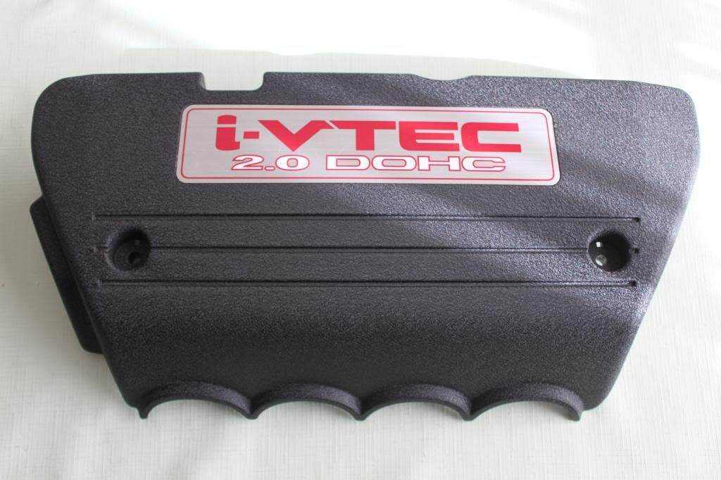

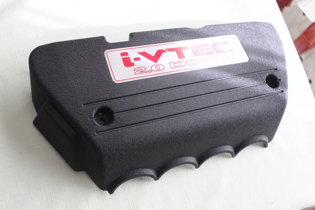

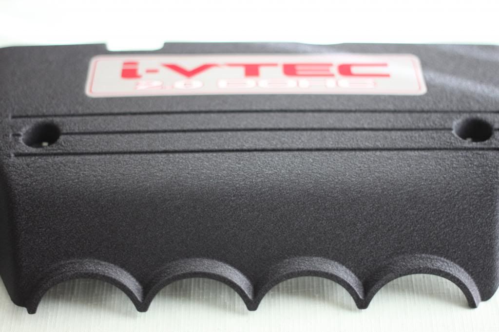

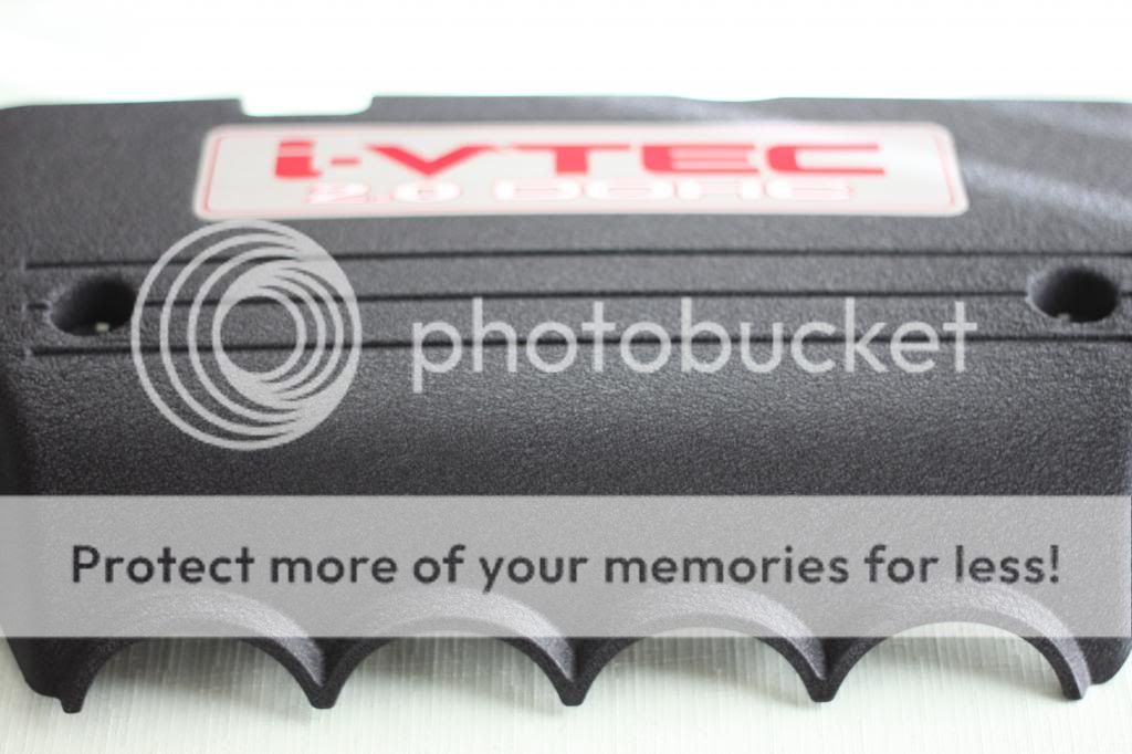

What did you use to if this? Can I get it in red? Please !!!! Looks incredible !
It's VHT Wrinkle Plus. The only available colors are red and black. The best working temp for this paint is between 75-90 degrees make sure you spray it outside and not in the shade. What I did was spray it with a very light coat first, so that the paint will stick on the part at the second coat. Wait for 10-15min. 2nd coat will be very heavy, but not too heavy that would cause runs. Wait 5-10min for another coat if needed. Let it dry outside under the sun, not when it is very cloudy or windy. The sun will do most of the work that gives the wrinkle look. When the part is dry enough (probably 2-3 hours), bake it in an oven for 20 minutes at 200 degree F.What did you use to if this? Can I get it in red? Please !!!! Looks incredible !
Yeah. Pretty much. Lol.So in other words I should do this when the better half is not home( I don't think she would like me baking car parts in her brand new expensive as hell oven) thanks for the info I'm getting it this weekend!
