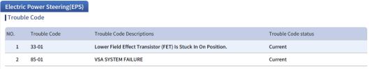

Not sure who remembers this fiasco from a few months ago regarding the random loss of Power Steering I had. Weird thing is, I have not had any reoccurrences since this event. Other than replacing the tires and doing maintenance, no changes have been made to the car either (same battery as before, during, and after the event).
Not really sure where to put this question; so, I figured a post about random stuff would be the best place.
Anyhow, driving my Civic into work this morning; stopped for gas on the way, maybe about 10mins from my house along my 50min commute. When I started the car back up, I had no power steering (warning on the dash and all). Popped the hood, looked for obvious signs of failure like loss of the drive belt or low fluid level (thinking the car had a hydraulic system), not finding these (or perhaps I missed them) I surmised that the power steering system is probably electric. So, what do you do with electrical components that randomly fail? You turn them off and then back on and check again. So, after restarting the car, same problem, no power steering. I finished my commute to work and jump on here with the few minutes I had to spare. This was my first issue having any problems with the power steering system. Unfortunately, I'm a little pressed for time this week and next so I did a quick look here on the forums and the only thing folks mentioned were battery issues (at my quick 5min look).
So, I'm curious, has anyone else encountered a random loss of power steering? And, if so, what is the proper fix, just replace the car's battery?
Well, I ran codes a few months ago, cleared them, and rescanned. These are persistent codes (current faults); I just checked them again, they're still current.
Just curious if anyone else has run into this before with their car and what was done to fix it (I did search a bit but not much came up, mostly battery issues which we discussed back in April).
Not sure if this is helpful, but I saw this from a s2000 Honda -
View: https://www.reddit.com/r/S2000/comments/le1191/solved_no_power_steering_low_fetmotor_drive/
Also this diagnostic test
http://arlequinlover.free.fr/Manuel Honda Civic/A00/HTML/00/SMG6E00K722000R3301FAAT00.HTML
Interesting. This is looking more and more like a 'don't funk with it until it's a problem' type of thing. Lots of stuff to tear down to clear a DTC that isn't showing a light on the dash nor malfunctioning.
