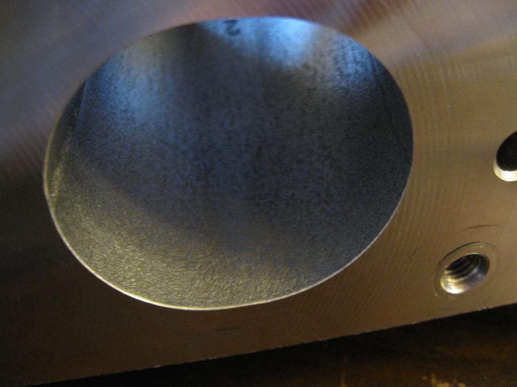

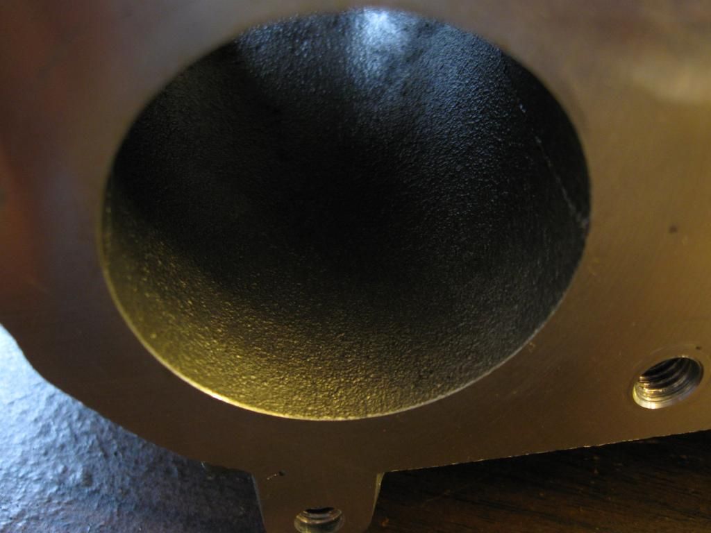

Yes P2R just refinishes OEM parts, it's a sand cast part, so it's rather rough inside. The plastic upper itself is actually quite smooth inside, however there is some molding flash inside that can also benefit from trimming with an exacto knife.
This is stock vs DIY sanded;
You need to sand all casting marks off to have benefit, make sure the sanding is uniform and don't use higher than 80 grit. You're fine :D
The guy i asked has done it for 8 years. 80 grit, uniform finish, remove all casting.
removing all casting removes less than 1 mm all the way around, and you're not changing the shape of the runners. Just trust me and do it like that my man, i promise it's good!
You're arguing with my positive results on my own car lol :D

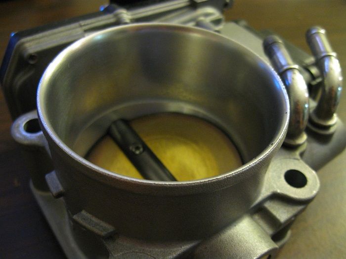

I also matched the throttle body inlet to my intake. Everyone has heard of porting intake manifold, but I never see anyone talk about the 2-3 mm exposed lip of the throttle body sitting in an aftermarket intake coupler.
So I have ported runners, matched throttle body, HPS silicon intake tube, K&N drop in, with stock filter box. Everything together adds a lot of power everywhere in the rev range. If you DIY as much as possible, you get a lot of mods and power for very low cost. It works great but still looks stock even under the hood.
My car had the common rattling VTC actuator that the dealer replaced under warranty last month and they did not realize all the stuff I had done, the silicon tube alone isn't enough to cause concern. So as a bonus, this setup keeps the factory warranty.
http://www.driveaccord.net/forums/showthread.php?t=195362
No I just did it myself, first with a file, then emery cloth, then metal polish. Clean with a cloth and rubbing alcohol when you get the size and shape you want. I only enlarged the inlet side to match the intake coupler, so it was pretty easy. I did not do anything to the outlet nor throttle plate. Just remember to use masking tape to seal off the throttle plate while sanding to keep out abrasives. Everything works great, idle is smooth and no error codes. My goal was to smooth and enlarge everything along the intake tract.
