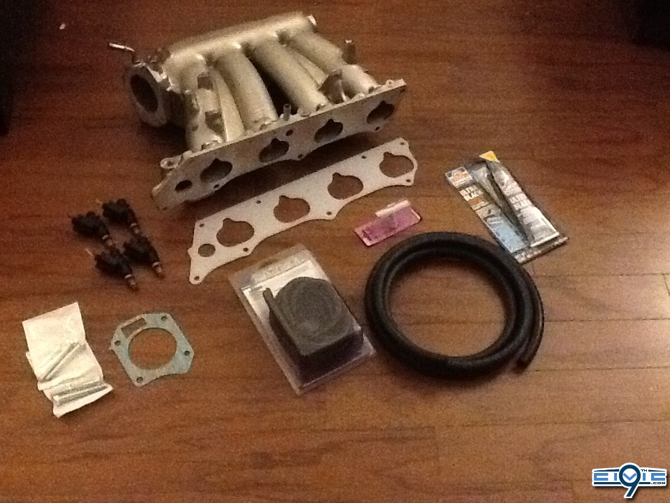

Part List:
RBC Manifold (06-11)
Honda RBC Intake Manifold - Ascension Motorsports
K24 Thermal Manifold Gasket
CorSport: Honda - 2012+ Honda Civic Si - P161
8th Gen Throttle Body Gasket (Thermal)
CorSport: Honda - 2006-2011 Honda Civic Si - P106
8th Gen 310cc Injectors (RSX-S works as well)
8-10ft Vacuum Hose (3/8)
Vacuum “T” Connector (3/8)
Wire Cover/Electrical Tape
Plug Bolt (15mm) or (rethread hole)
4 Shorter Bolts (M8-1.25 X 50mm or with TB Spacer M8-1.25 X 75mm)
Thread Tape/Thread Locker
RTV
Coolant

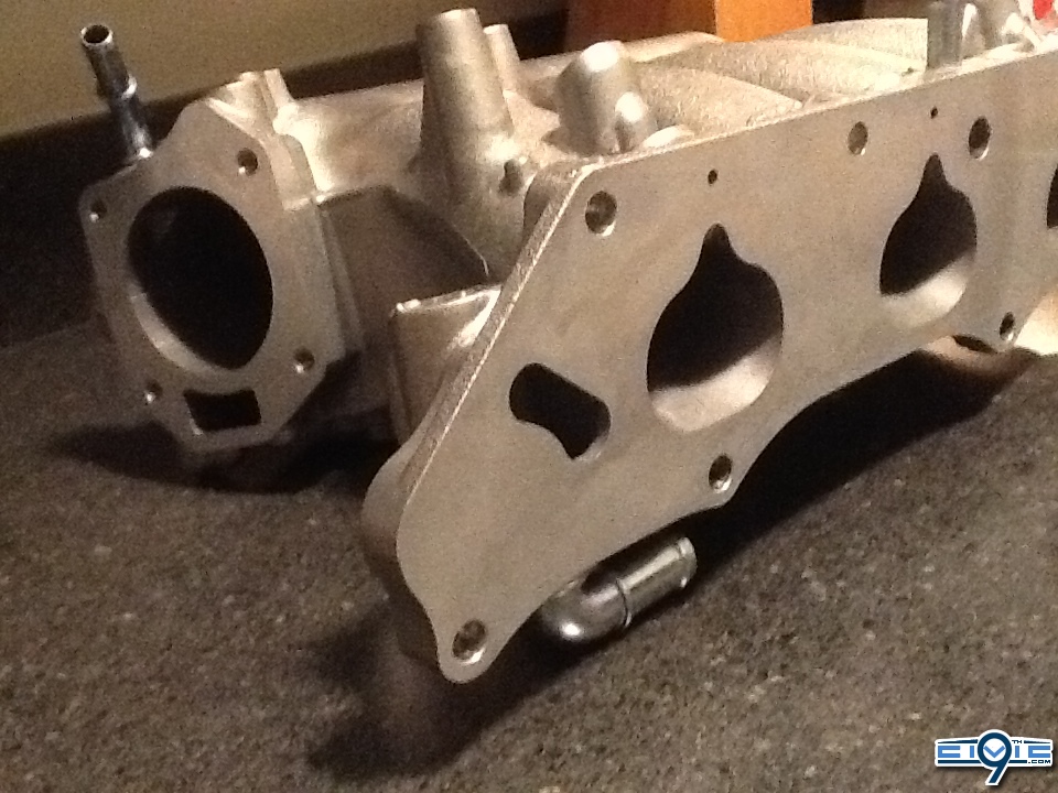

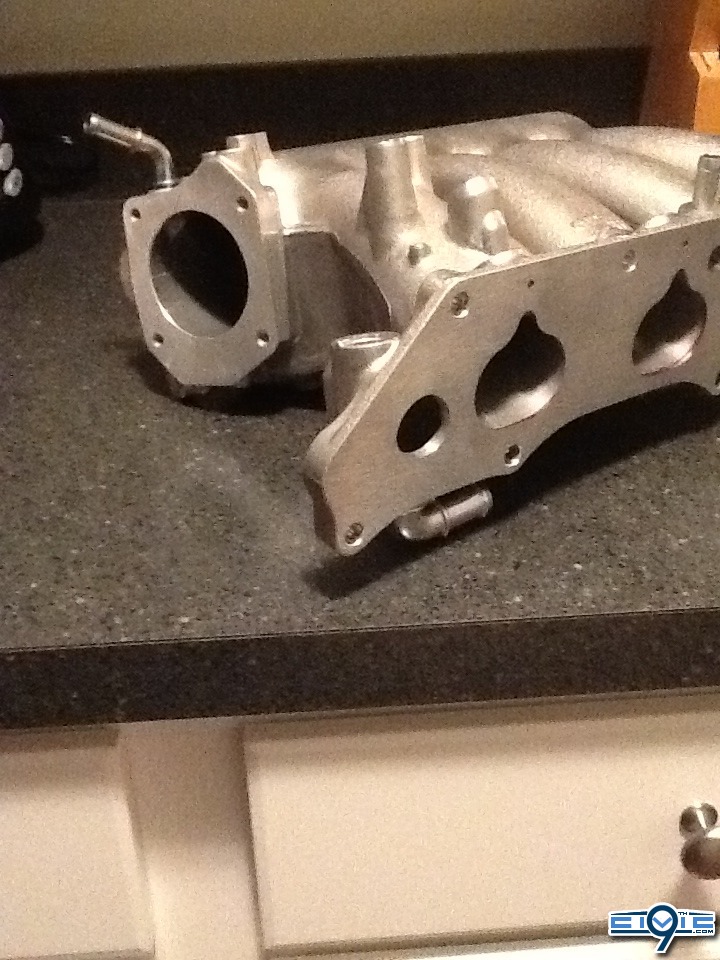

Intake Manifold:
The famous “Peanut” shaped coolant hole on the face of the manifold needs to be matched with the circle hole on the intake manifold gasket. The best way is to just take the gasket & manifold to a machine shop and have them match them both. If you keep the coolant hole "Peanut" shaped it'll leak coolant.

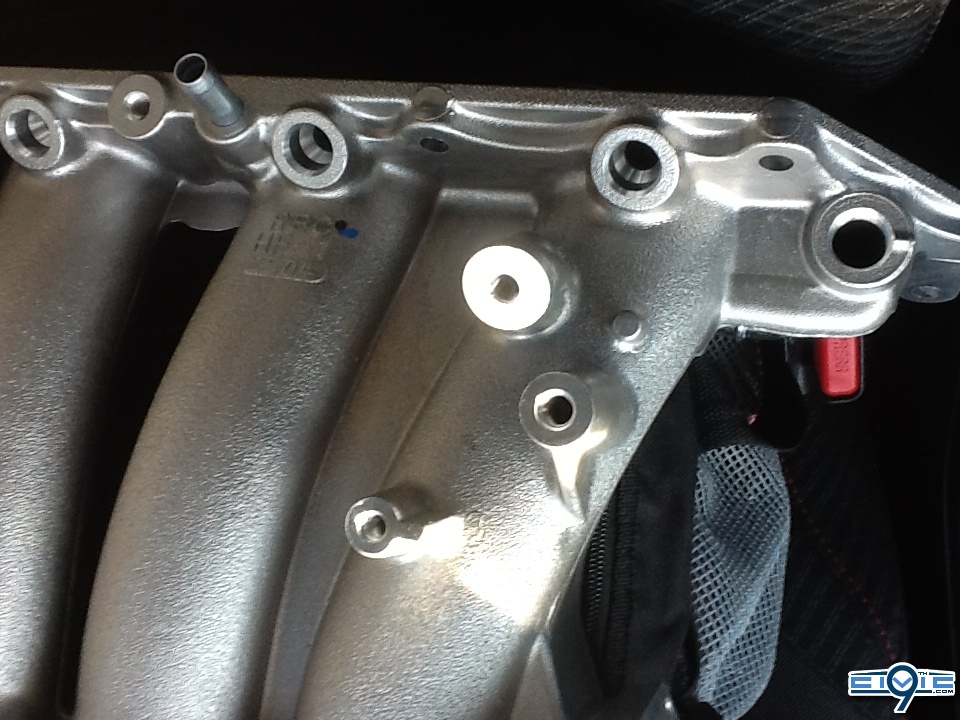

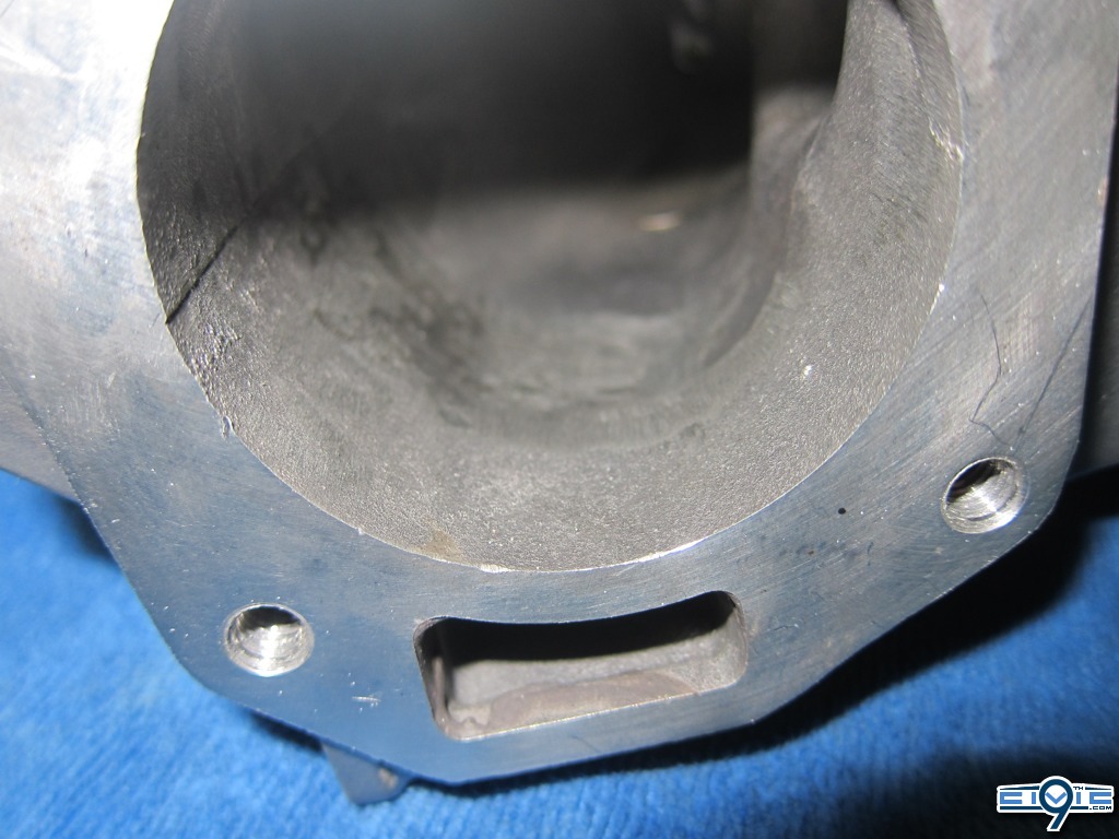

On the throttle body side there is a “ivac” hole that our TB doesn’t use. Some people have just closed it off on the manifold TB face side… But recently it’s been proven to flow much better if you close this hole off INSIDE the manifold… there is a small hole a couple inches inside the opening. I would also have the machine shop do this while it’s there. Most of them charge by hour so why not?
There is another port on top right of the manifold… Its circular, it needs to be plugged. The easiest way to plug it is to re thread the hole and just put a matching bolt in. I also used thread tape to wrap around the bolt before I put it in. another route you could go is having it welded up as well. It's your choice.
Between injectors 2 & 3 there is a port sticking up. This port is useless because our motor doesn’t use it. Just leave it there untouched. When the manifold its mounted the other end leads to nothing but gasket/motor.

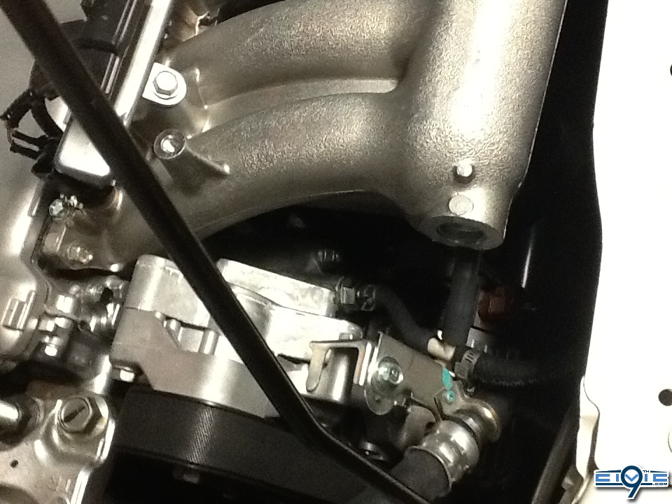

On the left side of the manifold there is a vacuum port you’ll need to “T”. I'll explain how to later when putting this on. You'll use your "vacuum "T" along with your vacuum hose you purchased.
Most people will want to go ahead and have the manifold bored/ported while it’s off for later updating the TB. You can order a modified/unmodified from Ascension Motorsports - Ascension Motorsports
Plug hole on the right:
Stock:
Modified:
Modified on the inside:

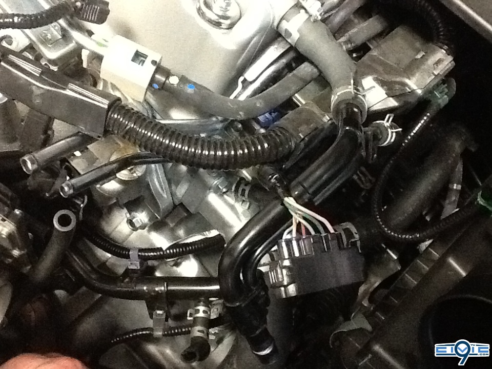

Next take your throttle body off. There are two hoses on the bottom of it so be careful. I took them off first after clamping them with vice grips.Then there will be 4 bolts attaching the throttle body to the stock manifold. You’ll need to take these out and then your TB/Gasket/Spacer will come off.
Step 3
Now take your fuel rail off. This should be two bolts right on top of manifold. Make sure you unbolt the two ground wires that are attached to the rail as well. I didn’t disconnect my entire fuel rail, I just layed it to the side after unbolting it. Then remove each injector from each slot/clip. I cut the wire about an inch after the clip at this point but I didnt splice or solder the 8th Gen injectors just yet.
Step 4

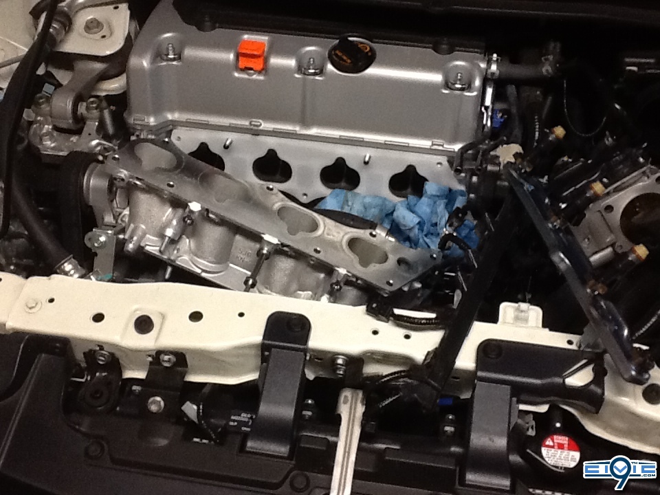

The next thing to come off is the plastic part of the manifold. It will have two hoses connected to it as well as the electric wires on the right of it. Just unbolt the piece that holds down the wires and put it to the side. Undo the two hoses. One runs to the very front the other runs on the right of the manifold. When you pull the plastic piece of the manifold off now all you have left is a coolant hose and the aluminum runner piece. This is where your going to lose coolant. I undid the hose on the bottom right of the runners first. Draining that helped a little. Then there should be 8 bolts holding the runners on. Once you have them all undone pull the runners off and watch the coolant drain lol.
Note: Now that you have everything taken off its time to put everything back together including splicing/soldering the injector wires…
Step 5
At this point I put my thermal manifold gasket on the head with tracing the outline of the gasket with some RTV (Both sides). Make sure you connect the coolant hose to the bottom of the RBC before putting it back on. If you wait it’ll be pretty hard to get to and put back on. Next I traced the outline of the manifold itself with RTV and put it on as well. Next I put the 8 bolts back on to hold the manifold up to let the RTV settle.

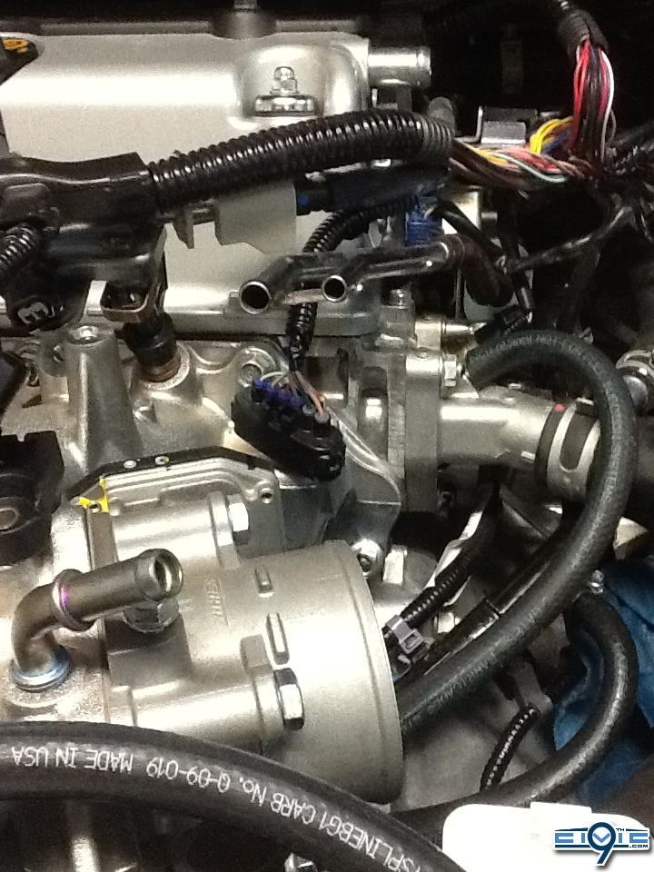

Now you can bolt the throttle body back to the manifold. Don’t forget to put your gasket and/or spacer back on at this time as well. You’ll use the new bolts you bought if you don’t have a spacer! If you do have the spacer you can use your stock bolts! When its on there will be two coolant ports on the bottom of it. There is a bottom and top coolant port. I ran the bottom port to the silver housing coolant port on the block. I ran the top port to the black metal housing pipe. Refer to the pictures below. Also, connect the electrical pin connector to the TB at this point.

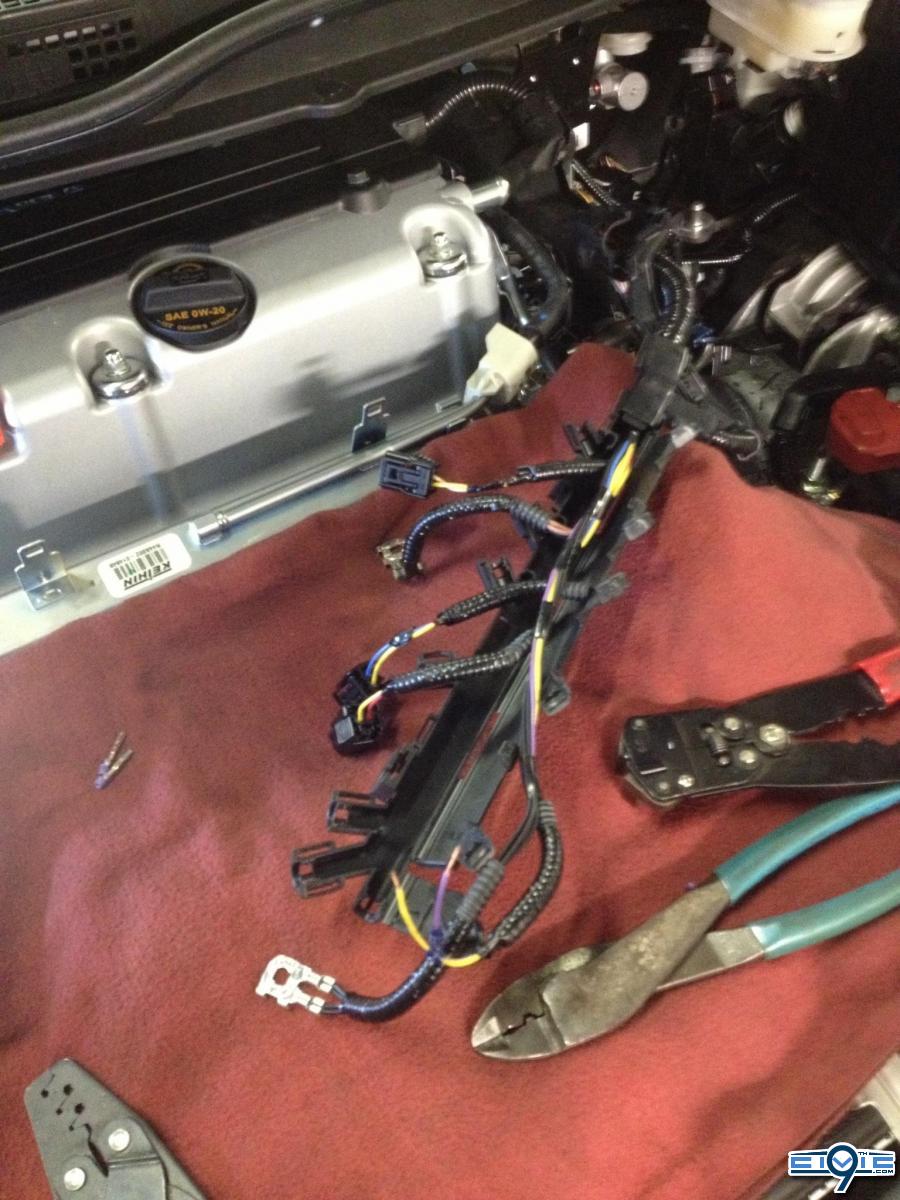

While the RTV settled/dried I spliced/soldered the injectors. I cut the stock clips about an inch left of wire. So if I ever wanted to return back to stock I could undo it and splice my 9th Gen ones back on. But anyways after splicing them, you’ll see there are two wires for one injector. Stock yellow wire goes to 8th gen colored wire….Stock colored wire goes to 8th gen striped one. The easiest way to remember is the stock yellow wires do NOT go to the 8th gen yellow wires!
Note: you might have to pull the black hard plastic wire covers off to extend the wires to make them reach the TB/Fuel rail etc. Some people had enough slack some didn’t.

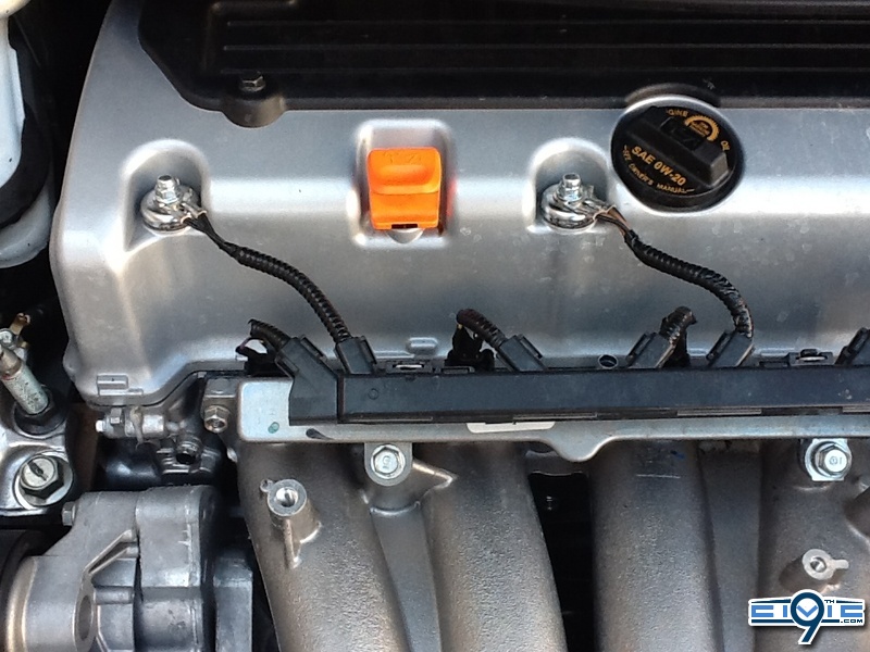

When putting the whole injector assembly back together along with the ground wires make sure the ground wires are grounded somewhere other than the manifold itself. The thermal gasket used isolates it from the proper ground it needs to perform. I put mine on the bolts that hold the valve cover on... Picture is below.
"The ground wires MUST be moved to the head (either under a cam tower nut or to the head directly by one of the cam sensors) or you WILL have voltage drop issues" - VitViper
grounded pic -

At this point in the swap you should have the manifold mounted, the left side “T”/ran, the throttle body mounted, the TB coolant hoses ran! You’re almost finished!

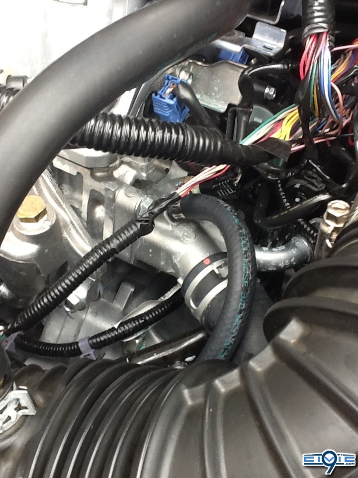

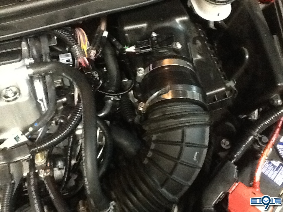

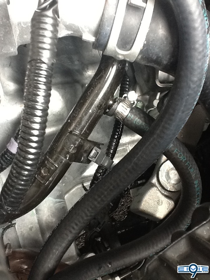

Last thing that should be done is putting intake back on. Now how/what you do from here will probably be different from what I did. I’ll explain what I did though. I used the stock intake and air box. Since the RBC sits the TB further than the stock manifold that means your going to have to cover more space with piping to connect the intake. Connect MAF wire back!
I bought 2 pieces from auto zone. I put one ne TB coming out then I connected it to the stock intake hose. I ran ¼ inch hose from valve cover to the hole in stock intake hose. Then the other piece I bought I ran from the end of the stock intake pipe to the air box itself. Clamped it then was finished!

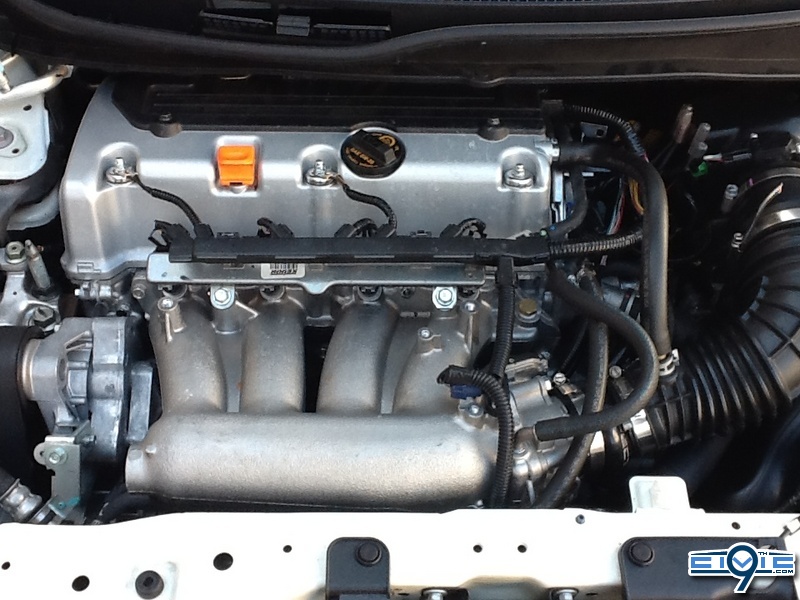

Finished Product!
I just wanted to say thanks for your time & reading! I hope this helps… If you have any questions don’t be afraid to ask the few that have already done it don’t mind helping at all! That’s what we are here for. They’ve helped me out a lot. I wasn’t the first to do it, hopefully not the last either! One last thing RBC …….. FTW!
For any of you who did this mod, did you leave it the RBC and injectors in view or use an engine cover like this? And which cover would you use, the 8th gen version?
