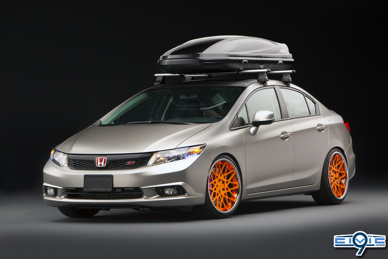

19x8.5" Rotiform BLQ Concave wheels orange candy centers RotiForm Wheels
19x9.5" Rotiform BLQ Concave wheels purple candy centers RotiForm Wheels

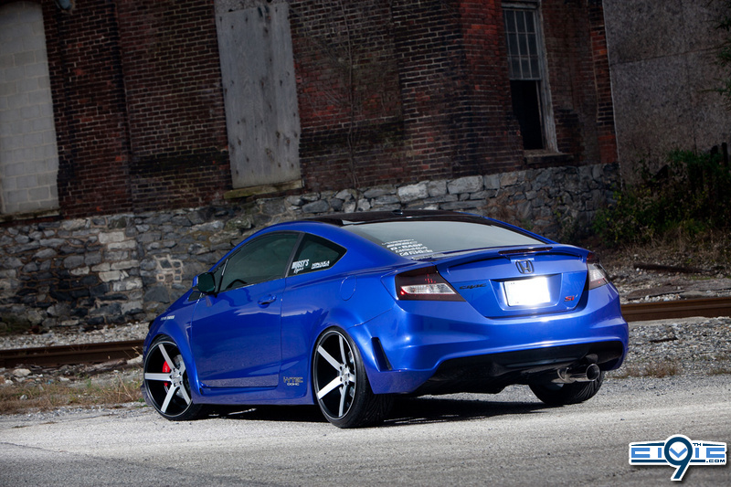

20x10.5 Vossen CV3
as others have said above, it's going to look very 4x4 truck-ish with 19's and the stock suspension.
Ok. Any springs available that would give a drop like the hfp cuz that's not that low to me. And the last pic u posted webby those r the wheels I'm looking for! Concave five spoke with silver n black. Hot!
Hey Freddiii, some things they aren't mentioning that you may not be aware of.....
To get super flush fitment like that you are probably going to have to modify your fenders. Roll the fronts and either roll or cut/trim the rears. Also you may run into rubbing and hitting the wheel on the fender itself.
With really wide wheels like 9"+ you will have to run a thin narrow tire to fit. Most likely with a bit of a stretch. And you will need camber kits to get enough negative angle to fit the wheels under the arches.
If you are only going with a moderate drop like the eibachs it's very possible you won't run into any rub/fender issues but something to be aware of.
