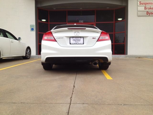

ok here are some pics...I think it looks really good and rides pretty smooth but I'm getting a noise in the rear when I hit bumps, even small bumps. I wasn't able to wait with it while they were being installed but he called me after he finished the front and was starting on the rear to tell me that the top of the road magnet rear spring had a bigger diameter than stock so it wasn't fitting flush onto the isolator or whatever it's called. I told him to go ahead and install them and he told me it would probably make noise on bumps which it does, I assume from the spring or the isolator moving.
Can anyone tell me if the 8th gen rear springs have a bigger inner diameter up top than 9th gen? If that's the case and all I have to is swap the top isolator than that's a simple fix. If not I'll have to swap them back to stock until I get it figured out cuz the noise will drive me crazy.
Also why aren't the sedans that used road magnets having the same issue? aren't they the same size springs as the coupe?
Nevermind, re-reading redshifts thread answered my question. Seems like an 8th gen rear upper insulator will solve the problem though it's still really weird that there's even a problem, I thought they were made for a 2012 Si...
