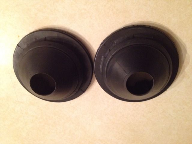

I installed the Road Magnets and love the lower look. I also noticed the rear top spring isolator was smaller than the top of the Road Magnet spring. I installed them correctly (flattened end with the tighter coiling up). I have been hearing noises when going over bumps as well. Where did you get the 8th gen isolators?

Winn420 got the part # for us 52691-sna-a01, I got mine from the dealer. They are cheaper online.
I got them from hondapartsdirect...(part# 52691-SNA-A01)...thanks for chiming in on the problems you're having too. I'll know by tomorrow if the insulators solve the problem, if you want to wait a day before ordering a pair.

I got em trimmed and ready, I'll swing by the shop on my way home from work tomorrow. I just realized if they don't fit the springs then that's even worse, then we're stuck with springs that simply don't fit with no fix.

I will take some pics today when I bring it by the shop to attempt installing the 8th gen insulators.
Alaina, I hope you can understand my frustration, and scepticism. When I not only didn't see a comparison pic as promised, but the springs were then removed from being sold on your website, it doesn't give the greatest feeling of comfort that road magnet would do anything to assist with the problem. Like I've said from the start, I can't imagine a company would absolutely lie to customers and sell them a previous gen product and claim it to be a latest gen product, which is why I still would be shocked if the 8th gen insulators fit my 9th gen springs. I would hope it's more likely a design flaw but if that's the case it leaves me in an even tougher spot. I would have the choice of leaving them on and hearing the noise on a daily basis (which is not an option for me regardless of whether its causign any damage), or returning the springs and ordering an 8th gen set of springs to use with my newly purchased 8th gen insulators. Either way it's going to cost me money. The only way it won't cost me money (other than the $40 I paid for the insulators) is if the 8th gen insulators fit my 9th gen springs and thats just because the shop will throw them on free of charge, if they fit. If I end up having to swap the entire set of springs that's another $200 in labor.

@Winnn420- I completely understand where you are coming from. We are not trying to falsely portray any products not specifically designed for the 2012 Civics. Like I said before, I have talked to my contact at Honda, and have ordered both isolators. This will help me determine of the 8th gen isolators will solve the problem, and the 9th gen isolators will help me get exact measurements for our next run of springs.
